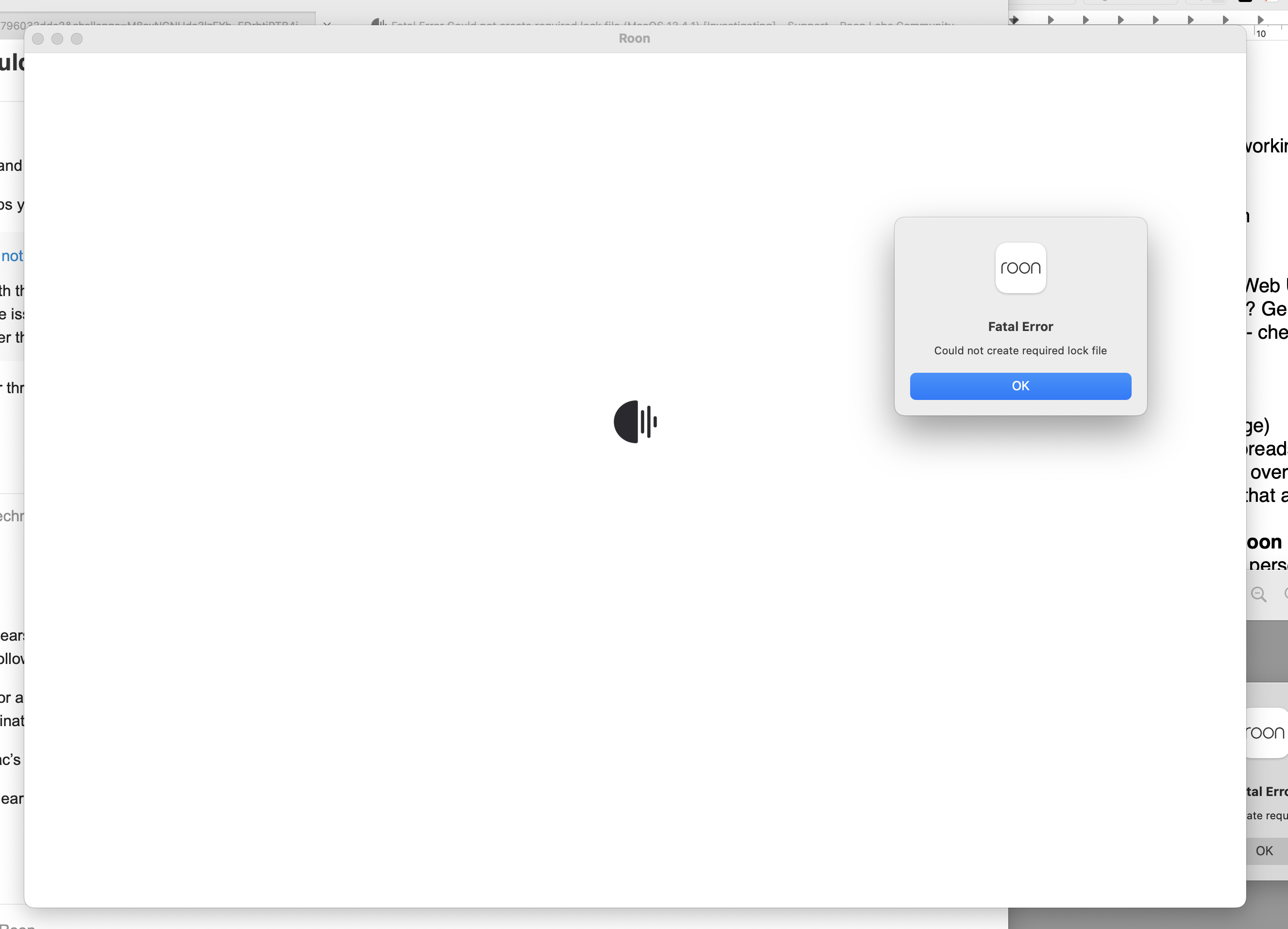

· Roon server does not load. Eternal spinning icon. Received 'Fatal error' message: "Could not create required lock file"
And later: "Uh oh, something not right. Make sure…"

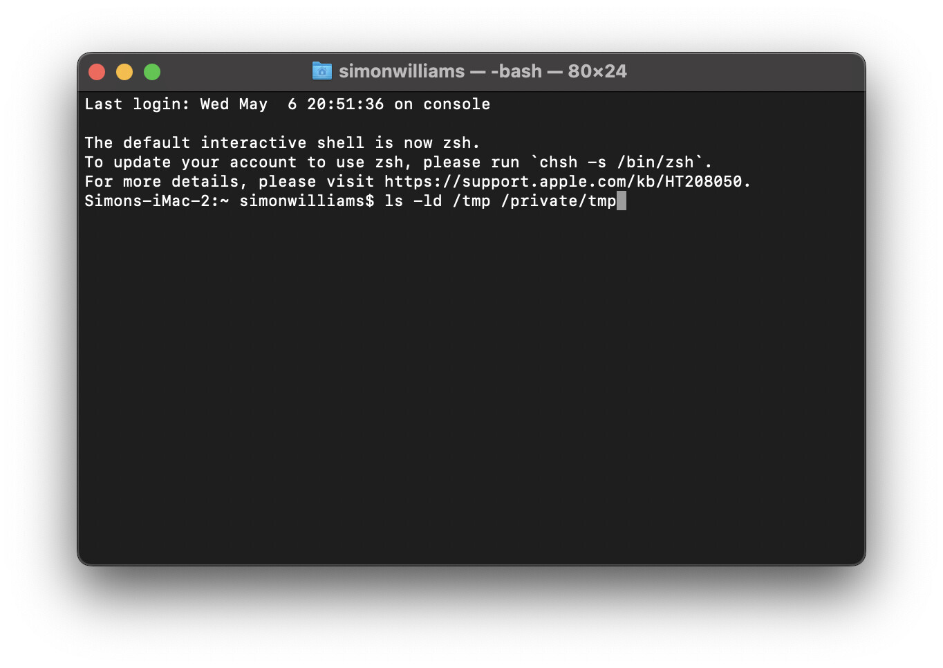

  • Run ls -ld /tmp /private/tmp in Terminal and share the exact output — this will confirm whether the permissions fix actually took.

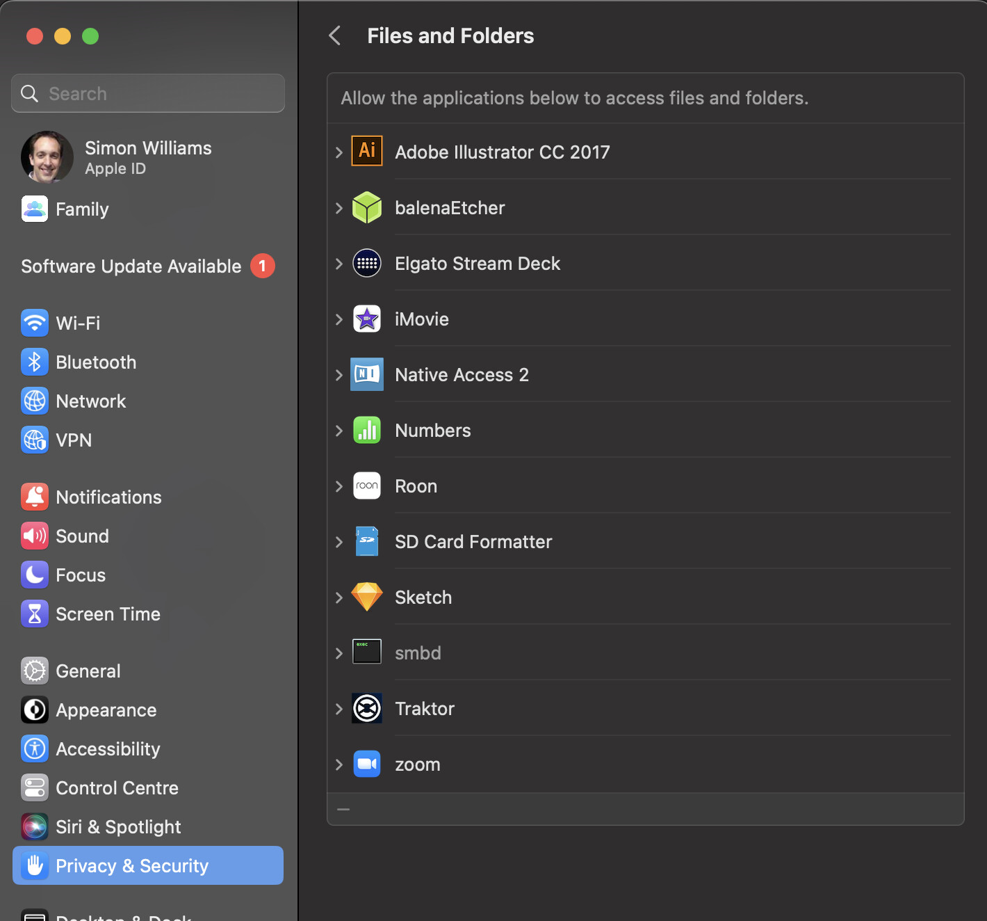

  • The missing folder access prompt is suspicious, can you manually check Privacy & Security → Files and Folders to see if Roon has been blocked?

Hi - Here is the Terminal output:
• ”drwxrwxrwt 11 root wheel 352 9 May 12:42 /private/tmp
lrwxr-xr-x@ 1 root wheel 11 16 Aug 2025 /tmp → private/tmp
Simons-iMac-2:~ simonwilliams$ “

• Roon has access to ‘files and folders’ according to the System settings - attached.
