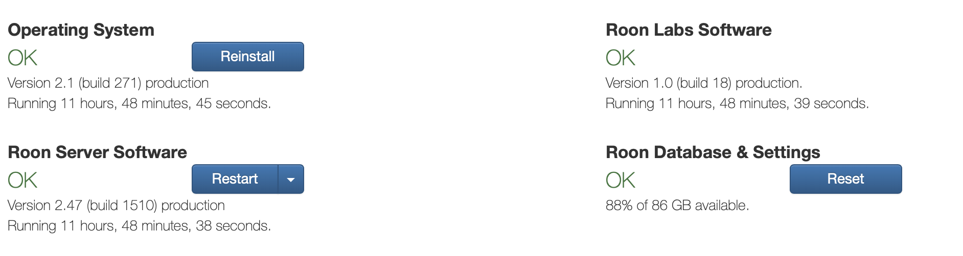

Thanks for reaching out! I’ve activated diagnostics for your Nucleus and can confirm that the diagnostics package came in. I do see some disconnects, but the reason for the disconnects is unclear, though it did look like you were close to using all the available RAM and then an ARC sync occurred. Does the issue only happen when you use ARC with the Nucleus? If you try to perform an Operating System reinstall via the button in your screenshot, does that help restore stability?

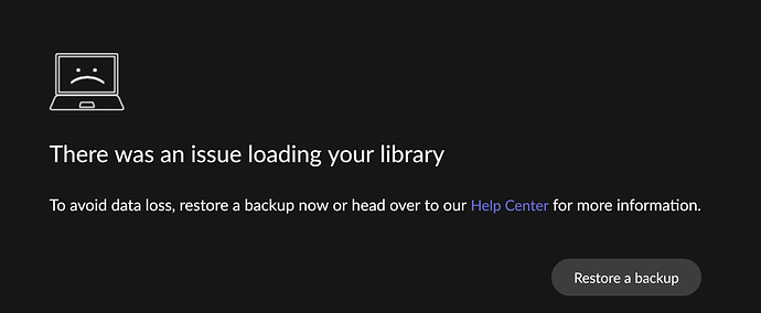

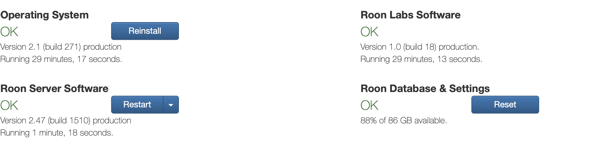

I just lost my server again. This is not funny
I have reinstalled a couple of times and nothing is changing.

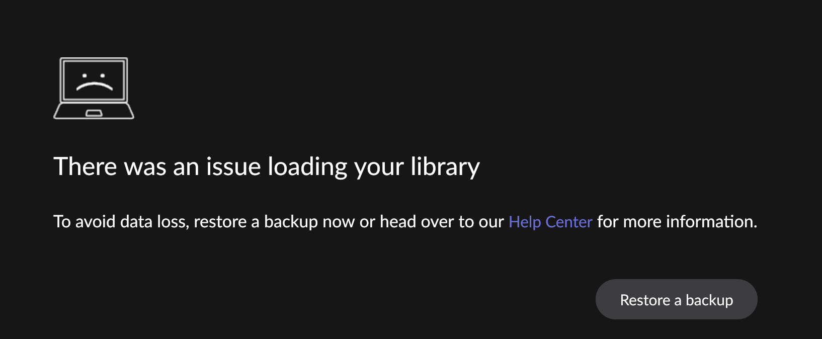

After a reboot of N1 everything looked ok and music was playing. I stopped the music and was planning to make a new backup because of new device. the screenshot is what I got. Please help me out.
Hi @BergeP,
Thanks for your post. As long as you still have at least one reliable Backup of the database you intend to migrate from the ROCK to the Nucleus One, you shouldn’t have lost any data despite the message above. There’s always a possibility the Backup itself was corrupted, but the more likely culprit here is that you’ve inadvertently installed overlapping RoonServer machines across these devices and this network during migration. .

My backup is on a USB stick directly attached to the N1. How do I check the backup outside of Roon? The ROCK is no longer connected but I can reconnect it. In step 3 you say RoonServer not running. Is this on the N1 or ROCK? And do I turn off the server before I repower on the N1?

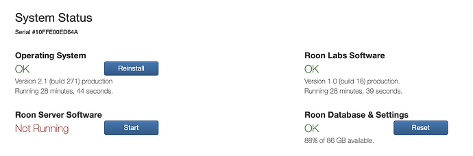

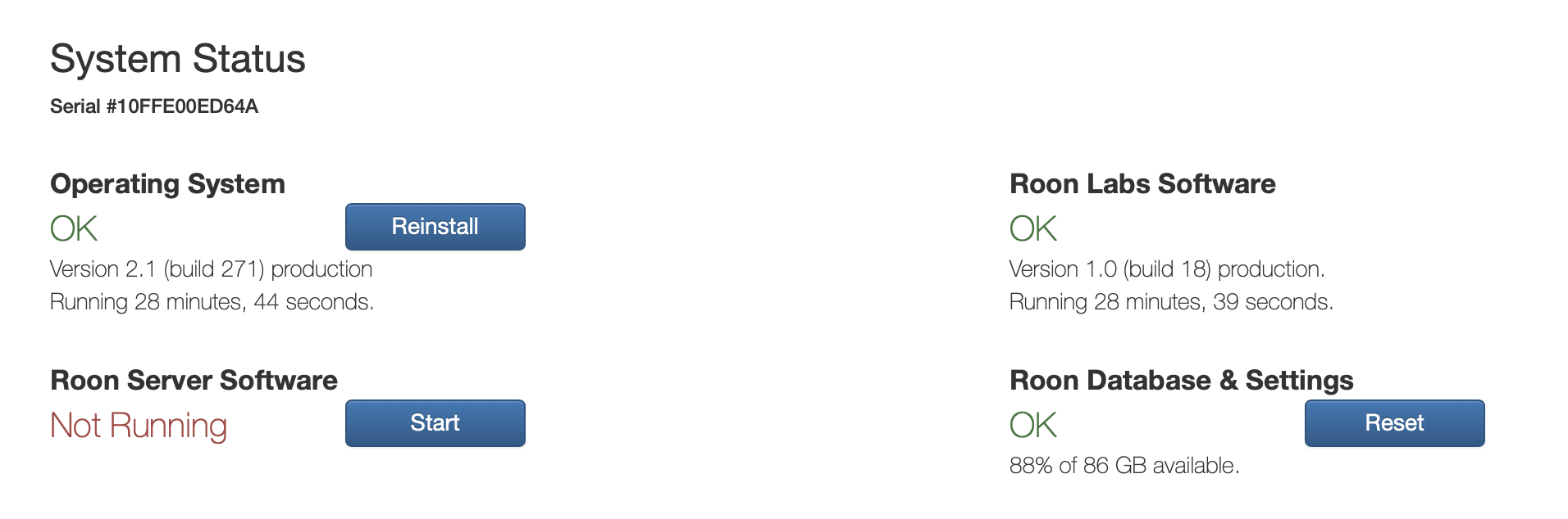

Since the USB stick is connected directly to the Nucleus One, the process can be simplified a bit:
  1. Navigate to the Nucleus’s WebUI|
  2. Stop RoonServer from running:
  1. Navigate to the RoonServer Database Location of the Nucleus using a file browser on a computer on your network
  2. Find the folder that says “RoonServer” and it to “RoonServer_old”
  3. Start the RoonServer in the WebUI to generate a new RoonServer Database
  4. On any of the Roon Remotes, press “Use another Roon Server” and connect to the new database
  5. Restore from backup on the USB drive
  6. Try to reboot the Nucleus One and create a new backup and check to see if the corruption error persists|
Note: Corruption checking is a periodic process but it mandatorily occurs when trying to create a new backup. If you reboot your Nucleus, it is possible that the corruption still exists, but it will temporarily be hidden until the next backup or periodic corruption check. It is imperative to try to create a new backup to ensure system stability.

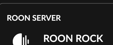

Is there a way to remove ROON ROCK and get Nucleus One instead. This shows up after the restore of the backup. My OCD needs to remove ROON ROCK:)

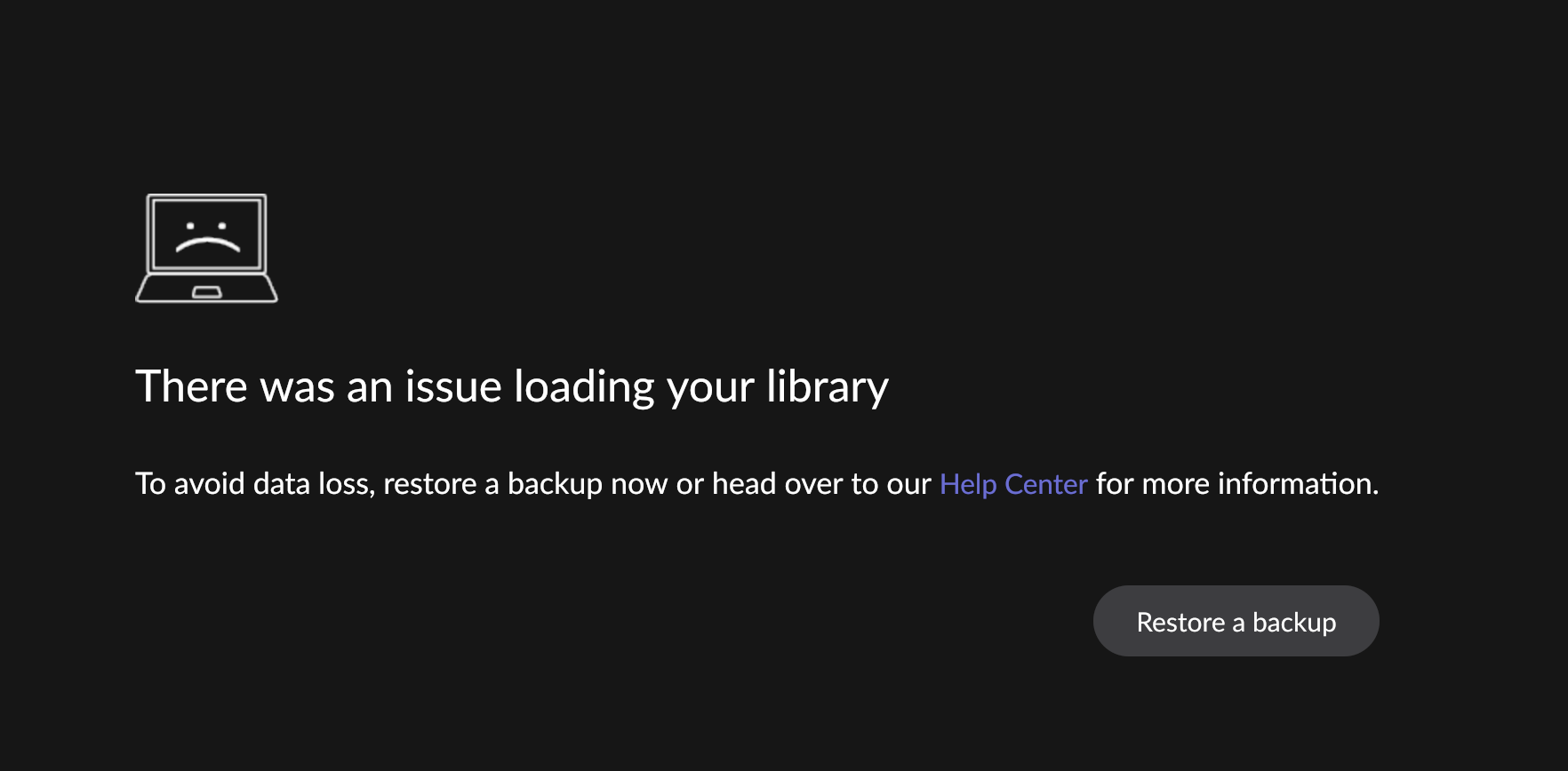

this is what happens when I try to make a backup.
What to do?

Hey @BergeP,
Thanks for the follow-up!
Unfortunately, it looks like the backup you restored from is also suffering from database related corruption:
Warn: [Broker:Misc] [broker] validation failed: LevelDb.Exception: Corruption:
As a next step, I would try to restore from an older backup that may predate the corruption. Let me know if you have any available to test!

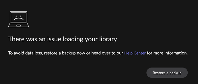

@connor this is my oldest backup. How come this is not happening when the automatic backup, once a month, is running?

Hey @BergeP,
Based on another fresh diagnositc report, it may be pointing to a USB drive failing - more specifically, your Kingston DataTraveler 3.0 : /
See the below error trace:
Debug: [RemotingServerV2] [broker/backups] getting restore items for location: FileBrowser.Entry: ROCK, Kingston DataTraveler 3.0 : /
Warn: [Broker:Misc] [backup] getrestoreitems, manifest file is corrupt: b_20240222105851_a29a98bc-8a56-4e65-bcb3-3d9b4be6a78e - System.NullReferenceException: Object reference not set to an instance of an object.
As a next step in testing, are you able to save a backup to a different USB drive, and see if you run into the same issue?
