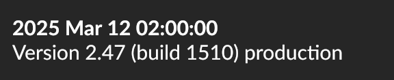

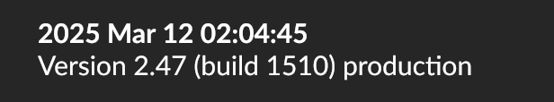

@benjamin ,
Screenshot 2025-03-13 at 23.20.08
Screenshot 2025-03-13 at 23.19.45
This is the backups. One is to iCloud and one is the USB stick
