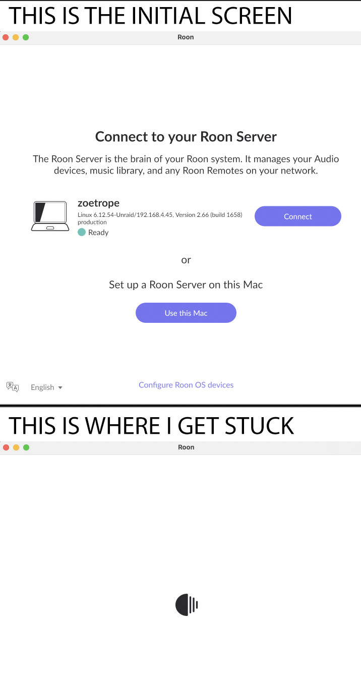

My roon server appears to be online, but when I tap "connect" i get a window with an animated roon logo and that is the end of the journey. I get stuck there. Tried it on mac, pc, and iphone. Same result. This seems to have started after the latest roon server update
Centurylink fiber modem c4000xg connected to Eero 6+ mesh network. I have not made a single change or adjustment to the system since roon was working a few days (or week) ago

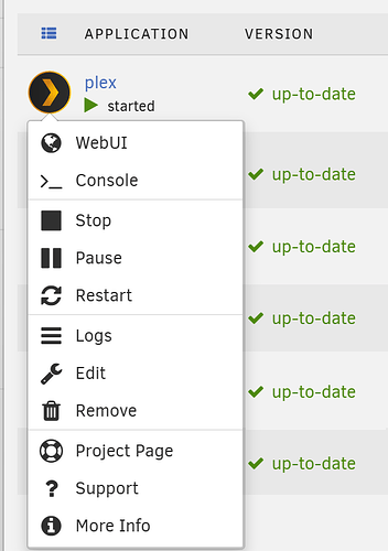

My apologies for the oversight! Looking closely at your screenshot, I see you are actually running Unraid, not QNAP.

  • In your Unraid Docker tab, click the Roon container icon and select Logs.
  • Look for any repeating error messages, tracebacks, or database corruption warnings. Please copy/paste the last few lines here for us.
