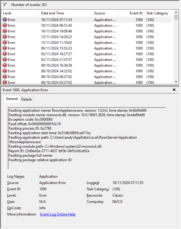

The five crashes since 13/10/2024 are all in mswsock.dll BUT they are all stack overflows so the actual cause could easily be somewhere else… it is unlikely that mswsock itself ate up 4MB of stack space. More likely that something else ate it up and a call to mwsock just triggered the overflow because it legitimately uses a large stack frame.
The crashes I saw before 13/10/2024 occur in all sorts of places… mswsock, coreclr, ntdll, ws2_32, and others.
The last two crashes share a common Fault offset (0x10C19) and the three before that are all 0x10BDF). In crashes prior to 13/11/2024 (nearly 300 crashes since 5th February 2024) I do occasionally see these two offsets but also LOTS of “random” others.

Thanks. Uploaded the …evtx logs for 07/10/2024 to 18/11/2024 just a couple minutes ago.
There is a big gap from 10/10/2024 to 02/11/2024.
That’s because it did not crash then.

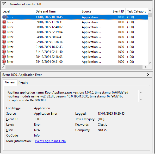

28-Dec-2024 09:31:00 in IPHLPAPI.DLL
31-Dec-2024 22:48:03 in mswsock nothing was playing
01-Jan-2025 16:42:43 in mswsock.dll
02-Jan-2025 01:38:14 in ws2_32.dll nothing was playing
No new files have been added to the library since this HDD was setup on 27th December.

The latest update to RoonServer EarlyAccess (auto-updated just yesterday) crashed with stack overflow again just now immediately when I launched Roon (client) on my desktop PC.
This is still running with the whole (fairly small) library on HDD and no library updates and with audio analysis (background and on-demand) OFF.
Looks just like all the previous stack overflows.
FYI, last several crashes are :-
