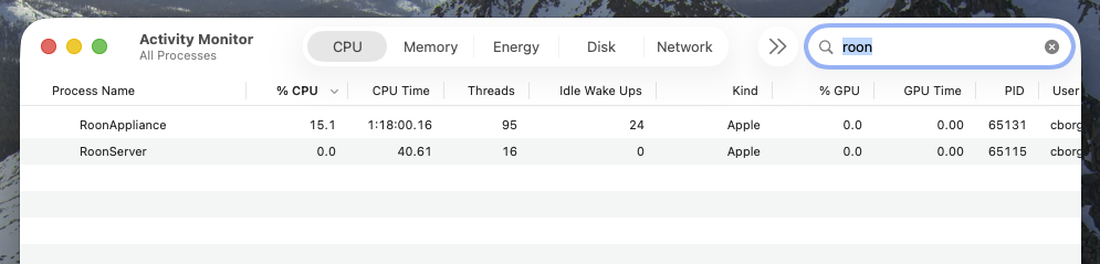

When you switch the users, can you please open Activity monitor and check if Roon Server app is still running ?
Regards.
This is what I see in Activity Monitor. Very different CPU uptime between the two.
Hi @Christopher_Borgmeye,
RoonServer requires the network interface to be active on the Mac at the user-level. When the screen is locked, background processes that aren’t operating at the root level are restricted from the network interface.
MacOS is restricting software access to the WiFi antenna during periods of inactivity; you’ll need to tweak this in Privacy & Security and your energy saver settings.
Try changing/disabling“log out after inactivity” in Privacy & Security → Log Out After. This will prevent the active user from getting logged out when the screen locks.
Try experimenting with different settings for “Wake for network access” as well. Some users turn to third-party apps like Amphetamine that keep the operating system awake.
