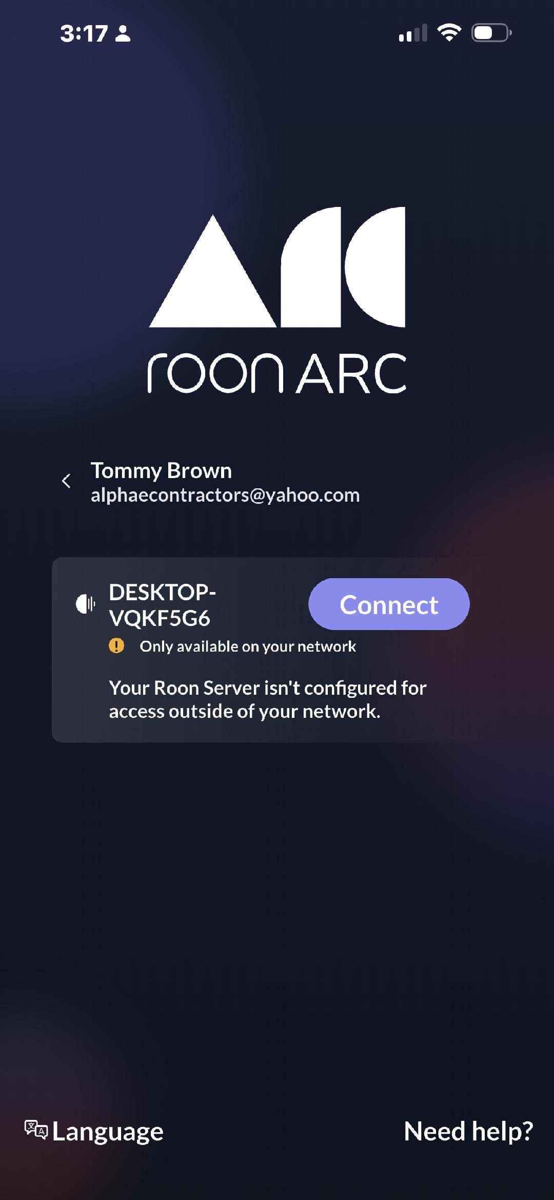

Roon server not configured for external network access (ref#KBFHGC)
getting message - your roon server isn't configured for access outside of your network
Mikrotik routerboard
