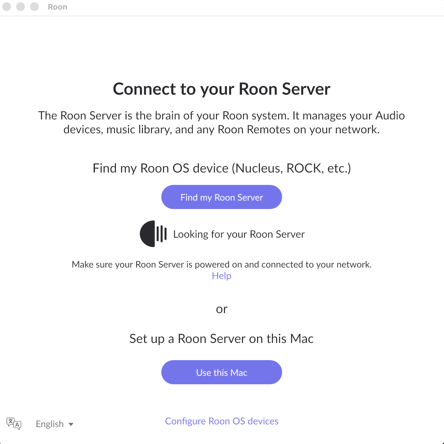

· I want to install Roon Server using Container Station on my QNAP-TVS-471, and my configuration is as follows:

I see that roon-server is running in Container Station.
Next, I launch the Roon app on my laptop (macOS), but unfortunately, Roon Server is not detected. What did I do wrong? Could you please help me? Thanks!
· NAS connected to router (to-link deco) via ethernet. I connect to Roon server with my laptop running Mac OS via wi-fi. All is on the same network.
Maybe there is an issue with the Container Station: for example, if I click on ‘Event logs,’ nothing happens and the UI freezes. I’m forced to completely quit and restart Safari to access the NAS again.
