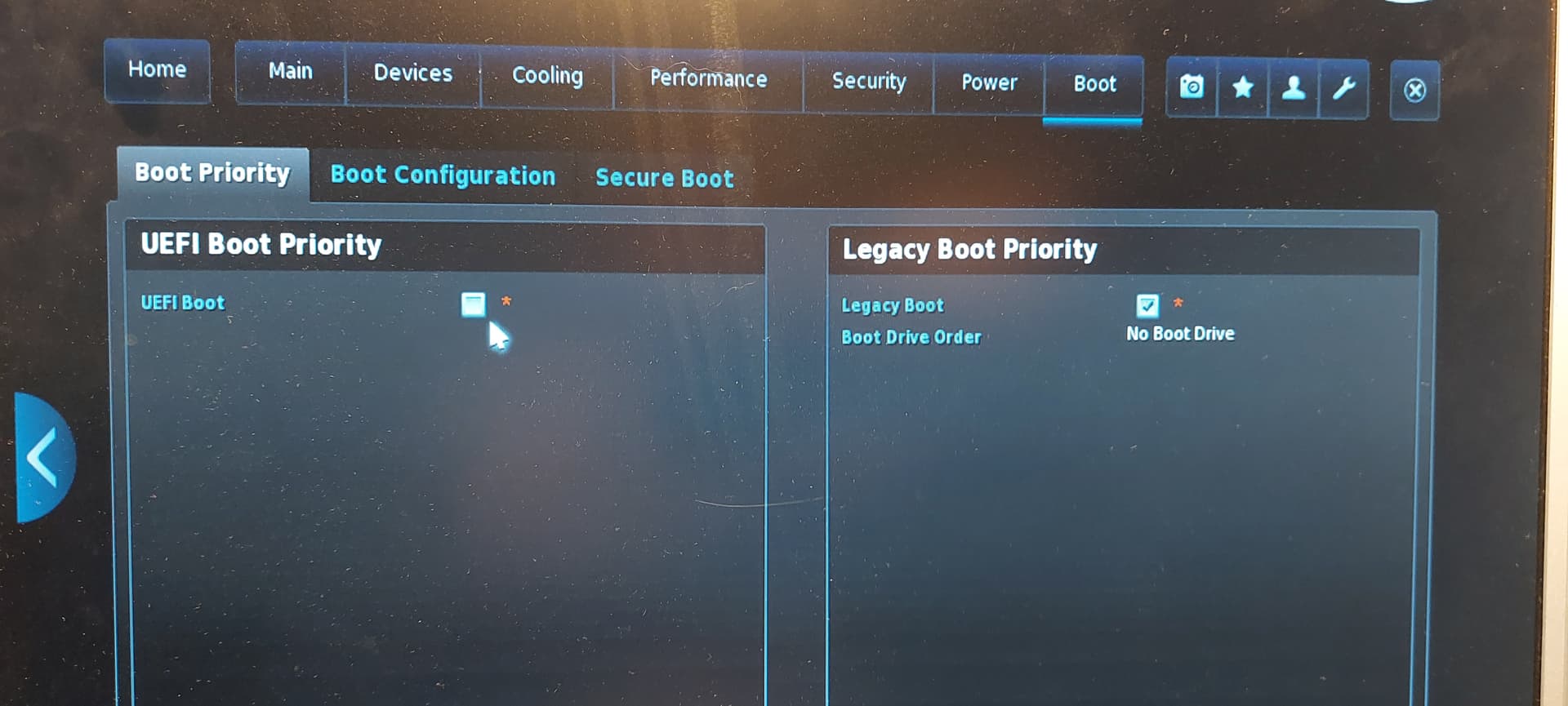

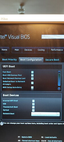

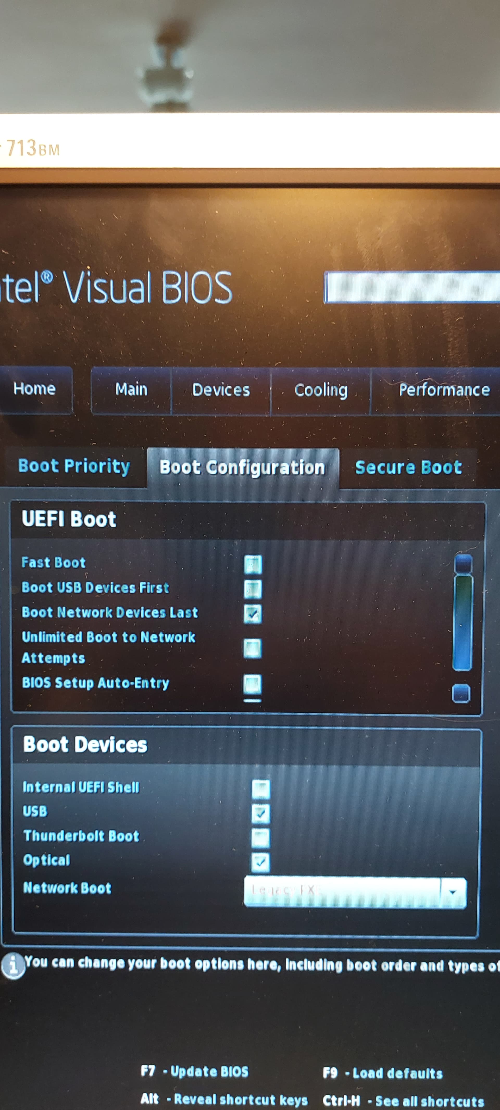

What OS are you running on your NUC? Windows, Linux or RoonOS (ROCK)?

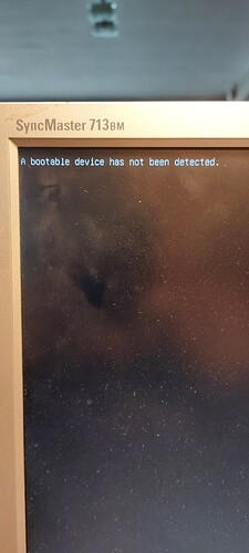

Firstly, have you connected your new NUC to a monitor or a TV? If so, do you see the Roon Server booting? If it is running RoonOS (ROCK) then you should see some text including the network status (ip address if everything is working).

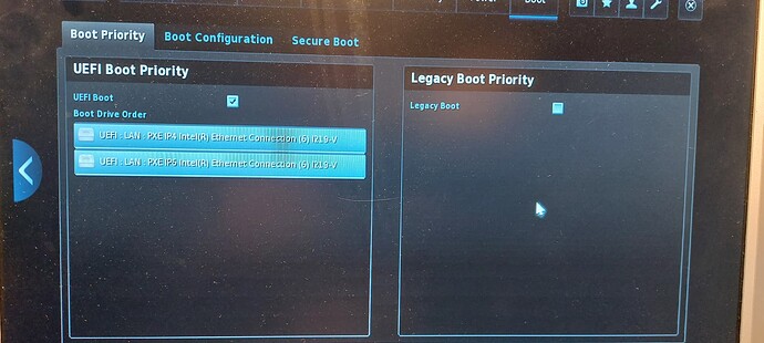

If you don’t see the OS booting with the monitor attached, then maybe the BIOS is set wrong on the new NUC. Maybe your drive was installed for BIOS boot and your new NUC is set to use UEFI boot (or vice-versa) in which case the OS will not boot. Try entering the BIOS (you will need to connect a USB keyboard as well as a TV/Monitor) and checking the boot settings. It they are set to UEFI boot, try setting them to BIOS boot (legacy boot). If set to BIOS boot, try setting them to UEFI boot.
Post photographs/screen shots of what you see on the NUC monitor.

Thanks for reaching out to us about this issue. I think with the new motherboard that we should treat this as a fresh ROCK install and then restore a back up after. You can follow this guide to do that. https://help.roonlabs.com/portal/en/kb/articles/rock-install-guide
I also think so, and I’ll do it.
