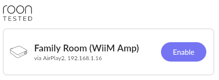

I have the latest Sonos Amp in the family room, but Roon shows it as a WiiM Amp via Airplay2 in the Roon Tested list of devices. However, it will not play.

I do have a WiiM Pro in the house in my main system. It is really odd that roon sees my Sonos Amp (latest one) as a WiiM Amp. I can ignore this for now.

How are you estabishing its seeing it as Wiim? I can’t see this being possible. Please show a screen grab of your devices in Roon. What’s the ip of the Sonos Amp and the Wiim?

The Family Room device most definitely is not a WiiM Amp. It is a Sonos Amp (latest gen). The IP given is the IP of my Sonos Amp. I don’t own a WiiM Amp – not yet anyway, but I’m thinking of adding one in my office. Therefore, this looks to me like roon is not properly identifying my Sonos Amp.
Screenshot 2024-12-07 at 6.58.55 PM

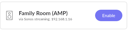

Down in Other Network Devices, the Amp is shown as a Sonos device.

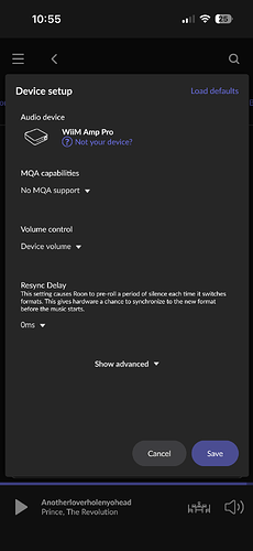

That is very strange, each device has its own id as to what it is so this should not happen. You definitely not changed it manually to try and identify it? What happens if you load defaults using the text shown to the right below?
Nothing changes if I hit Load defaults.
One for support that one then. I would raise another ticket for it.

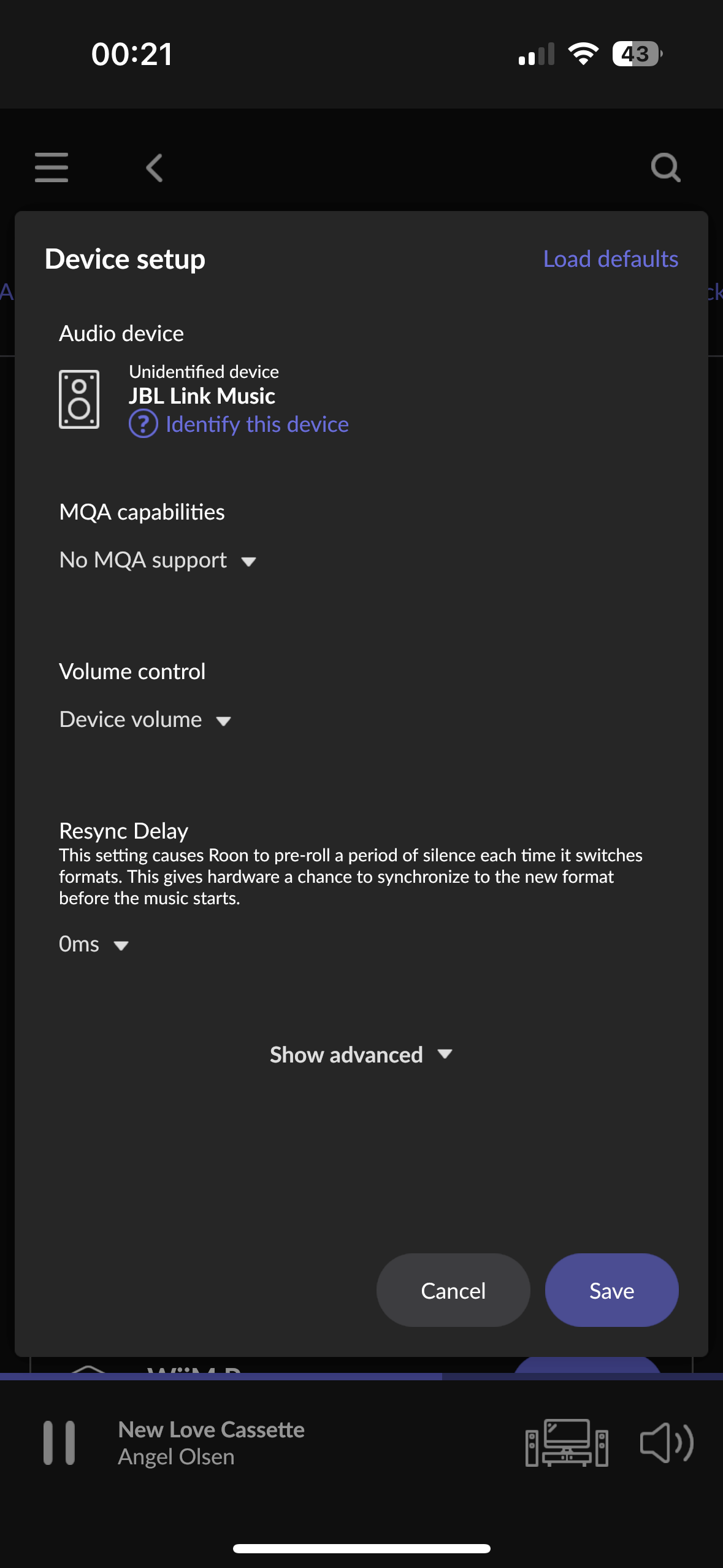

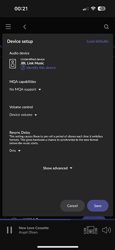

If it’s seeing it as device you don’t get options to change it, only unidentified devices have that option. So if it’s been manually changed to be the Wiim Amp which it looks like it has been, you can reset it normally by hitting set defaults but that seems to be broken. So that’s another bug. Just changed my JBl to be a Wiim amp and now can’t set it back. :person_facepalming:
As gen2 Sonos amp isn’t a recognised device he can’t choose it anyway and if you use S1 it may not work as it doesn’t now as a Wiim.
I’ve now broken my JBL, have to now delete RAAT server data. Ffs
