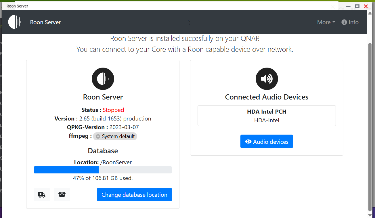

As mentioned before, I tried to play some music using my iPad as my Roon interface. My player is a Devialet 140, I have Roon Server installed on a dedicated solid state disk in my QNAP TS-453 a, set up which up until now functioned quite OK. When opening the iOS Roon App, I was informed that there were updates available for one or more devices. I hit :"Udate all". I waited patiently and tried again. The message "Waiting for your Roon Server still appeared. I checked all wired connections, they appear to be OK.
Then I decided to check in the app center of my QNAP to see if Roon was running at all. It looked that way but when I opened the Roon application it indicated (in red) that Roon was stopped. This certainly was not my doing, at least I never instructed the application to stop running.
I restarted the aplication. Nothing changed. Same message. Roon had been, or was stopped.
Then I rebooted my QNAP. Nothing changed.
I tried to get the latest build of Roon Server via the app on my QNAP. It looked like it downloaded, seemed to be running, but I still only find that "Roon server was stopped". This error seems to persist. I am not a computer man at all, so by now I have run out of options I think....
Reinstalling Roon Server with Docker (?) looks very terrifying to me..... The terminolgy used sends shivers down my spine.....
Could you help me out?
· I use a Fritzbox 4040 router/switch, my QNAP is connected to that via a Netgear GS 308BE switch and so is my Devialet 140. So far I have hardly had any network issues.
The Roon Server package no longer works, please switch to the official Docker image to run Roon Server on your NAS. See also:
Hi @Harm_Kersten,
Thanks for the screenshot and the details about your QNAP setup. Since the Roon Server package no longer works on QNAP, we need to move to the official Docker image instead.
Please use the guide here: https://help.roonlabs.com/portal/en/kb/articles/installing-roonserver-on-qnap-with-docker. If you run into anything while going through it, let us know what you see and we will help from there.
