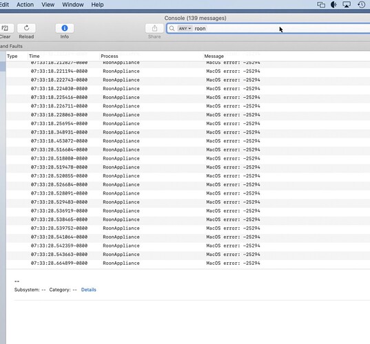

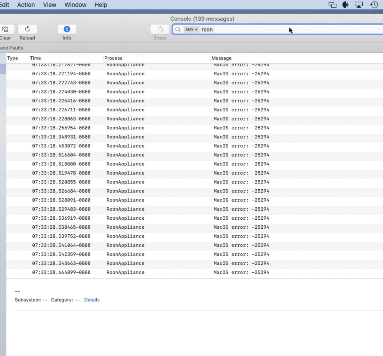

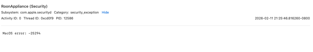

[quote="James_Moore, post:1, topic:315398"] I see in the Mac Console error MacOS error: -25294 a lot [/quote]
Are you still seeing this? This is a security/permissions error. Roon relies on the macOS Keychain to manage security certificates and tokens for streaming services (Qobuz) and device handshakes. If the Keychain is “stuck,” Roon hangs while trying to authenticate the stream, which explains why the playhead doesn’t move.
  • The Fix: Open Keychain Access (Applications > Utilities).
  • Go to File > Lock Keychain "login", then immediately unlock it again with your Mac password.
  • If that doesn't help, run the Keychain First Aid (if available in your version) or manually delete any expired Roon-related certificates (after backing up).

Regarding the Console errors. There is no Keychain Firstaid in this version of Mac OS - I think they removed it in a version a few years earlier. I don’t see any any expired Roon-related certificates, or frankly any Roon-related certificates at all. Is there anything else you might suggest? Thank You!

The MacOS error: -25294 you are seeing in your Mac Console is the smoking gun here. This is an Apple Keychain error directly related to security certificate validation.
Here is exactly what is happening:
Because your 2012 Mac Mini is running macOS 10.15 (Catalina), it is no longer receiving root certificate updates from Apple. Meanwhile, streaming services like Qobuz and Roon’s own cloud infrastructure are constantly updating their security protocols to modern standards. When your Mac tries to securely handshake with Qobuz to play a track, the outdated certificates on your machine fail the validation. The connection stalls, and the music simply hangs without starting. Restarting Roon temporarily clears the connection cache, which is why it works briefly before failing again.

Hello, OK. You are talking about the error’s in the logs, not the other issue with the recent update that is causing issues. So, ya, the errors are still occurring. See attached screenshot.
