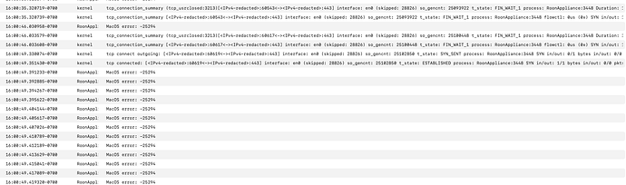

So thinking through your comment about a “clean database test” I decided to give that a try, so I deleted Roon app and Roon files everywhere I could find them by searching and my general Mac knowledge, and then reinstalled the software fresh. I logged in but didn’t add any files or log into Qobuz. I was watching the logs and I got the error only about 15 times . Then it stopped and did not start again. After waiting for a while and not seeing the error I moved on with my testing.
So then I pointed Roon to my my external SSD that contains all my music and boom . After like 10 mins or so I have over qty 30,000 MacOS error - 25294 messages. And counting up fast. I haven’t even played a song - but roon is in the process of “Adding music to the library”
Next I disabled my local storage and the messages stopped and stayed stopped.
Then I Logged in to Qobuz and in like 2 mins in had over 50,000 -25294 messages, and the number of errors was climbing fast while it syncs.
So it’s clearly about general network access, both syncing a library from a streaming platform or IDing local files- I just can’t figure out what is going on. I hope your developers help us determine what’s happening. In the meantime I guess I restore from my backup and wait for your reply.

Apologies if this has already been glazed over, but are you using any active VPNs within your local network setup?
The reason we ask is that based on the full Roon Server log, -25294 errors fire in bursts immediately after TCP connections to port 443 (HTTPS) are established via utun4, and utun4 is a VPN tunnel interface.
If you disable any VPNs, do you still run into the same issue?
No VPN’s in use. Roon is on this brand new Mac mini, and is the only app I’ve ever installed on this new Mac other than a hard drive search tool called EasyFind By Devon Tech ( DEVONtechnologies | Needful Things ) and Roon, of course.
The Mini is hardwired to my network and was assigned an IP by my router, which I just made a DHCP reservation for it in the router. There are no active VPN’s enabled anyplace on the network.
I did a netstat -rn in terminal and the routing table I think looks clean. Everything goes through en0 (the physical ethernet/wifi interface) with a normal gateway of 192.168.1.1 of my router. There is no utun4 interface anywhere in the routing table, so I’m thinking no VPN smoking gun there, so no vpn tunnel that I can tell with what I know. Maybe I’m misunderstanding that you are thinking or not looking at the correct relevant data. Thanks. I look forward to more follow up or any report from your R&D team that was mentioned earlier by Vadim.

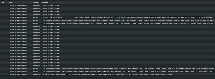

You mentioned that the errors accumulated during import. As a test, please try copying a few of these local files to a completely new folder stored directly on the Mac (like the desktop). Create a Watched Folder in Roon pointing to that location instead. Do you see the -25294 accumulate for each track import? We can scan the logs for you, we’ve requested diagnostics from the account automatically.

The -25294 errors came like crazy when I first connected the new/clean Roon to Qobuz AND also when I then next added my local files. I mean by the 10’s of thousands. Once those files (streaming and local) all got scanned by Roon, the errors died down - BUT, it still happens. They come like 14 at a time, or sometimes just one. I just checked and I see that happening right now.
So I did what you asked. I added a folder to my desktop that had about 10 albums worth of files in it and added it as you requested, and there was a small flurry of activity - but not sure how significant of what this shows. I took a screenshot movie of the process, but it looks like your system won’t allow the upload. Thanks -
Hey, @James_Moore.
Thanks for performing that test.
We were able to reproduce the same problem on our side, and it has already been passed to our developers since it is easily reproducible.
Could you please clarify whether you are still seeing any issues other than the -25294 error spamming in console ?
