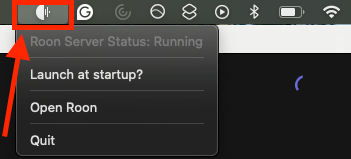

Hey @alanferris45,
To confirm, you’re attempting to start Roon Server on your mac, but it’s failing to do so - you don’t see the Roon Jellyfish on the upper right hand task bar of your mac? Like so:

If I click on the Roon “Jellyfish” in the task bar I get nothing but the rotating color circle. Again going back to try to open Roon from the icon I get an option to click on open Roon Server. This will run the “Jellyfish” for a while and then revert back to the open server option. When we returned from a couple week vacation a few weeks ago Roon was continuously running (and would not stop) a Snap Backup, or something to that effect. Hopefullly this information helps. Thanks Alan
