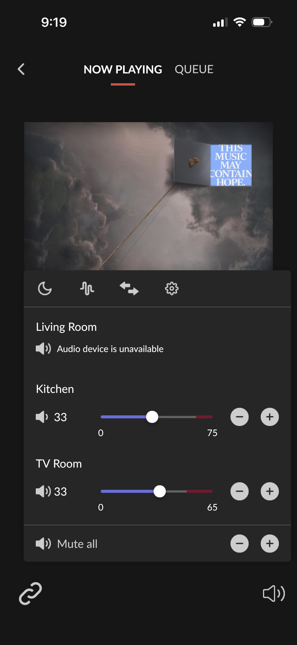

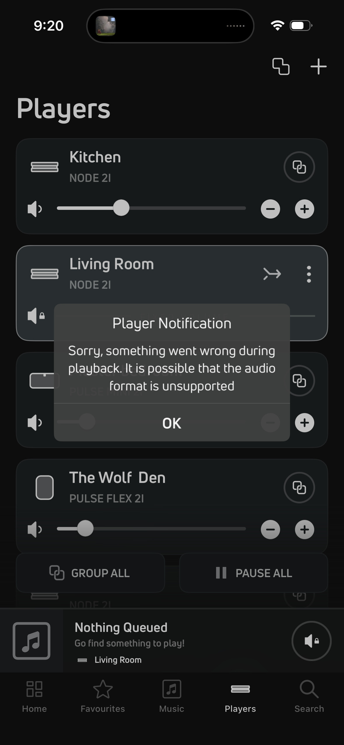

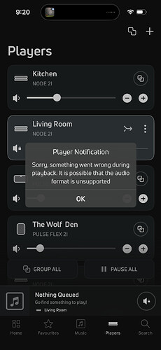

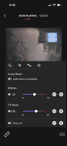

Back to issues with my grouped zones this evening. Each track plays for a few seconds then skips to the next. It appears to have been going on for quite a while with over 150 skipped tracks.
After rebooting server, music plays without skipping, but is now not coming through living room zone.
opened bluesound app to reboot living room, and observed error message in attached screenshot.
after rebooting living room, system is restored to normal operation.

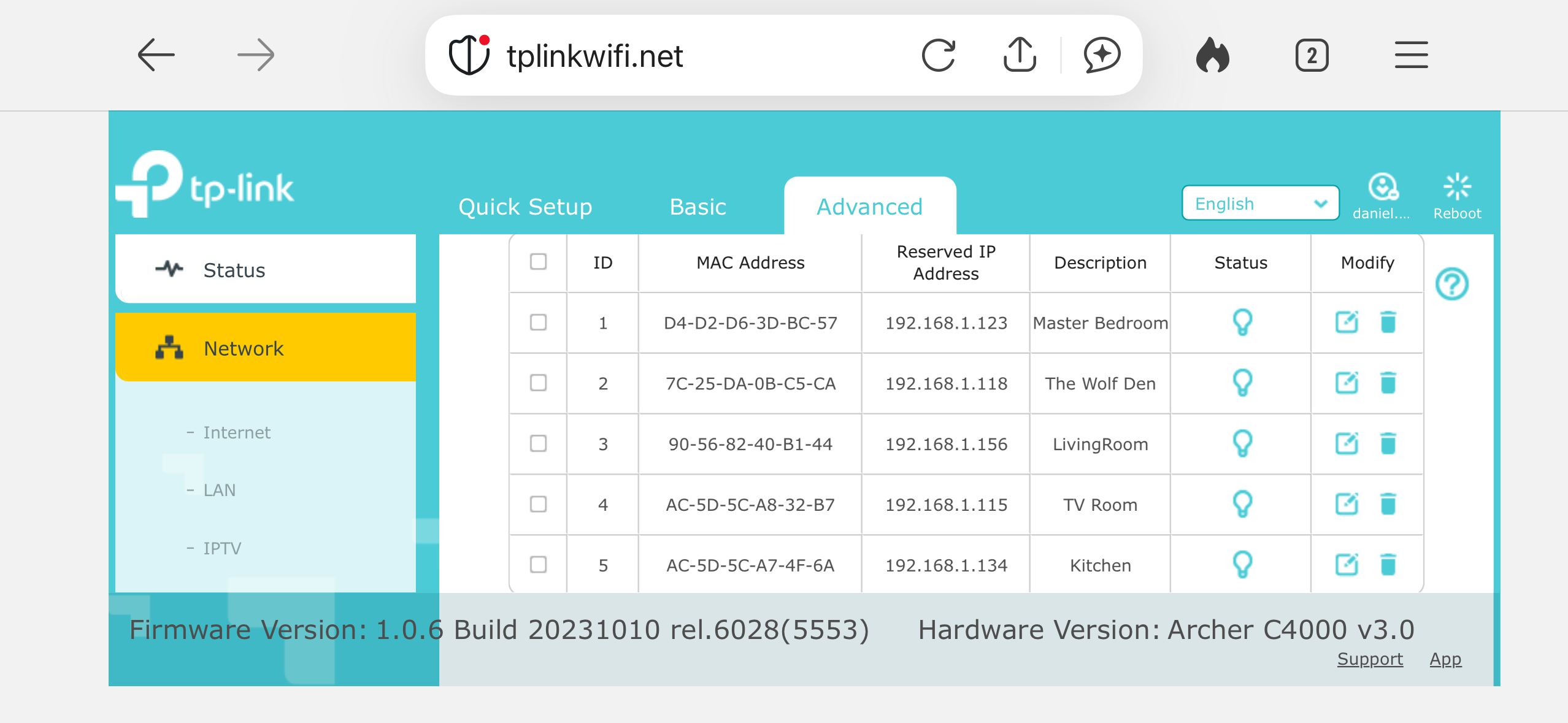

when I tested zones ungrouped this week, I actually ran all 3 simultaneously for about 24 hours and TV room seemed to be fine. I’m not sure what you mean by reframe to tv room. Does this mean use it as the anchor for the group? I’m also not sure what you mean by swap it to a known good port, because the issues seem to affect both the other zones at different times.
with respect to DHCP reservations, I just checked and it appears I’ve already done this. See the attached picture.

It is interesting that your router is listing 192.168.1.156 as the Living Room IP. Using a tool like Fing, I would suggest taking a look and see if there isn’t something on your network using the IP 192.168.1.157.

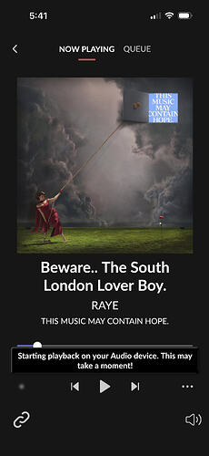

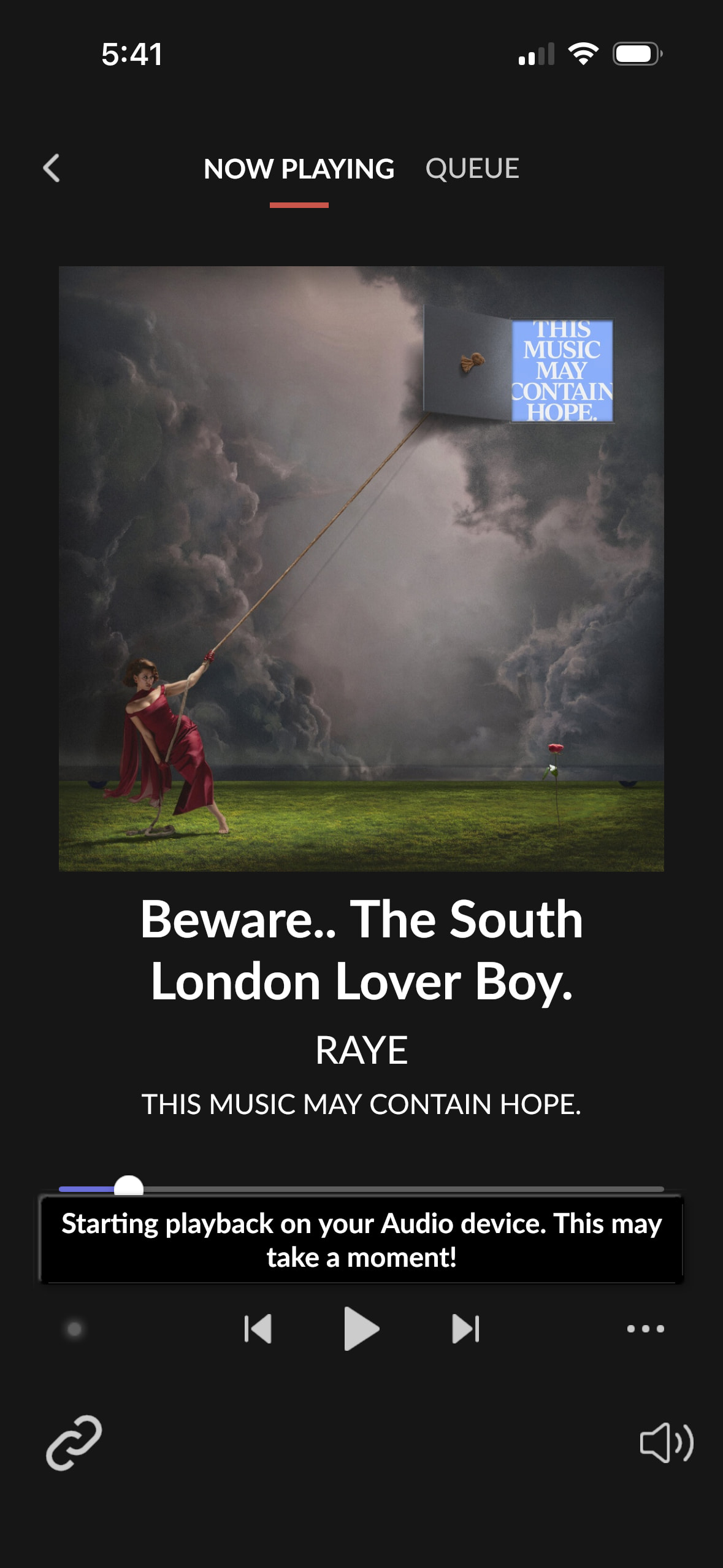

More issues this evening as follows:
music starts skipping every track after several seconds on my group of three zones. Ungrouped and regrouped to confirm that living room plus tv room plays fine, but any grouping including kitchen does not. Rebooted kitchen
hardware. Now music playback will not start at all with message in screenshot below displaying. Rebooted Mac hosting Roon server, and system returned to normal functioning.
Hi Daniel,
Thanks for the screenshot - that “Starting playback on your Audio device” message is the exact failure point we were looking for.
After reviewing your diagnostic logs we’ve identified the root cause. Your Mac is connected to the network through two active Ethernet interfaces simultaneously, and they’ve each picked up different Bluesound nodes:
  • Interface 1 (192.168.1.173) → Kitchen
  • Interface 2 (192.168.1.117) → Living Room + TV Room
When Roon’s RAAT audio engine runs a synchronized group, it needs to send perfectly timed audio frames to all endpoints from a single source. With your Mac presenting as two different hosts on the network, RAAT cannot maintain that synchronization - the result is exactly what you’re seeing: the whole group skips, and only a server reboot resets the connection state.
The fix:
Go to System Settings → Network, select Wi-Fi, and turn it off. Since your Mac is already wired via Ethernet, you won’t lose internet access. Once WiFi is disabled, all three Bluesound nodes will route through a single interface and grouped playback should stabilize.
