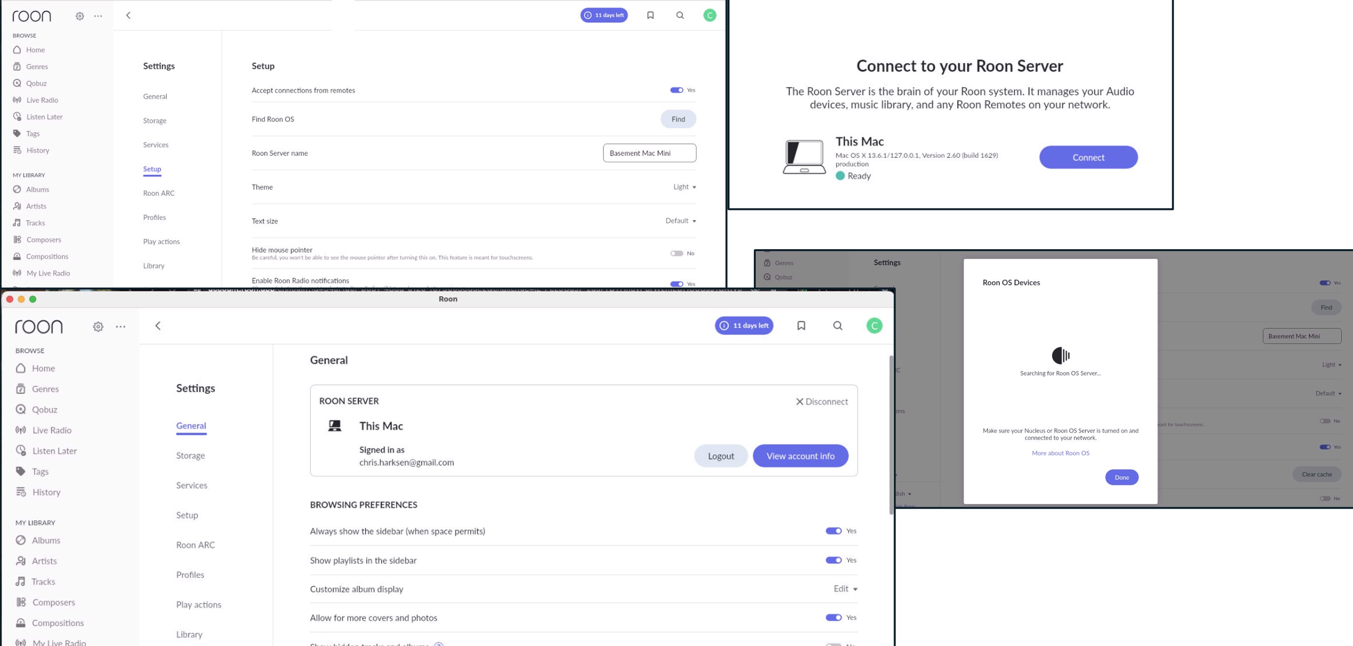

I loaded the Roon Software onto a Mac Mini, and made it my server connected to a DAC. When I go to the General screen, it says Roon Server, This Mac. I have full functionality on the device, (play music, song lyrics, etc), but I can't attach in from another device, or when I go to Find Roon OS, it just spins.

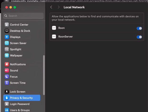

I checked. On the Mac Mini (again, used for my server and an end device), both Roon and Roon Server are allowed access

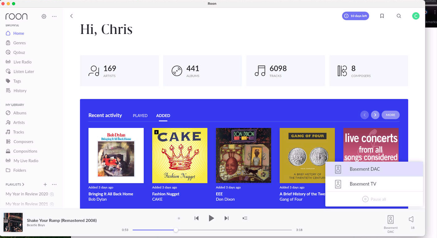

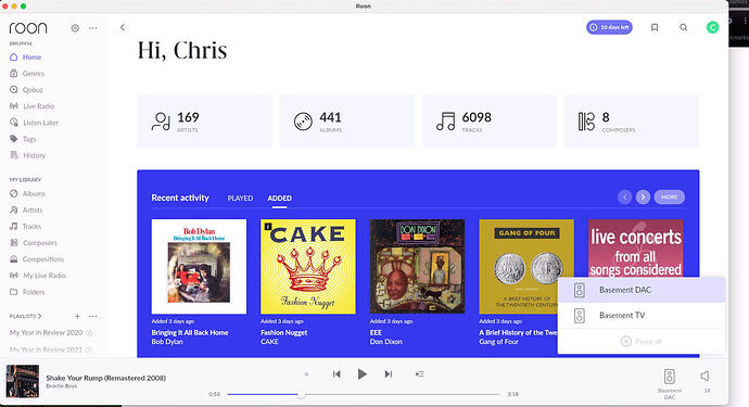

Also, if helpful, here is what Roon shows for available devices on the mac mini:
Let me know if I can check anything else. Thanks!

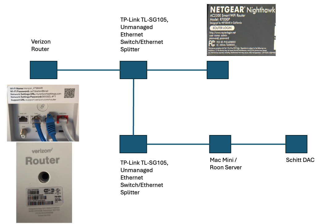

Hi Conner, I have a pretty simple setup, diagram attached. No Mesh network, a couple of basic ethernet switches/splitters, and an additional Wi-Fi point.
The level of diagnostic and customization you have requested here is not realistic. Verizon provides me a router, how am I support to know how to implement the items here? I have setup tons of servers/routers/etc, if this is what’s needed to setup a Roon server, it’s a wonder anyone has gotten it to work. Also, the nodes and clients URL page you provided doesn’t exist.

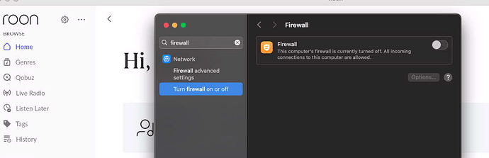

Another quick test if you haven’t yet - temporarily disable the macOS firewall on your server machine, and reboot everything. Let me know if run into the same issues.
Thanks, Chris! :raising_hands:

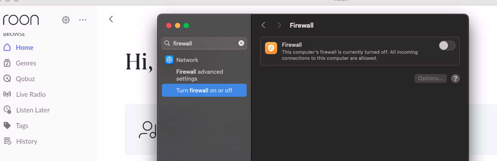

Ok, I took the Netgear router totally off the network, it was just an additional Wi-Fi spot. I also checked the Firewall, it has never been on. Still cannon connect another device to the server.
