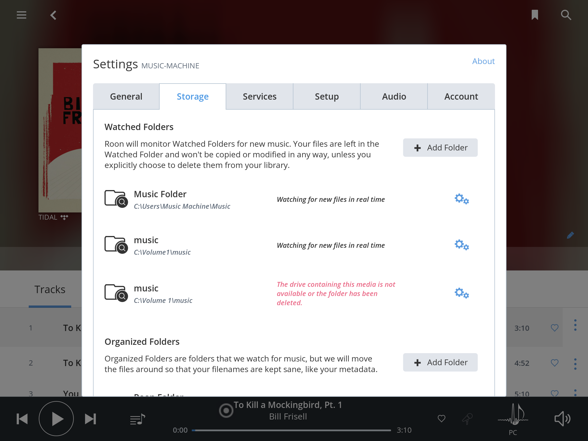

A few things I see on your screenshots:
  • Your music share on your Synology is written completely uppercase. So you have to enter it as “MUSIC” (paths in linux are case sensitive!).
  • You still added your drive letter. Do not add “C:”. There are no drive letters in linux.
  • Volume should be spelled lowercose and there is no space afterwards (it should be “volume1”, NOT “Volume 1”.
  • Don’t mix up the regular slash “/” with a backslash “”. I know you are using backslashes “” in windows (C:\Directory1\Directory2), but in linux you need a regular slash “/”!
In your case, your correct local folder path is:
/volume1/MUSIC
Just enter this line in “add local folder”. Nothing else (like drive letter, or colon character).
Ok. Tried /volume1/MUSIC Here’s the screenshot. And btw, not ONCE did I ever add the C: drive. It automatically shows up after hitting the blue Add Folder under Add Local Folder.

Ok. I think I know what is happening:
I think you are connecting to a RoonServer on a Windows PC.
There is no RoonServer shared folder in your Synology screenshot. That would be a requirement to launch RoonServer on the Synology. Otherwise it won’t start.
Do you use a DS1515 or DS1515+ ?
I am asking because RoonServer on Synology requires a 64bit CPU and the DS1515 is equipped with a 32bit cpu. The DS1515+ has the required 64bit cpu.
1515+. Do you have a link on how to set that up?
@crieke, I don’t want to but in, but I’m not sure that fore is running Roon on his NAS. The Music Folder is a default location put in by the server. In this case “C:\User\Music Machine\Music” indicates that the Core Server is still running on a Windows Machine, which is why the drive letter is being auto added.
@fore
IF you have not tried it this way, I would suggest you run RoonServer on your new PC. RoonServer is Roon without the UI. After RoonServer is loaded on the PC, install Roon on another Mac, PC, iPad, iPhone, Android Phone, or Android Tablet and link in to the RoonServer to configure and set it up.
