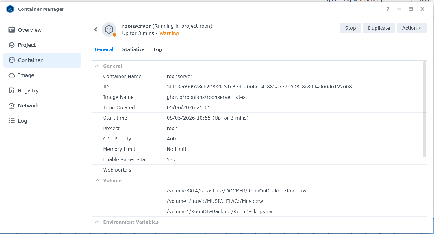

I run in Docker. I installed the hotfix that was just released and restarted the container. The container is still showing up as “unhealthy” in the management tools I use.
Is the docker image still not reporting correctly?
It’s still reporting as unhealthy for me. This is after installing the hotfix and restarting the container.

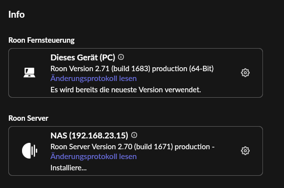

My system NAS Synology would not install the hotfix, stops with an error.

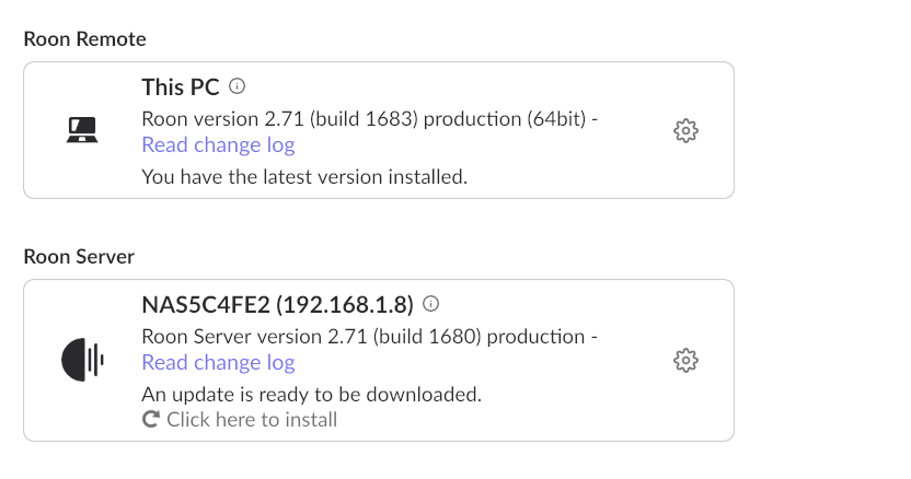

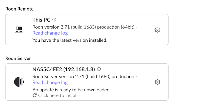

Starts out wanting to upgrade the server, shows the update ready to download:
Clicking the update button shows downloading and installing, then the error.
Hey @Alan_Sparks,
Thanks for writing in! From a fresh Roon Server diagnostic, we can see that your Aug 4 update worked correctly. The logs show 2.71 build 1680 downloading, installing, and staging cleanly, and since you’re now running 1680, the restart applied it as intended. Updating inside your Docker container isn’t broken.
If you can, please restart the container. Then click through the update as you did on the 4th. A plain stop/start in Container Station is all that’s needed, not a redeploy or recreate.
If it still doesn’t offer 1683 after a restart, let us know and we’ll pull a fresh diagnostic report. Thank you!

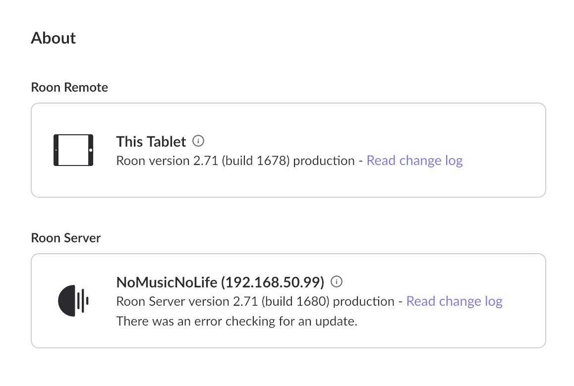

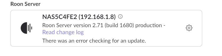

Thanks for the reply. I restarted the application and tried the update again. Unfortunately it again responded with the same “error checking for an update” message.

I've read that build 1683 is for specific hardware, so can this be safely ignored, or should I redeploy the container?

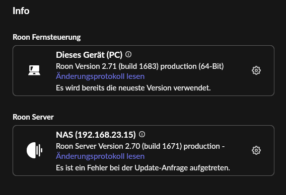

Same here, error message attached here, it appear after installation failed
Exactly the same here
I have tried restart the Roon server app in the container as well as restart the NAS, both doesn’t resolve the issue!
Hey @KMM,
Can you please use these instructions to access your Synology logs, upload them to our secure uploader linked below, and let us know once uploaded so that we can check?
https://workdrive.zohoexternal.com/collection/nocvrfc5b2ddab55140af8640f1d7ce13291e/external
Also, do you happen to have the YAML file you used for the container install? Or do you recall if you had network mode set to Host when you set it up?
This is a known issue that’s being worked on in the GitHub for the Docker container. It’s looking for a DLL, and Roon is now using an EXE, so that’s what’s causing the problem. It’s just a cosmetic problem, really. I think someone posted a fix this morning in GitHub. Don’t quote me on that :grinning_face:

The hotfix targets MacOS and RoonOS operating systems only, so it shouldn’t affect your QNAP setups. Remaining on build 1680 shouldn’t have any adverse effects.
Are you all currently able to use Roon and connect to your remotes without issue?

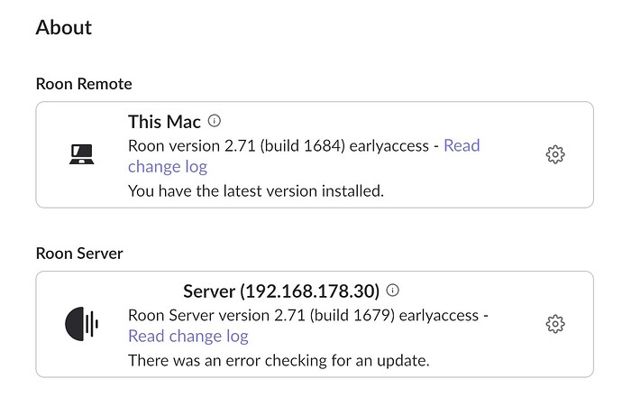

Same behavior with EA build 1684 (I assume this is mostly identical version to 1683):
