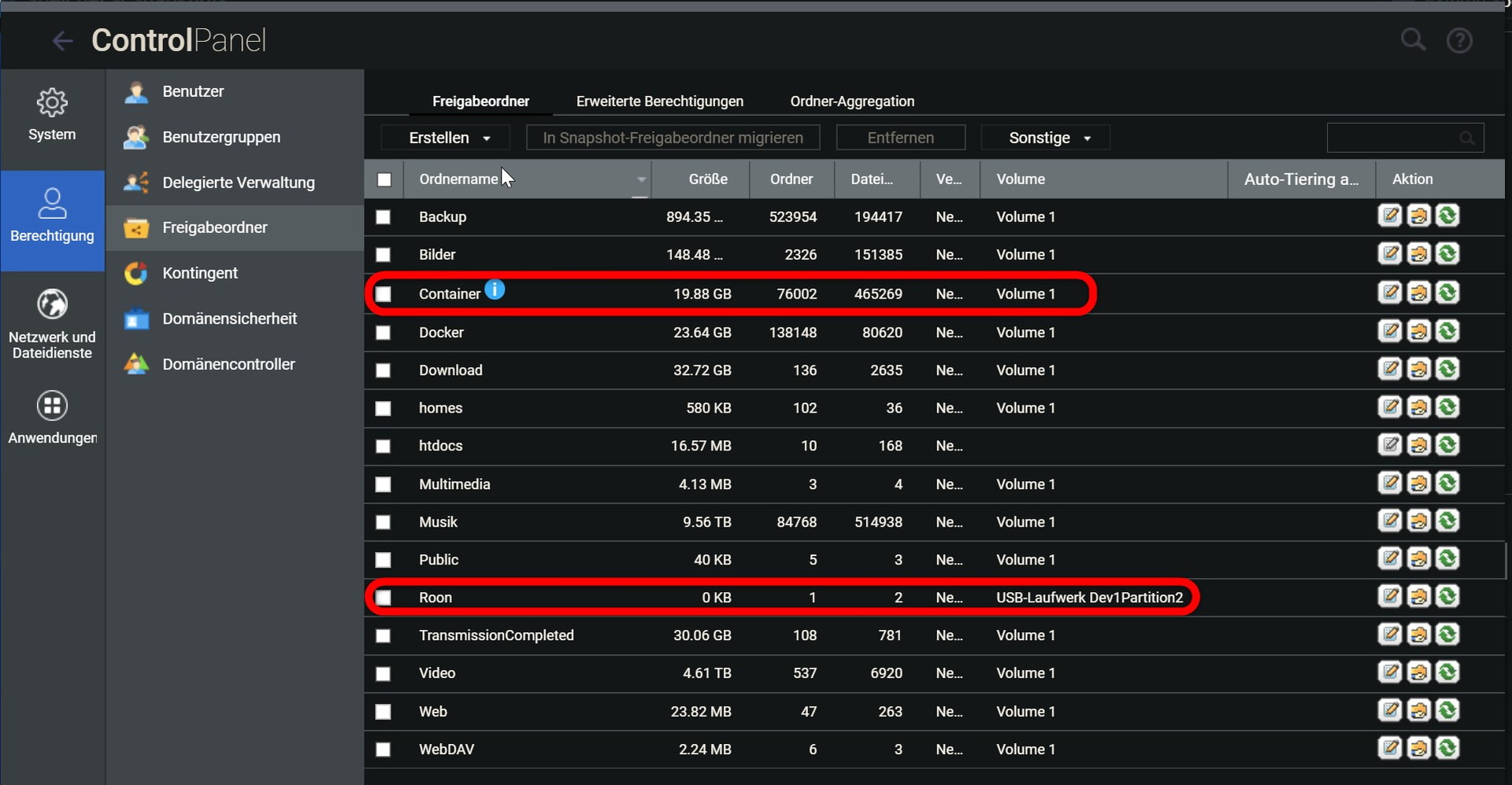

This is how it looks like:
The blue information bubble is saying that this shared folder cannot be changed or removed.
So I should change the first share path in cocker compose from
/share/Container/roon:/Roon to /share/Roon?
Is it possible that you don´t have any internal SSD volume formatted and mounted correctly? Can you route other shared folders than /Container, to internal SSD volume? It would not work on an external volume such as a USB drive.

You can install Roon Server plus its internal database in a container on an external USB volume. You just have to create this folder, which you apparently did, named /Roon on external volume Dev1Partition2.
Note that you cannot mount the /Container folder, as used by Container Station, on an external USB volume! Container station data and roon container exist separately in this case, which I can confirm that it is working.
That is the reason why the share folder path beginning with /share/Container does not work in your case. You need to adjust the first share path in docker compose to the folder on the USB volume, try:
/share/Dev1Partition2/Roon:/Roon
or
/Share/Roon:/Roon
(The latter works solely if the mounted folder sharable)
Good luck!
