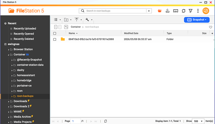

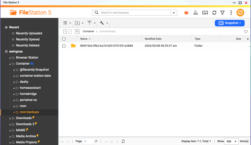

Enclosed is a screen shot of FileStation 5 with my container shared folder and Roon-backups folder shown. The folder inside is the last backup that the old .qpkg version completed before the transition. I had copied it to this folder.

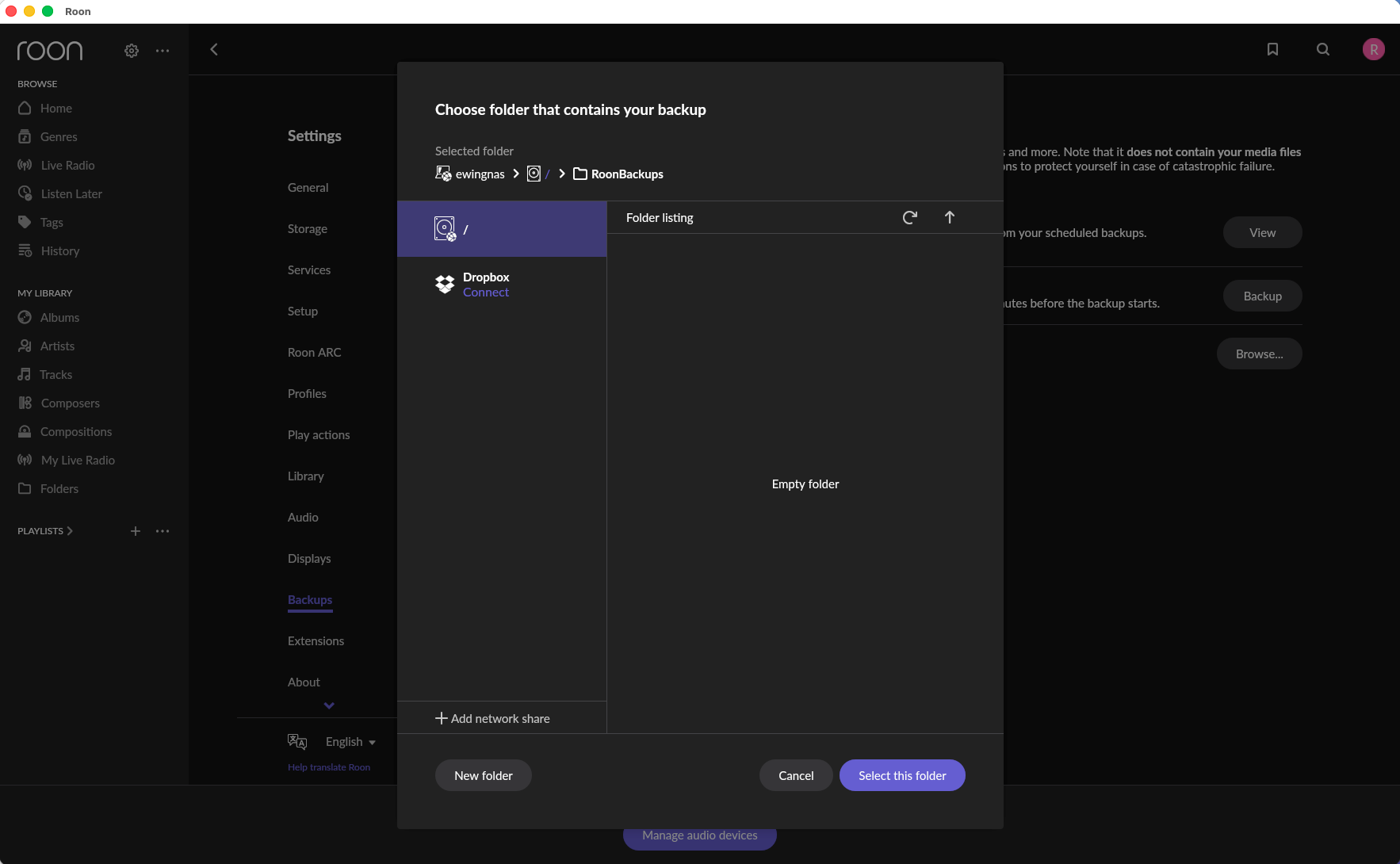

Thanks for writing in and for sharing your report! From a fresh Roon Server diagnostic report, we can see that every time Roon tries to enumerate backups from /RoonBackups, it throws a Critical NullReferenceException inside GetRestoreItems:
Critical: scx: System.NullReferenceException: Object reference not set to an instance of an object.
 at RoonBackup.Backups.GetRestoreItems(...)
This happens consistently; it’s not a transient error. Roon can see the /RoonBackups mount (it lists it in the file browser), but when it tries to actually read the backup structure inside it, the code crashes immediately.

What you currently have in FileStation is:
/RoonBackups/
 └── 084f10e3-0fb2-ba7d-faf3-0701931e2888/ ← just one folder
The NullReferenceException in GetRestoreItems is almost certainly triggered because backup.json is missing or the subfolder hierarchy is wrong. Roon reads backup.json to understand the backup set, and if it can’t find it, the object it tries to use is null.

Looking at your directory listings, we’ve found the exact culprit. In your old backup directory, there is a specific file called roon_backup_root. This file is the crucial marker that tells Roon, “this directory is the root of a valid backup location.”
In the FileStation screenshot you shared earlier, it looks like you only copied the inner GUID folder (084f10e3-0fb2-ba7d-faf3-0701931e2888) into your new /share/Container/roon-backups directory, leaving roon_backup_root and the other folders behind. Without that root marker file, Roon doesn’t recognize the directory as a backup destination, which triggers the NullReferenceException when it tries to scan it.

Once that is done, go to Settings → Backups → Find backups in the Roon app, browse to your mapped /RoonBackups folder, and your previous backups should immediately populate for a restore. Let us know how it goes!
Success! Your instructions were spot on and I am back up and running. One note…the Storage folders do not map directly from what they were in the old .qpkg app. You are offered a link to edit the folder to the new mapping which is fairly straightforward. Once all my folders were remapped (and didn’t need to do a full rescan), everything seems to now be working perfectly. So thank you again for getting me through this.
