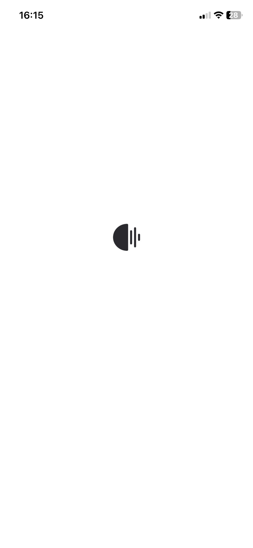

After reinstalling the server on my QNAP according to the new procedure (Docker/Container), the server is not reachable from any of my remote controllers (Windows, IOS, Android).
The server is reported as running in the NAS.
It is also normally seen from the remote controllers, but when you click to connect, a white window appears the the roon logo in the middle. And everything remains stuck. And this happens from any kind of remote.

Thanks for writing in and for sharing your report! Based on your description, this sounds like a Docker/Container deployment networking issue. The “stuck on Roon logo” symptom with a server that’s visible but won’t complete connection almost always points to the container not being on host networking mode, which Roon Server requires to communicate with remotes.
Here are the next troubleshooting steps:
1. Verify the container is using host networking, not bridge:
Roon Server requires host network mode in Docker/Container Station. Bridge mode lets the container start (so the NAS reports it “running” and remotes can discover it), but the data ports needed to complete the connection get blocked, producing exactly the white-window-with-logo hang.
  • In QNAP Container Station, check the container's network setting and confirm it's set to Host, not Bridge or NAT. If it's wrong, recreate/redeploy the container with host mode.
2. Confirm the data directory was mounted persistently If the container can't reach a writable, persistent database location it can stall on connect.
  • Verify the volume mapping points to a real share on the NAS and that the path has correct read/write permissions for the container.
3. Check that the container is actually bound to the NAS's LAN IP With host mode, the server should answer on the QNAP's Ethernet IP. -
  • From a remote, try connecting by entering the server's IP and port directly (the "Help"/manual connect option in the remote) rather than relying on auto-discovery.
4. Rule out leftover database conflicts If this is a fresh install but you pointed it at an old database folder, a version mismatch can cause it to hang. Confirm whether you migrated an existing database or started clean.
