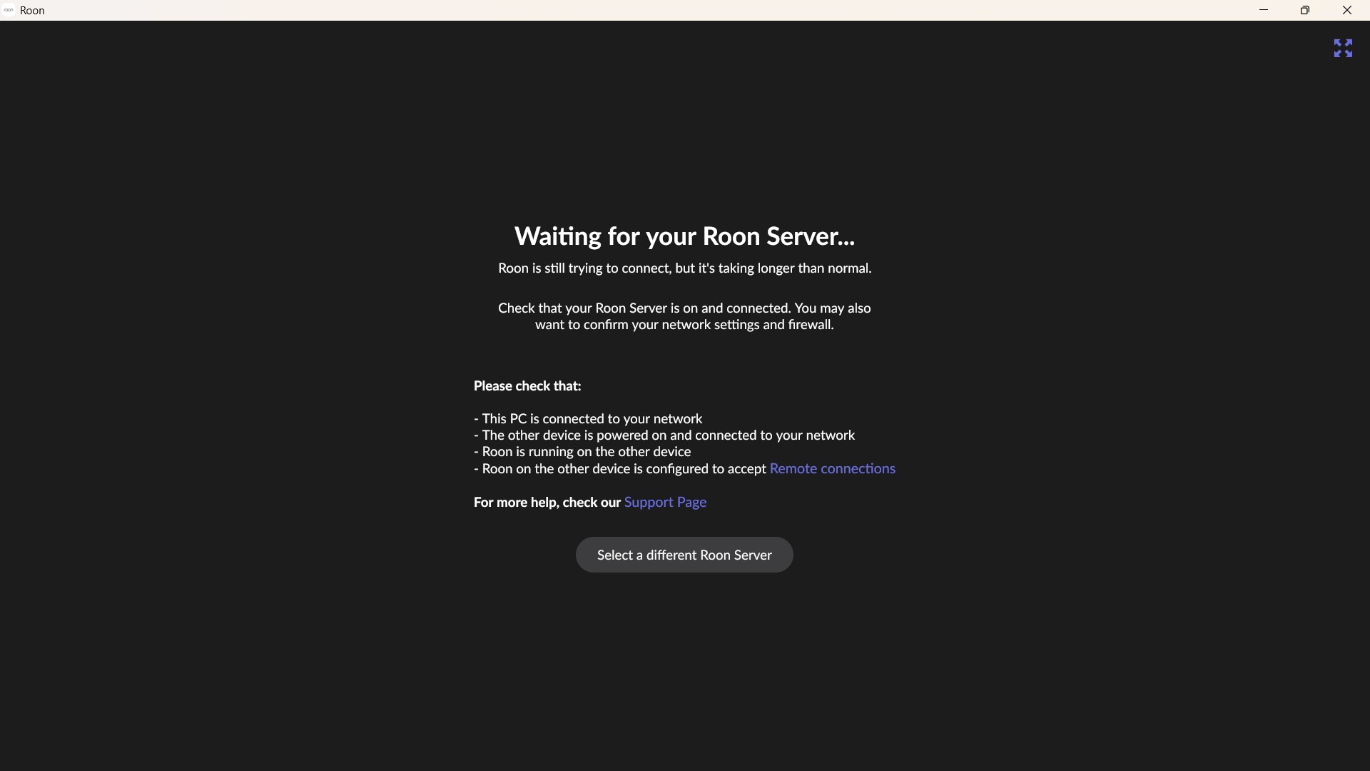

Since renewing a briefly expired Roon subscription, the Roon server status on my NAS is "stopped". There is no option to start it though the Roon server app on my QNAP NAS. My remotes are in continuous "Waiting for Roon Server..." status. There is no issue with my firewall and I do not run a VPN. I cannot manage Roon through the remote instances as they are stuck waiting for the server. Please help.
QNAP TV-471 hard-wired by ethernet to Asus ROG Rapture GT-BE98 Pro router. Roon remotes connect Home network by WiFi 6. Nothing has changed for several months. Was working perfectly until my subscription expired, then renewed.
