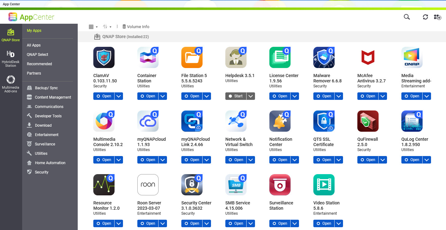

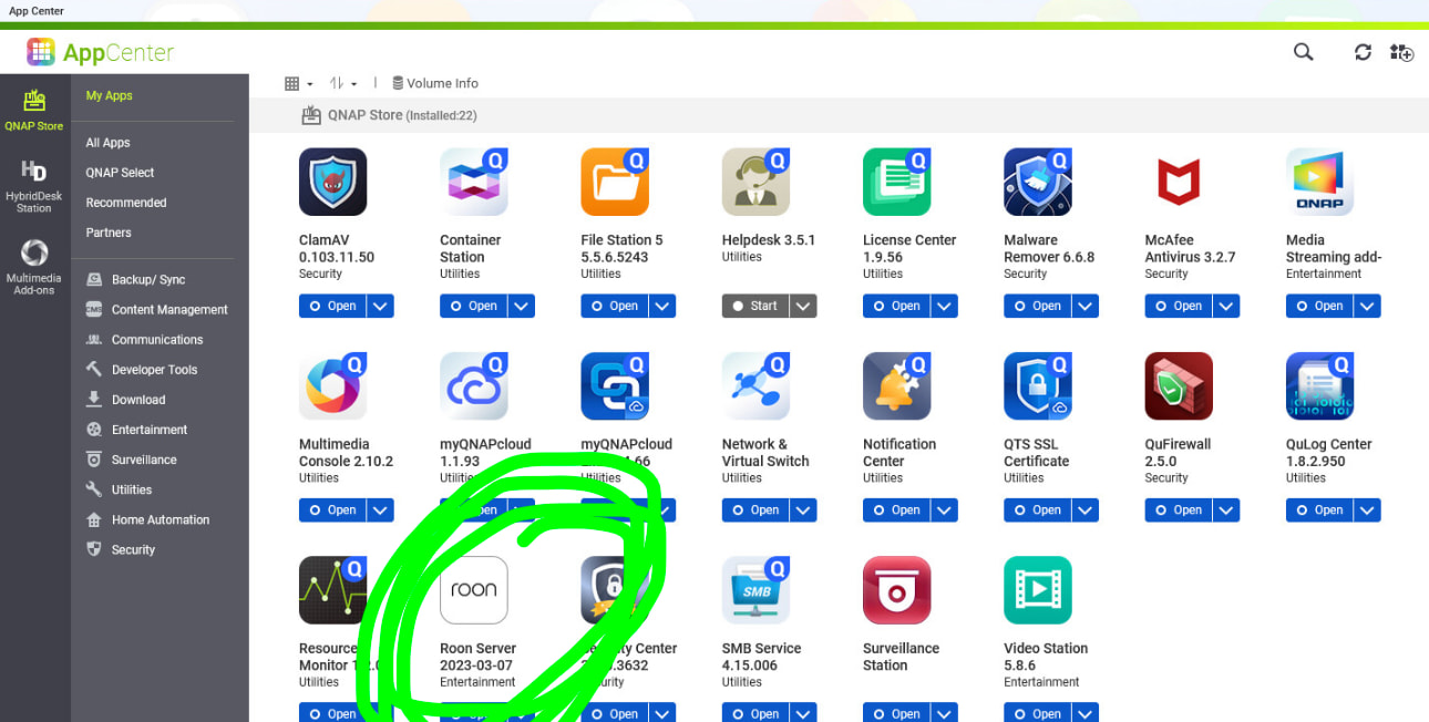

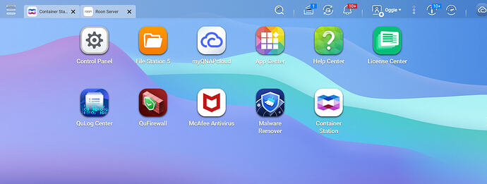

Hello - with the help of someone else, I am installing a QNAP Docker (https://help.roonlabs.com/portal/en/kb/articles/installing-roonserver-on-qnap-with-docker#Step_6_Connect_from_Roon_Remote) I have got stuck on section 6 because I don’t know what the ‘native QNAP application is’. I have attached photos below - is anyone able to help please?

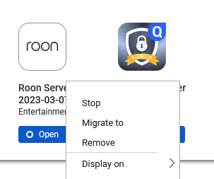

Progress! The native application is the one you ran so far.
Hello again! Yes I was doing well until this stage. How do I stop it as per the instruction?
Do I literally just press stop?
yes , select Stop option from the the right-click menu
Stop option will stop RoonServer (which is actually failing to start after the upgrade to 2.65 anyway) and disable it from even trying to automatically start again in the future; it is up to you if you want to remove it instead, or not; personally I preferred to do that after Roon was running fine in docker-container (just in case I wanted / needed something from the old install)

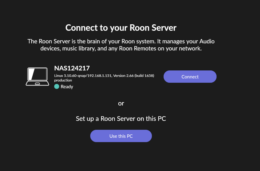

Thank you! I think I’ve done all of that now, but when I open Roon I get this:
Are you able to help with what I do next? I wasn’t prompted to select a different roon server
You are on a good track, I believe this happened to others and is not so hard to overcome IF one knows what has to be done :slight_smile: Unfortunately my missing experience with this topic gets in the way now and I have to leave it to others who surely will show up. (It’s the weekend now, so we will have to rely on volunteers until next week)
No problem at all - I appreciate everyone’s help! Thanks so much
it should be as simple as click connect and follow the steps - authenticate & deauthorize your old RoonServer instance so that the new one will be active instance (and user of the Roon License)
It worked!! Thank you all so much, I really appreciate the help.
