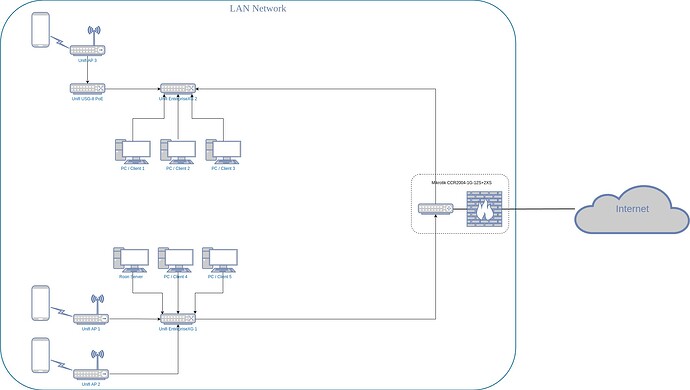

What is the network pathway serving RoonServer? Please list all L2/L3 components that sit between RoonServer, the internet, and your networked storage or endpoints.

Basic physical schematic of the network:
Firewall lets all out, nothing in. Very basic setup for now, IPv4 only.
