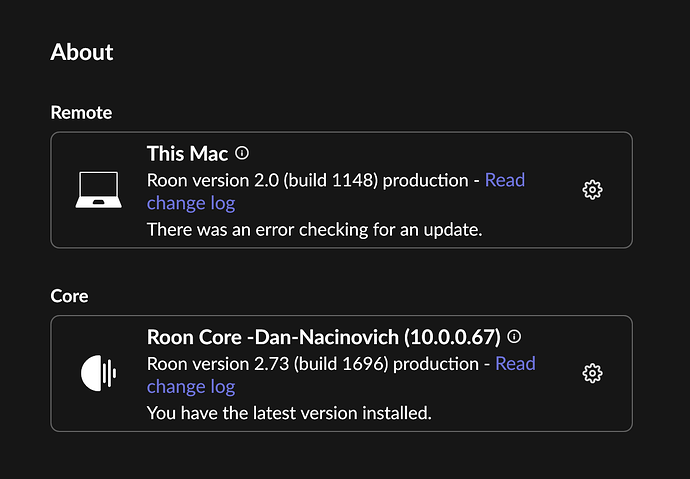

I just followed the steps ABOVE and tried to re-install, but it DOESN’T WORK … see screenshot below it’s still stuck on 1148. I can download logs again if it would help you? …
this is unreal how poor this entire Roon experience has devolved into can we accelerate the fix here?

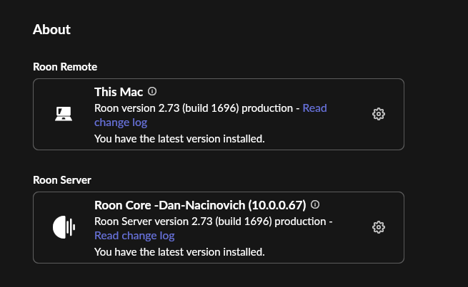

Hello @DNack
Your screenshot shows the Mac is connected to your Core, and the Core is healthy on the current build, 2.73 build 1696. What is left is that this Mac keeps opening an old copy of Roon.

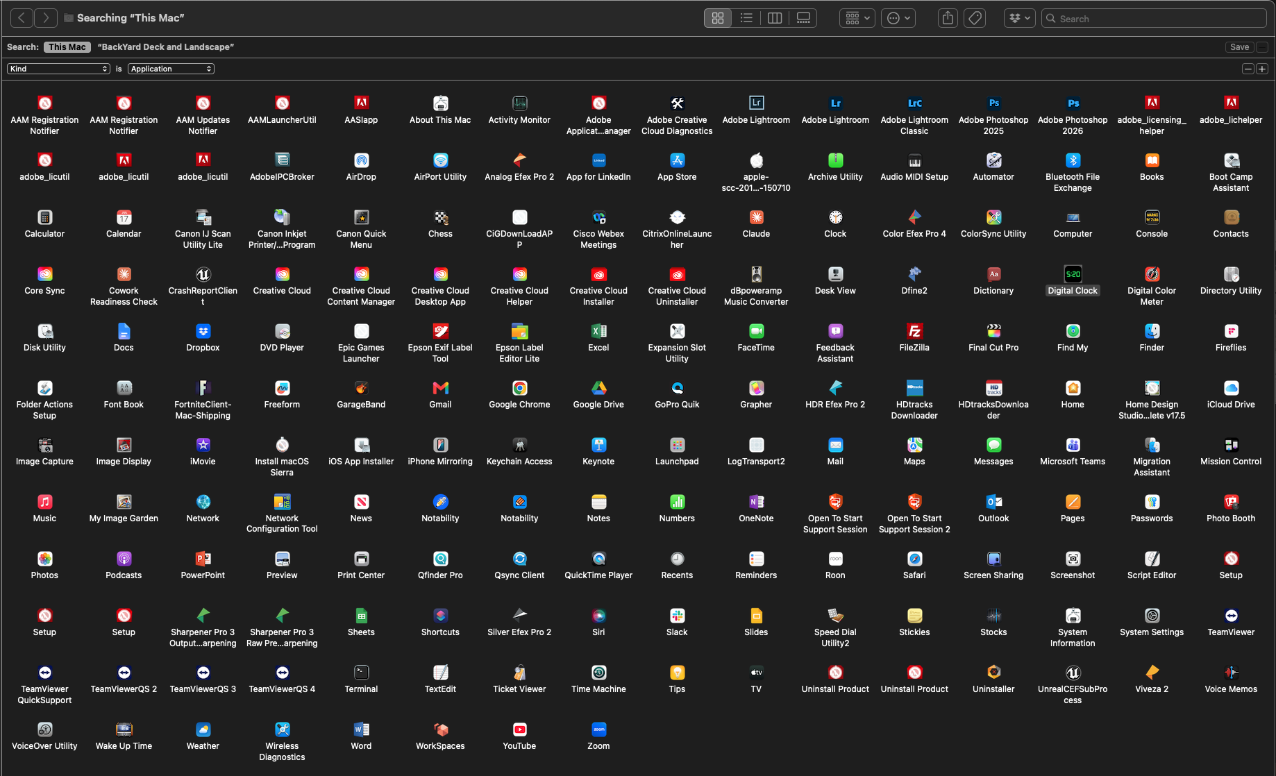

  2. Please open Finder and press Command and F. Type Roon, click “This Mac”, and set the “Kind” filter to “Application”. Please post a screenshot of the results before deleting anything, so we can see what is on the Mac.
  3. Please drag every Roon application it lists to the Trash, then empty the Trash. Remove them, not replace them.

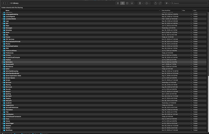

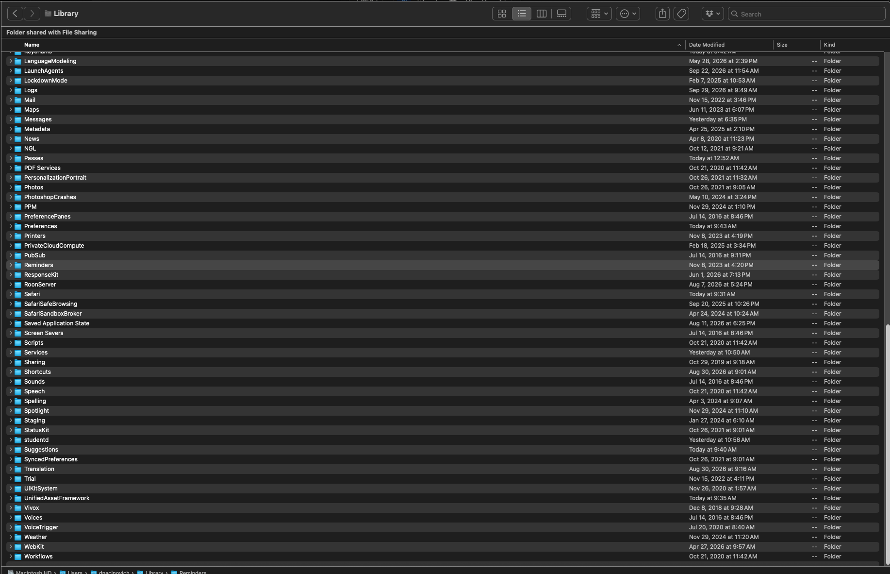

  4. In Finder, please press Shift, Command and G together, paste ~/Library and press Return. Please delete the folders named Roon and RAATServer if present.

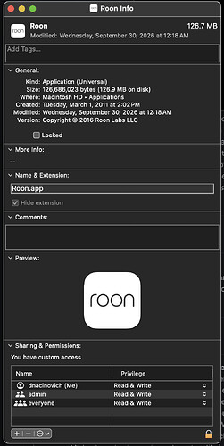

  8. Please download a fresh copy from https://download.roonlabs.net/builds/Roon.dmg.

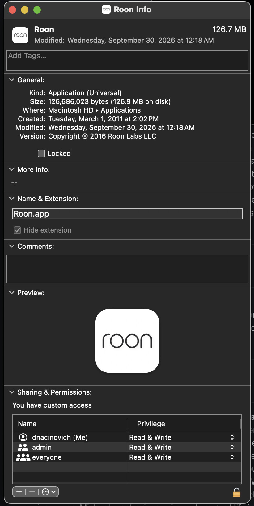

  9. Please open the image, drag Roon into Applications, then eject the image. Before opening Roon, please click it once in Applications, press Command and I, and post a screenshot of the Version line. If it does not say 2.73, please stop there and tell us.
  10. Please open Roon from the Applications folder, not from the Dock or the installer window, then go to Settings, About and post a screenshot.
Once the Mac reads 2.73 build 1696 we will come straight back to Roon ARC.
@lei @connor @vadim @BlackJack @beka @noris @benjamin here is the screen shot for #2 above. I also completed the remaining steps thru #10.
Screenshot after ‘Roon’ and ‘RAATServer’ deleted [proof]
Restarting Mac now, will continue post after just wanted to post progress thru #7
Screenshot for #9. Not sure if current also posted screen shot from Remote.
It appears the remote is now on the correct version. Please tell me if my additional remote iPads will need to go thru similar re-install process. This main iMac pro is my ‘main’ remote, but I have several other in wall iPads and floating remotes.

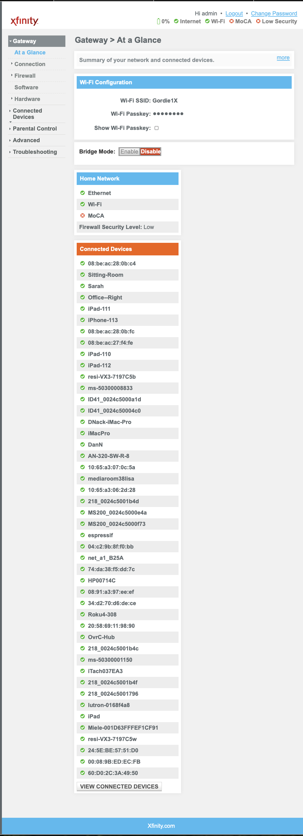

Xfinity gateway

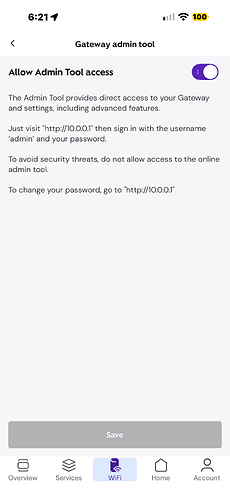

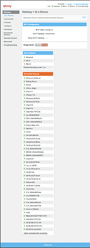

  1. Please check whether Bridge Mode is on. In a browser on your home network, open http://10.0.0.1, go to Gateway, then At a Glance, and post a screenshot. On newer gateways you first need to switch on Admin Tool access in the Xfinity app (WiFi, View WiFi equipment, Advanced settings, Admin Tool online access), and the login is admin with the password you create there: https://www.xfinity.com/support/articles/admin-tool-access

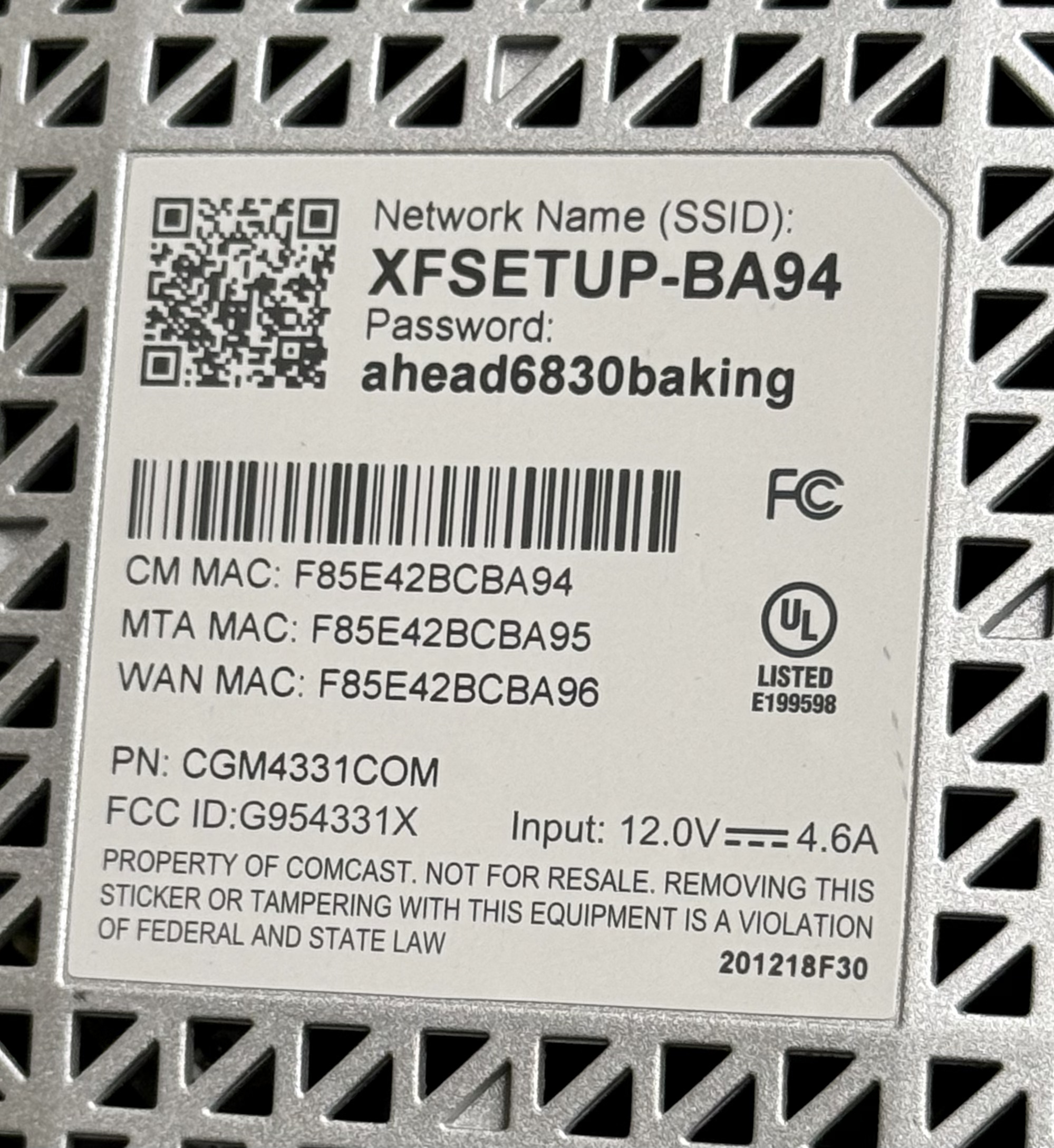

@vadim & co … please see attached screenshots, what else do you need? I really don’t want to create a security breach so can you download and then anonymize or delete these screen shots? What else will you need?

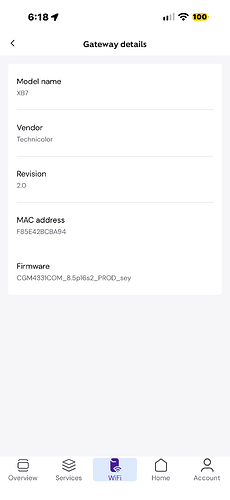

Hello @DNack,
Thank you for the screenshots. We have hidden the photo of the label on the bottom of your gateway, because it shows the default Wi-Fi name and password. If you still use that password for any Wi-Fi network, please change it.
From the other screenshots we can see that your gateway is an Xfinity XB7 and that Bridge Mode is off, so the gateway is doing the routing. We still need the following:
