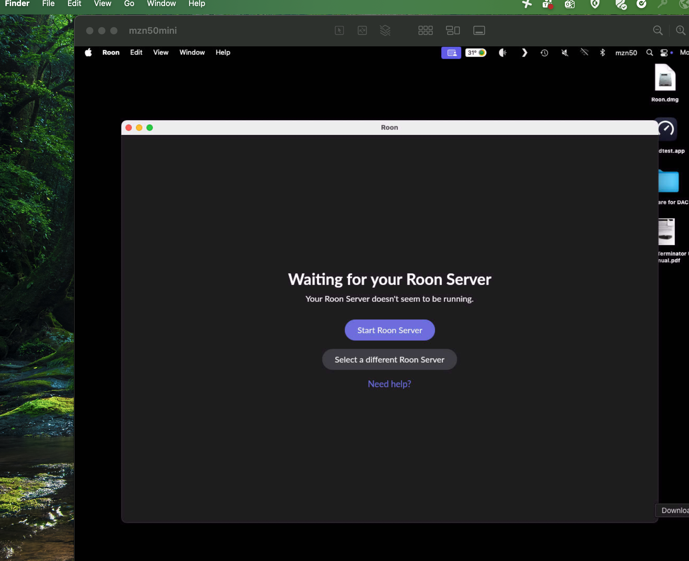

· Roon is working on my devices however on my server screen Roon shows "Waiting for Roon Server....." … this happens on every Server restart (MAC)
I reinstalled Roon…
I have to quit Roon APP and restart and all is fine… again .. I get that screen on my Mac.. but all my endpoits are running roon fine ..
· TPLINK Mesh system BE11000, Server is plugged in direct in Mesh Endpoint

Hello Carl and thanks for the response
I did confirm that privacy setting… And all was in order
What I didn’t notice was I had both of the Room server app and Roon app itself both in Launch mode at login… i deleted the roon app and only the Roon Server is in the User Launch… I believe that may have been a conflict?
In any case, I’ve tried it a couple of times and rebooted, and that issue is not showing up so I beleive launching the Roon.app was the culprit .. However, I will keep monitoring…
thanks again,
Matt
