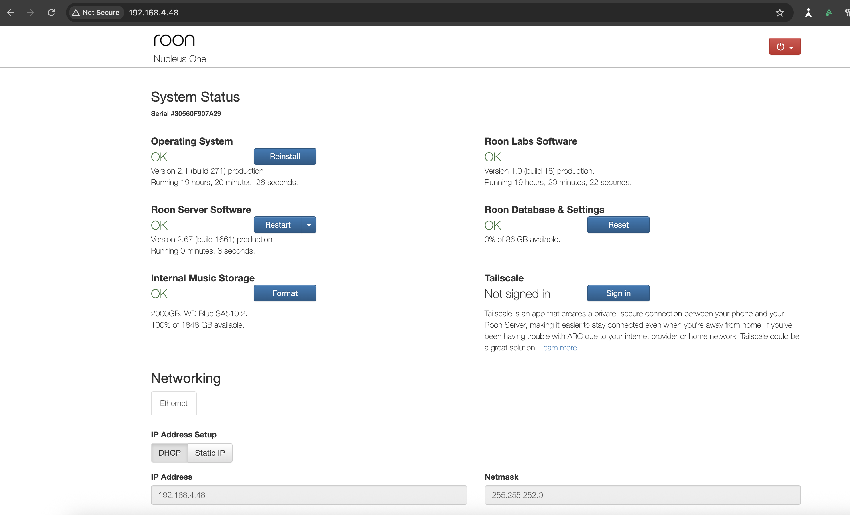

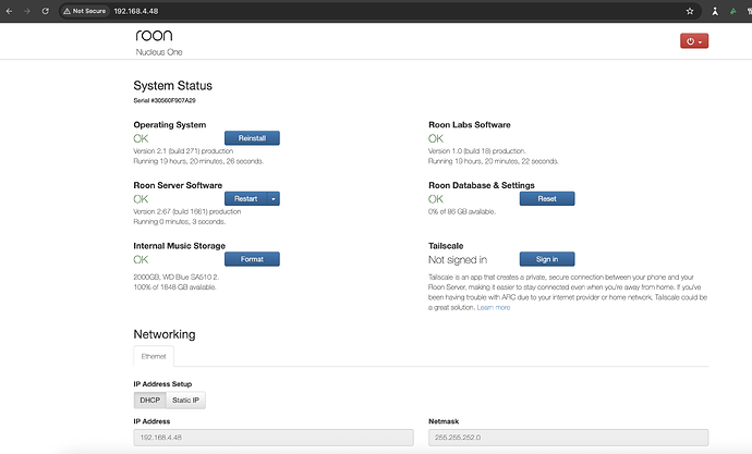

Our diagnostic servers indicate that RoonOS is active and running on this machine, but the Roon Server instance itself hasn’t been seen in over a week.
Can you please share a screenshot of the Nucleus web admin page, if you’re able to reach it from a browser?
If you’re not able to reach the web admin, what do you see when you connect the HDMI output of the unit to a TV or monitor?
The reason why you don’t see the Server instance online is because it reboots every 20 seconds. The it shows offline for 1-2 seconds, then running again for 20 seconds
Hey @Stefan_Zorn,
Thanks for the update and screenshot. It would be good to attempt to review a set of manual Roon Server logs from the Nucleus. I’ll share steps on how to gather and share them with us below:
