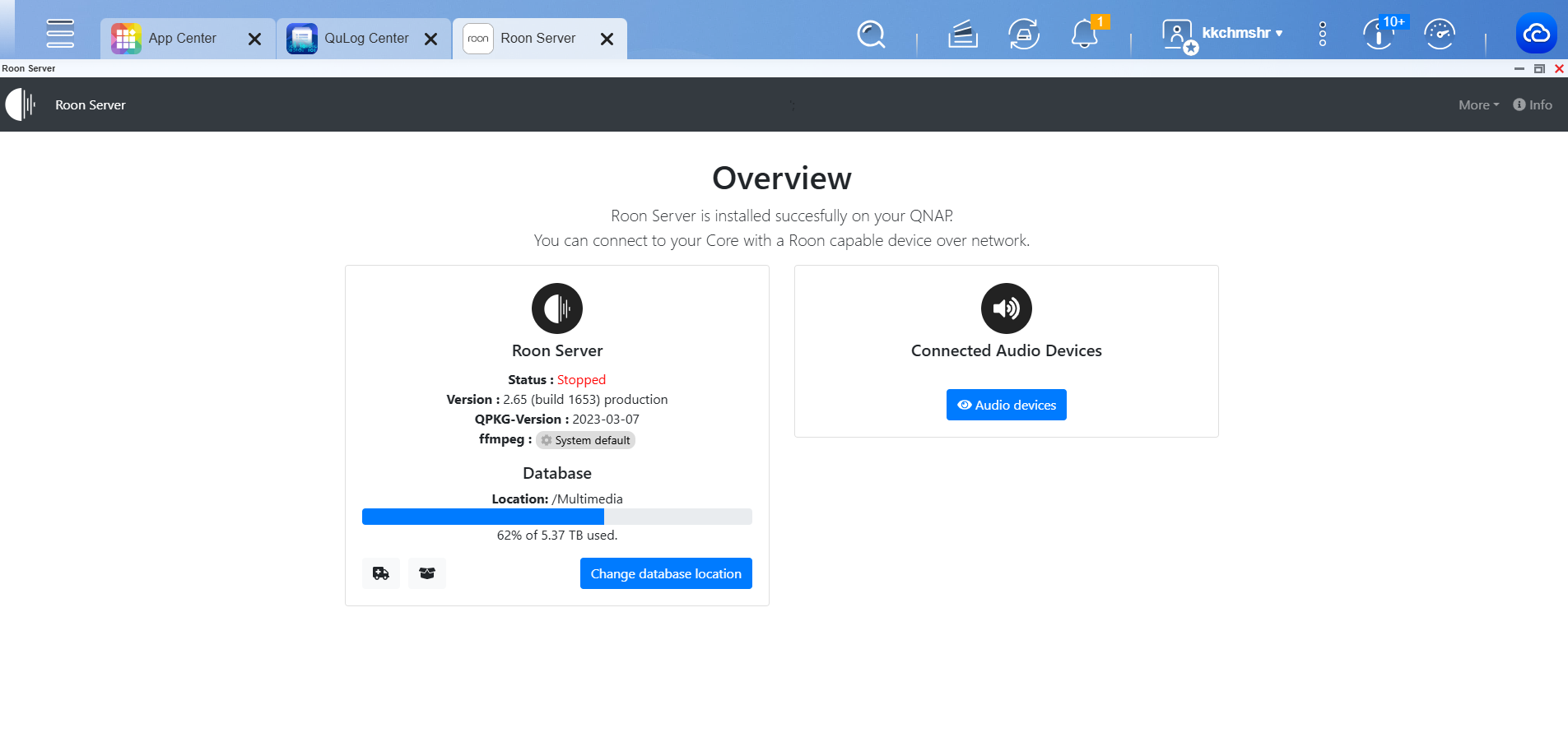

Tell us what's going on · My Roon Server has been stopped two hours ago after update. The Server was running directly on QuTS hero QNAP TS-h886, not on Docker.
Tell us about your home network · My Roon Server has been stopped two hours ago after update. The Server was running directly on QuTS hero QNAP TS-h886, not on Docker.
Then you should probably switch to the new docker based installation. See also-.

Thank you for the advice.
But Docker based installation is too difficult for me.
Maybe I should migrate to a NUC-based setup.

Hello @Masahiro_Kikuchi ,
Thanks for reaching out. Yes, with the new requirements, you’ll unfortunately have to run Roon in Docker moving forward. We’ve tried to simplify the installation procedure as much as possible and have created a guide with screenshots. Please take a look, perhaps you’ll not find it as difficult after reviewing the information:
Thank you everyone.
I have completed Docker based installation successfully and play music confortably!
It seems to be running faster now
