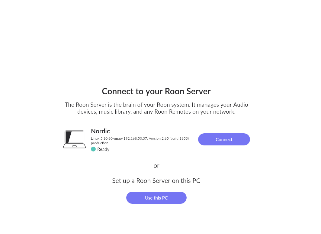

Now, after this screen, nothing happens, eternal loading… I uninstalled Roon Agent, Installed again, same result. It sees the server, but after connecting - nothing happens. No choice to revoke license anywhere.

Hello @Vladimir_Grayvoronsk
Thank you for the update and the screenshot. The “eternal loading” screen usually points to one of two things: either a network port conflict (where two Roon Servers are running simultaneously and fighting for the same connection) or a database permissions issue (where the new container is struggling to read data from the old installation).
To help us untangle this and get you past the loading screen, could you please clarify a few details about your setup process?
  1. Native App Status: Did you completely stop and uninstall the old native Roon Server package via the QNAP App Center? What is its current status right now?
  2. Folder Mapping: When you set up the Docker container, did you map the /Roon volume to a completely new and empty folder on your NAS, or did you point it directly to the existing folder where your old native database was stored? (Note: Pointing the new container directly to the old database folder without using the official “Restore from backup” method is the most common cause of the infinite loading loop).
  3. Sequence of Events: Could you briefly outline the exact order of actions you took during the installation? (e.g., Did you stop the native app before or after deploying the container?)
  4. Container Status: What is the current status of the Roon container inside the QNAP Container Station? Does it show as steadily “Running,” or is it restarting itself?
Once we have a clearer picture of how the folders and apps are currently interacting, we can provide the exact steps to clear the conflict and get you logged in. Standing by for your reply!

Hey @Vladimir_Grayvoronsk,
Thanks for the update! A fresh Roon Server diagnostic report shows us that when you switched from the native QNAP Roon Server app to Docker, Roon’s licensing server saw two different machine IDs claiming to be the same server “Nordic”.
The logs show the Docker server hitting NeedsBump status on every startup — meaning Roon’s cloud sees a conflict and won’t license the new machine until the old one is bumped off. The good news: this eventually did resolve itself (the logs confirm MachineStatus=Licensed was achieved), meaning the server itself is actually running fine and licensed.
The problem you’re experiencing, the infinite loading screen when connecting, is a separate client-side issue, most likely caused by the Roon remote app (on your PC/phone) still trying to connect with stale session data from the old native app instance.
Let’s first fully remove Roon from your remote devices. For windows:
  • Exit out of Roon
  • Find the folder that says “Roon”
  • Rename the “Roon” folder to “Roon_old”
  • Verify if the issue persists on a fresh database before restoring the backup
If you’re still stuck at loading, lets try deauthorizing via the Roon web account portal.
  • Go to https://account.roonlabs.com and log in with
  • Navigate to Machines / Devices
  • You should see both the old machine ID and the Docker one listed under "Nordic" deauthorize the old native app machine (2c17bbde...)
  • This forces a clean slate for your license
Let me know know how this goes! 🙏
