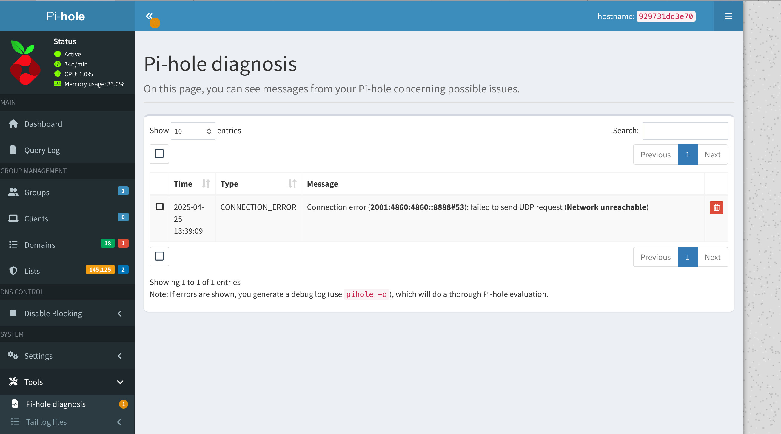

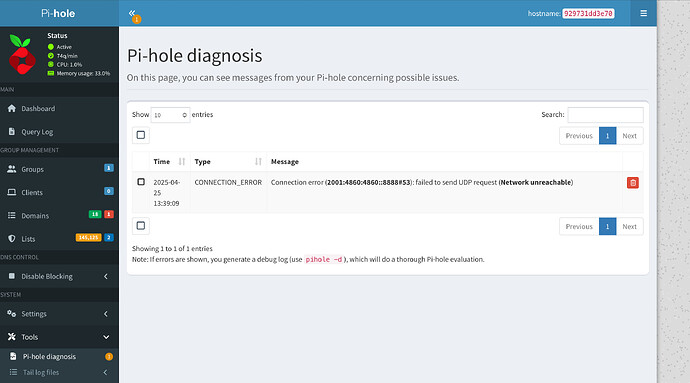

I’m also using PiHole for ad blocking in my network which blocks connections to ad networks. I turned off the ad blocking and tried the update and still didn’t work. However I got this error message and I’m thinking it might be related to the problem. Also, are their specific URLs that you could share for updating? I could try white listing them on the PiHole. I should add that with the exception of the managed switch, my network set up has been the same for a long time and I’ve had no problems with Roon updates. There also doesn’t seem to be a problem with any Roon client updates.
