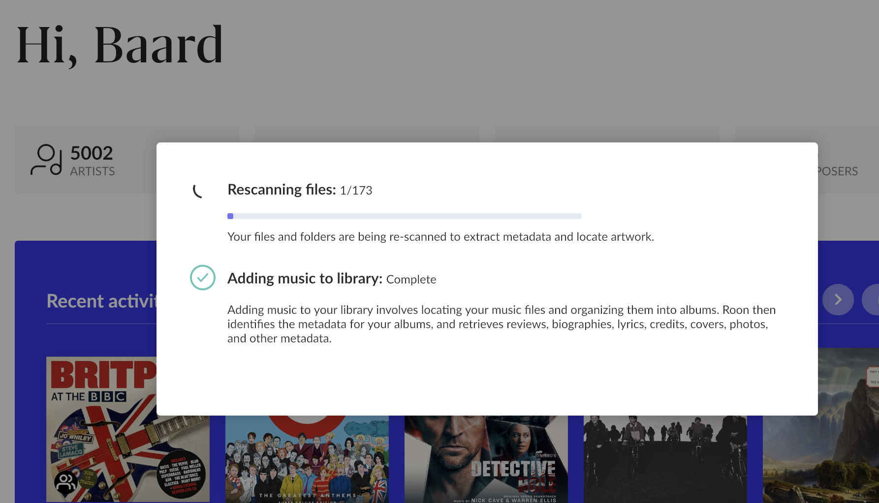

I am experiencing an issue where my Roon Server is permanently stuck on the message Rescanning files: 1/173. "Adding music to library" shows as Complete.

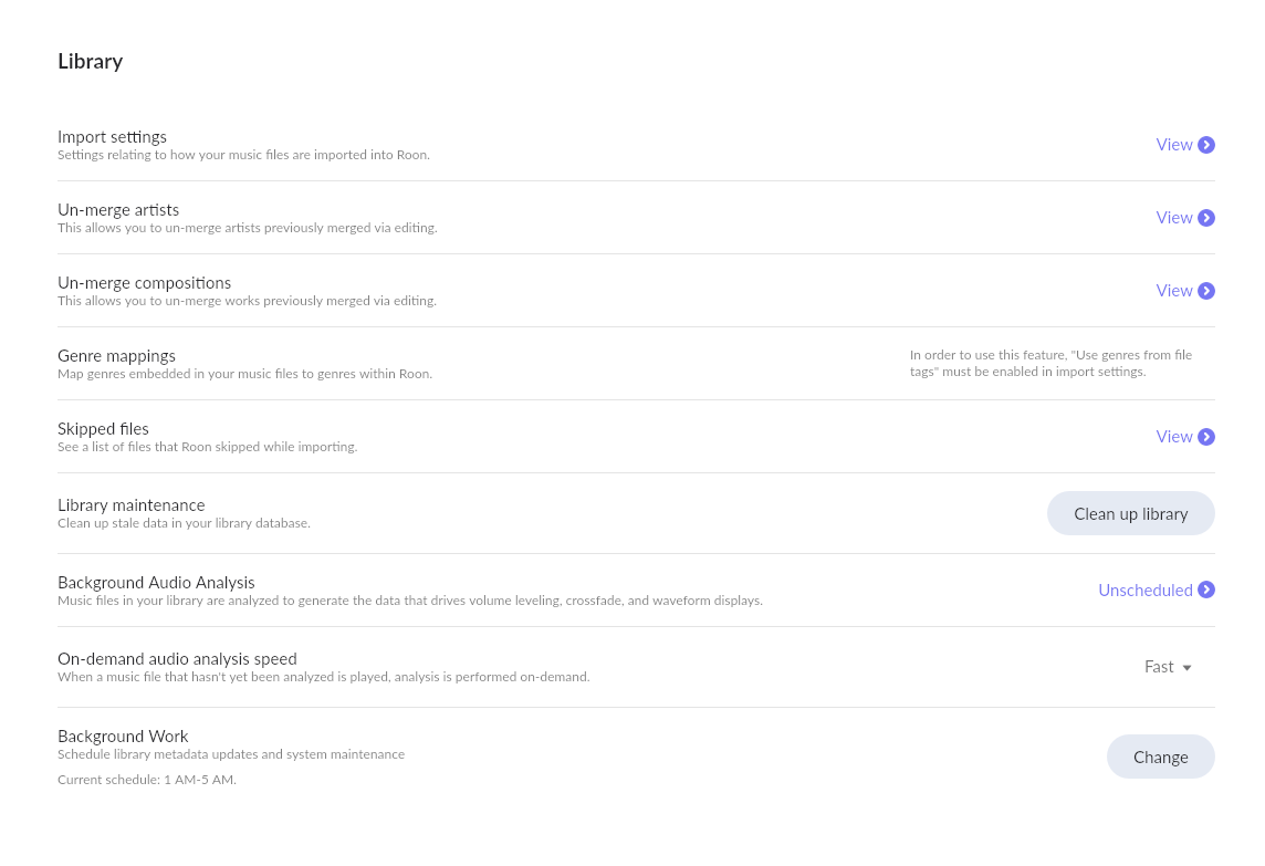

Can you share a screenshot of your Settings → Library page? It could also mean that Roon’s struggling to ingest artwork, analyze waveforms, or work through some custom file tags. There’s a /variousartists folder in logs that appears to host a compilation album named Britpop, The Greatest Anthems that Roon is repeatedly analyzing.
Try turning On-Demand Audio Analysis to “Off,” Background Audio Analysis to “scheduled,” and then restarting RoonServer. Do you still see this rescanning occurring after startup?

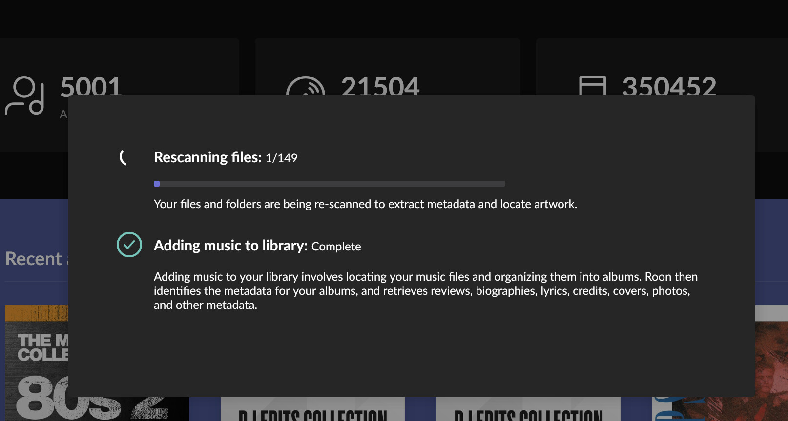

After changing the settings you recommended and removing the Britpop album, the rescanning still continues. Now 1/149.
