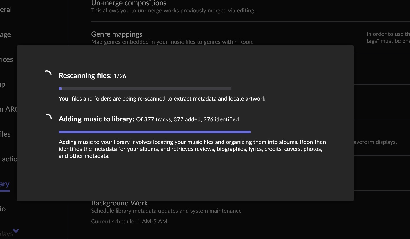

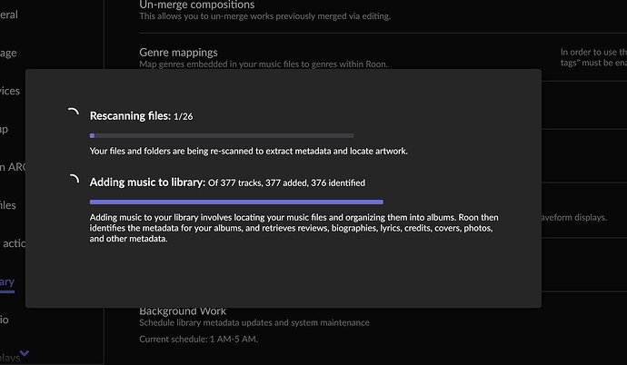

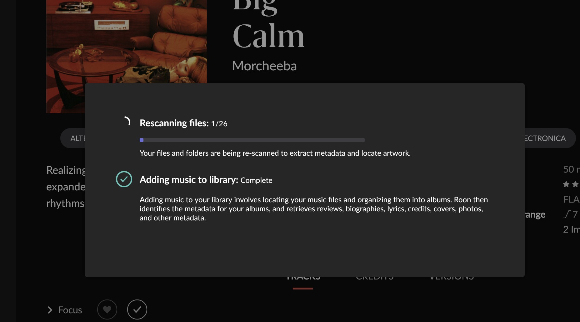

Just noticed today that my Roon server gets stuck on “Rescanning files.” It says it is rescanning four files to update the metadata, but it gets stuck on file 1 and the scan indicator keeps spinning all day. This is probably due to a corrupted file, but there is nowhere to see which file it is getting stuck on.
Note I was also accessing the metadata of the same share disc to day to update some comments section. I don’t know if this affected but checking log files I’vent found any “CorruptFile”, “ErrorCorrupt”

I moved some files (letter B titles to folder B ) in other folder to see if I could find a file with issue and I got this:
Keeps looping and haven’t found the track yet because so many titles, dont understand well the log file to see the one causing the error.

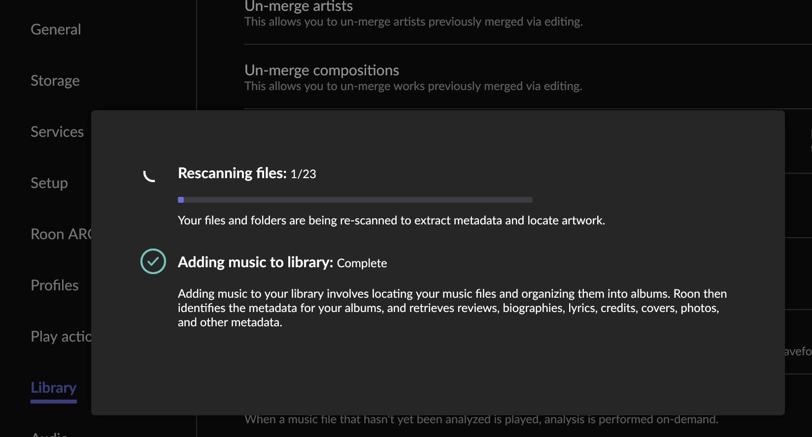

I’ve deleted the file as well as other similar types. I’ve rebooted the server, and the loop started again:
Hi @Moy,
It’s normal for Roon to re-scan your file locations upon restart to monitor for changes to the files contained therein. As long as the re-scan eventually completes (and doesn’t return outside of your scheduled network storage re-scan hours), then this is expected behavior.
