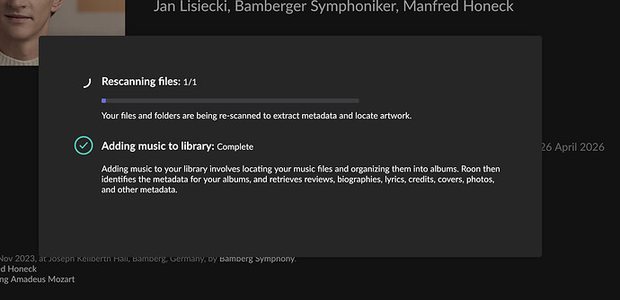

I have rebooted the server. A quick update:
  • about a day after I posted the issue the rescanning stopped.
  • after reboot, I can see Roon continuing to rescan and having an issue. Please see attached image:
