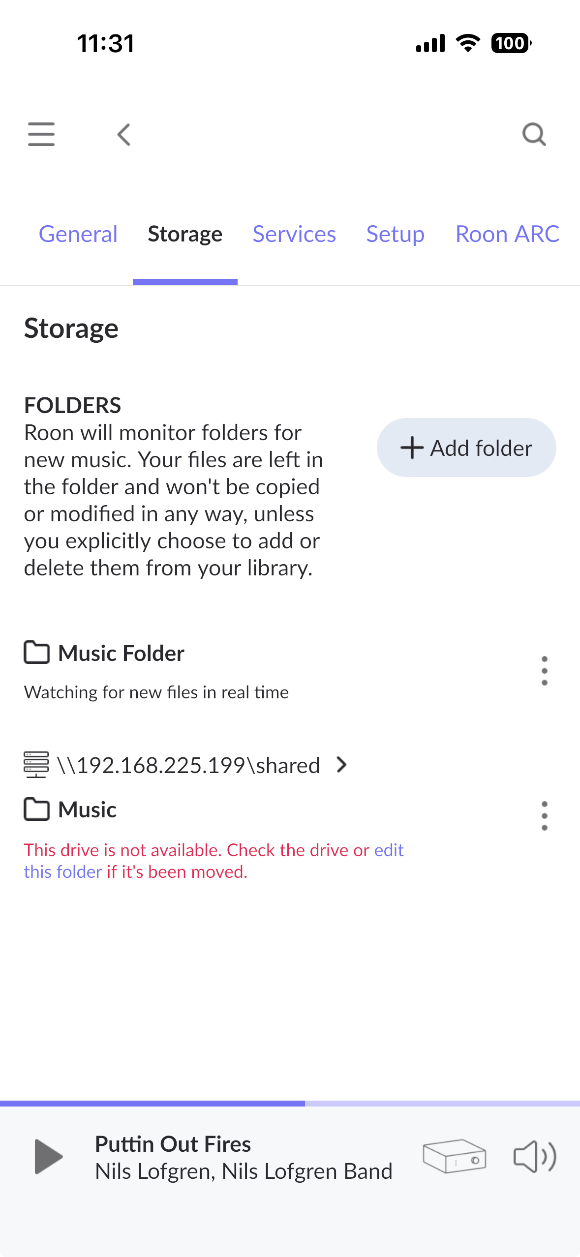

I am working on learning about Roon so I can setup one of my clients with it. She is not technically oriented so I am trying to make it easy. As part of the process I am using my laptop as the Roon server at our office which works and I added our Bluesound Vault as a NAS drive which worked intially, but now a day later it indicates the drive is not available and after rebooting both my laptop and the Vault the problem persists. It did find around 10000 tracks when initially set up, but as mentioned now shows as unavailable. I can access the Vault by typing the IP address into a browser without issue. Any help would be appreciated.

Thanks for reaching out to us about this issue. Is it possible that the IP address for the vault has changed? Some routers dynamically assign IP addresses. Also are there any network switches between the Roon server and the router or between the vault and the router? If so what is the make and model of them?
I have the Vault IP as static currently and I can type the address into a browser and the Vault pops up. There are a bunch of switches in our office system. Most of them are Cisco.
I hooked up my laptop which is the core directly to the same network switch as the vault and it still is unavailable. Leaning towards giving up.
