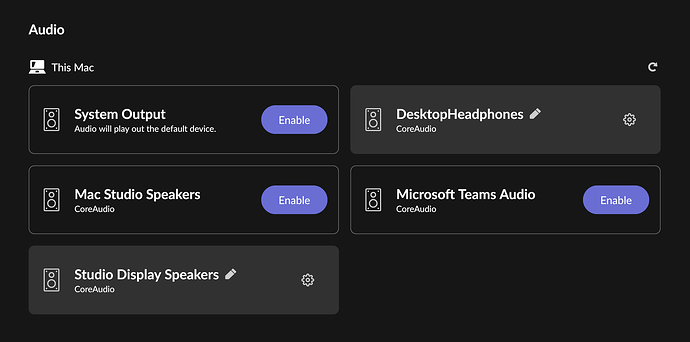

I have a Roon-ready Denon AVR (VR-S670H), which my Roon server has seen in the past, but which occasionally disappears from the list of available audio outputs:

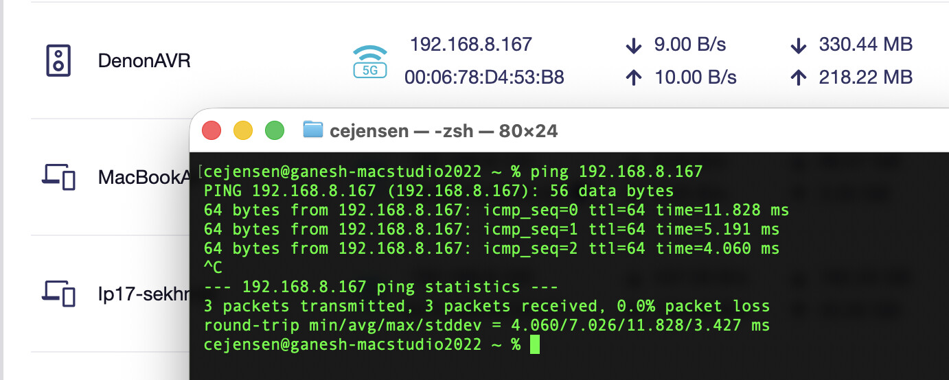

This is the list at the moment, with no Denon in sight. As I said, in the past I have sometimes seen, and sent audio to, my Denon, but today is one of those days it just doesn’t show up. From my Mac I can see that the Denon is connected to my router, and I can ping it:
…but my Roon Server doesn’t see it.
I found a thread here a while ago that advised deleting and recreating my RAATServer directory, which has worked a few times to get my AVR to reappear on the Roon Server, but lately that has stopped working.
Any suggestions to get Roon to see my powered-on, ping-able, Roon Ready(?) AVR?
