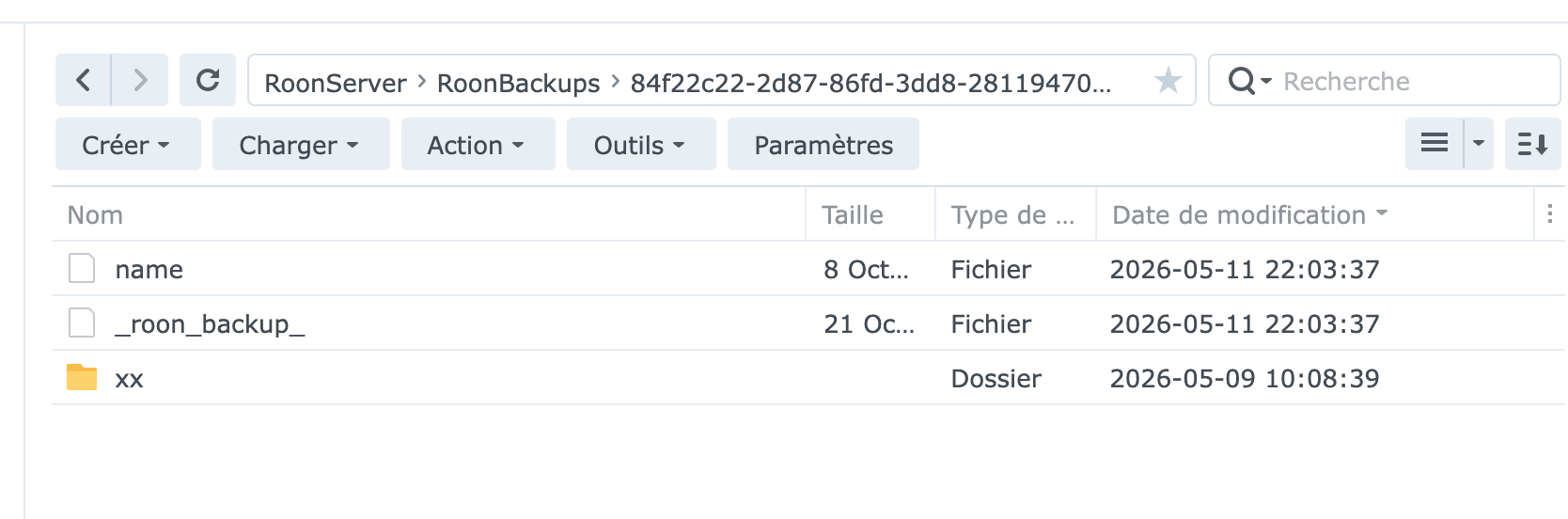

The roonserver user’s permissions are correct (read and write), and the paths are correct (local paths—no network paths for backups). My backups are then saved to a cloud via Synology Hyperbackup.
No DSM update
As you can see in the screenshot, Roon started writing folders and files to the folder designated for backups, but the process was interrupted. The read and write permissions are therefore correct.
