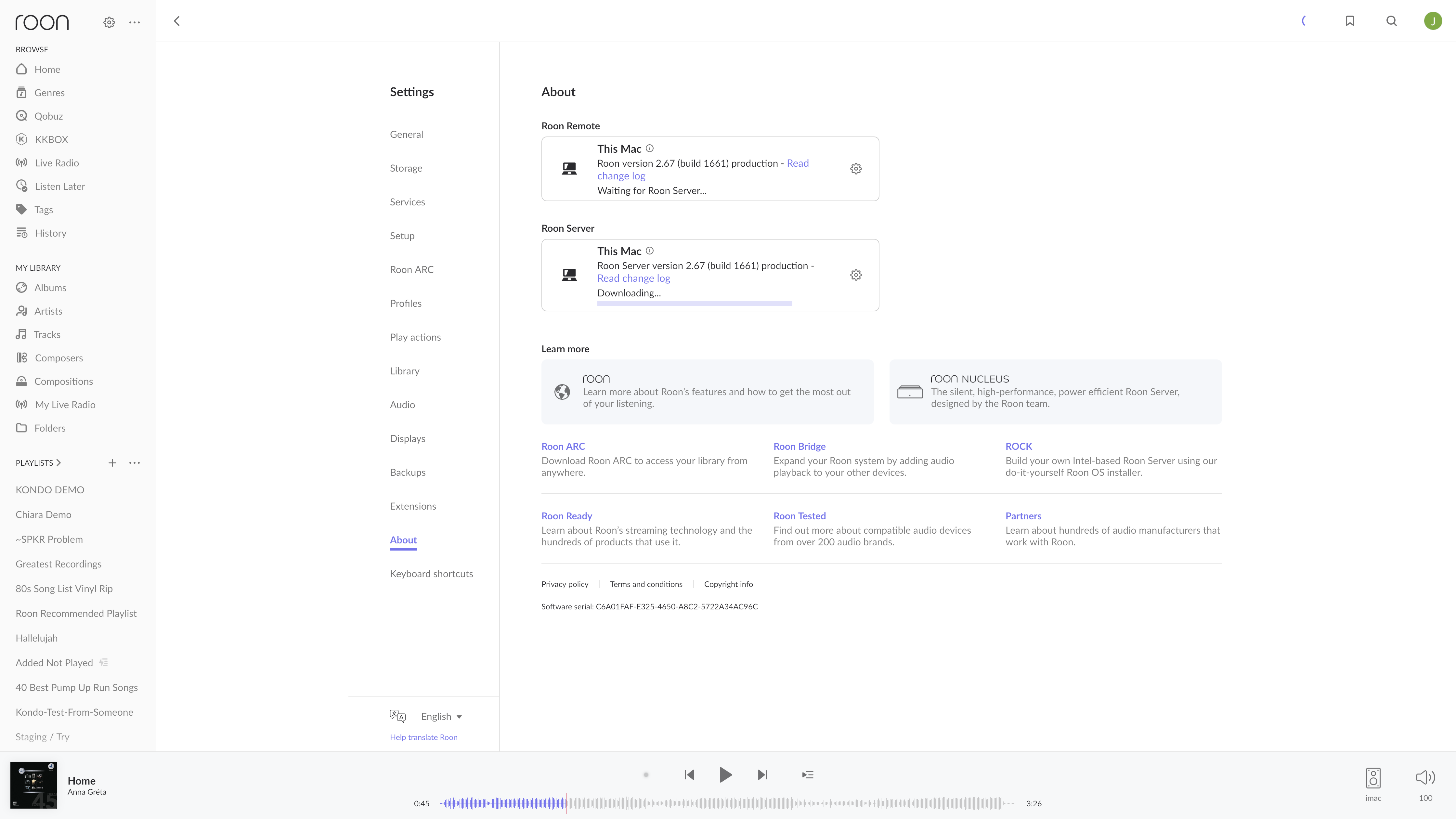

· I am having trouble updating my Roon Server running on iMac. Roon server keeps getting stuck on "Downloading" status but never completes the update. Tried multiple times with rebooting of machine.
A Roon client running on a Macbook Pro was able to finish the update successfully.
Server Configuration:
Hardware: iMac M4 with 16GB RAM
MacOS: Sequoia 15.6.1
Network: Wired 1GBps Ethernet
Current Roon Version: 2.6.7 (build 1661)
· Router TP-Link Archer ax6000
