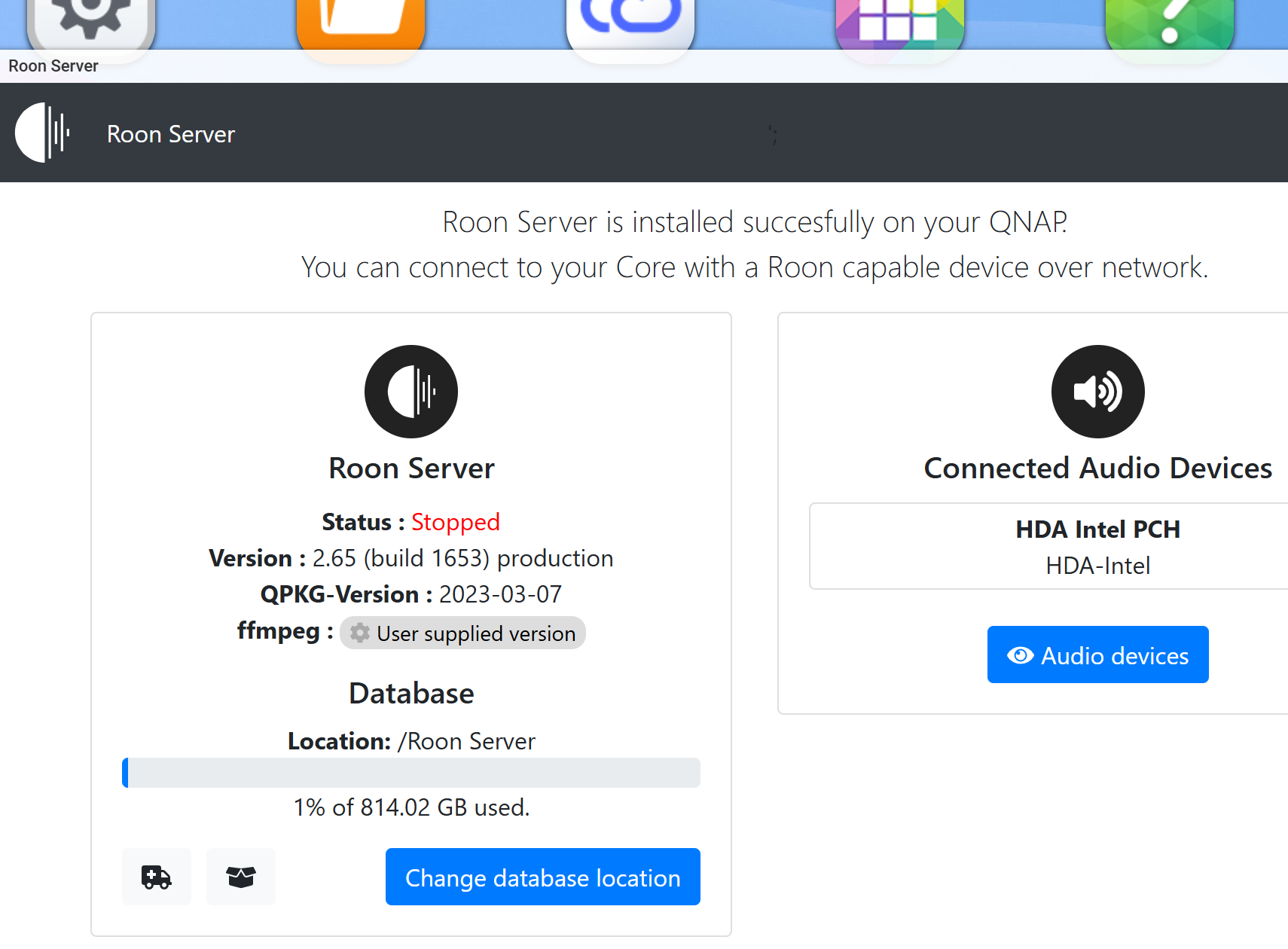

Roon was working normally, then I installed the 26/04/26 update today & since then Roon server will not start. Installed on QNAP NAS TS-253D on seperate dual 1TB SSD drives. I have restarted the NAS a number of times and started & stopped Roon but server will not start. I then uninstalled the Roon app and re-installed, still the app will not start.
QNAP TS-235D NAS with 16GB memory, running dual 4TB SATA drives, with Roon server running on dual 1TB SSD.
The Roon Server package no longer works, please switch to the official Docker image to run Roon Server on your NAS. See also:

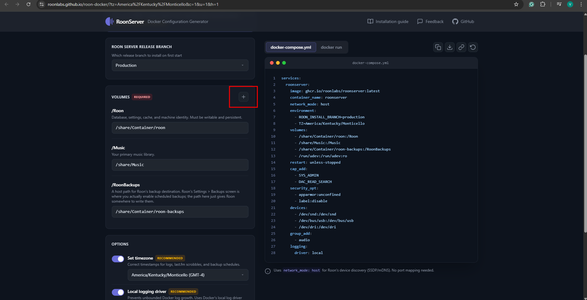

Since the container operates in an isolated environment, it can only access folders that have been specifically “mounted” during the setup. If your music library is spread across multiple drives on your QNAP, you’ll need to add each of those paths to the container configuration.
To help you get everything visible in Roon, could you please provide:
  1. Your Docker Compose file: Please paste the YAML code you used for the installation. This will show us which volumes are currently being mapped to the container.
  2. Music Locations: Where exactly is your music stored on the NAS? For example, is it on /share/<folder>/Music or spread across different volumes like /share/ExternalDrive?
Tip for adding more folders: If you look at our Docker Configuration Generator, you can use the “+” button in the Volumes section (as shown in the screenshot below) to add as many additional paths as you need. Each path on your NAS can be mapped to a folder inside the container so that Roon can scan it.
Once you share your current configuration and the actual paths of your music, we can provide the exact lines you need to add to your setup.

Hello @CmJ,
Apologies for the confusion there—it looks like we jumped the gun on closing this! Finding the absolute path using PuTTY was the hardest part, but you still need to apply that path to your Docker configuration to actually get Roon to see your music.
Here is how to update your yaml configuration to link that specific folder:
1. Update the Music Path
  1. Open Container Station and edit your Roon Server application.
  2. Locate the volumes: section in your yaml code.
  3. You need to replace the generic music path with the absolute path you just found.
Change this line: - /share/Music:/Music
To this exactly: - /share/CACHEDEV1_DATA/Multimedia/MusicRoonServer:/Music
  1. Save the changes and recreate or restart the Roon container so the new configuration applies.
  2. It should be automatically added as your watched folder. If not, open your Roon Remote app, navigate to Settings > Storage > Add Folder, and select the folder simply named /Music.
Because of the mapping you just created, Roon will look inside that /Music container folder and see everything inside your QNAP’s Multimedia/MusicRoonServer directory.
2. Performance Tip: Moving the Database to your SSDs I noticed you mentioned having dual 1TB SSDs for your Roon Server. If your current Docker database folder (/share/Container/roon) was accidentally created on your mechanical HDDs during the initial Container Station setup, you can easily migrate it to the SSDs for significantly better performance.
To do this:
  1. Stop the Roon Server container in Container Station.
  2. Open the QNAP File Station app.
  3. Locate your roon database folder and move it completely from the HDD volume to a shared folder on your SSD volume.
  4. Go back to your yaml configuration in Container Station.
  5. Update the left side of the database mapping (- /share/Container/roon:/Roon) to match the new absolute path on your SSD volume.
  6. Start the container. Roon will boot up using the fast SSD storage.
I hope this gets your library scanning successfully and ensures your database runs at top speed.
