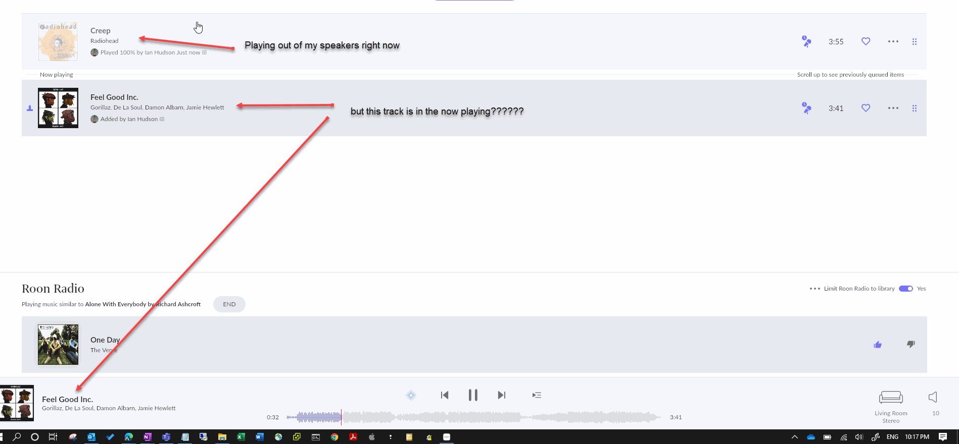

Roon show the wrong song on the now playing.....see picture for explanation
Roon Core Machine
Intel NUC 11, ubuntu latest version
NUC is wired directly to router
sonos play 5
Number of Tracks in Library
about 14000
see the picture I attached - I’ve seen this a few times now

It actually just happened again. here’s the situation:
  • I have a filter that shows all my local music. I went to that and hit shuffle just to get random tunes from my entire local library. (I do that all the time)
  • It stared playing fine, and about 33 songs in, I looked at the now playing, and it was showing the next song in the queue as what was playing…
  • I paused playback and left it for a hour or so (got some calls)
  • when I resumed playback, it continued not from where the last song ended off, but from the point of the now playing screen, so things look fine again…

also, it just happened again. It seems like the now playing can’t keep up with what is playing, It slowly starts to lag behind. For example the next song starts playing through the speakers, but the now playing shows there is 15 seconds left of the previous song…hope that makes sense.

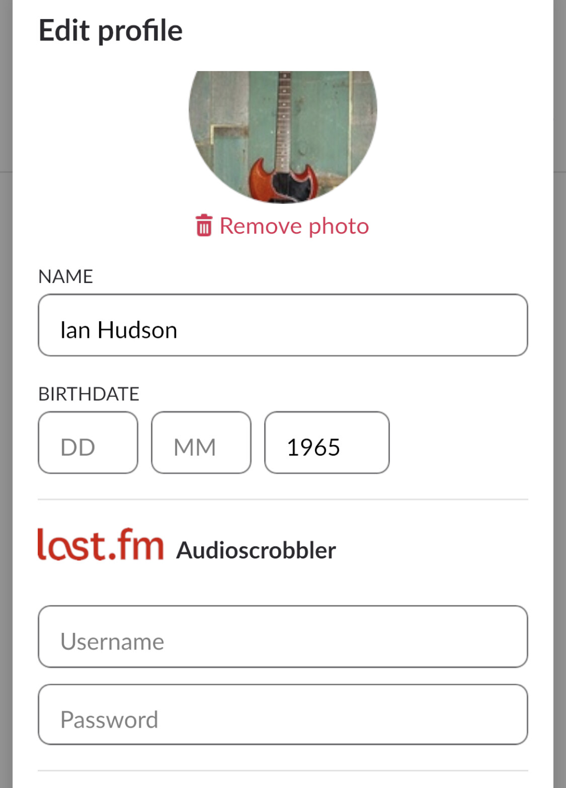

Thanks for the reply. Last’fm huh? I wonder where that is coming from? I do not use it.
How can I turn that off?
I’ll check the router for bridge mode and I may change DNS but I ran a test on that a whike back and it said my DNS settings were optional.
Anyway, good to get some details to dive into. I’ll report back……
Wait, So you mean it SHOULD be in bridge mode or not because that means that the hub 3000 would then not do wifi or dhcp - And I need that.
I also logged into last.fm and there are no apps scrobbling to it…

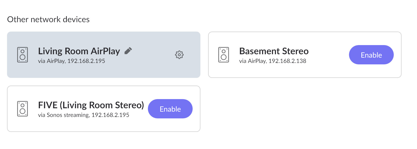

I am now using Airplay to my Sonos 5s and it seems much better. A search through this community resulted in other people have issues streaming via Sonos and suggested this.

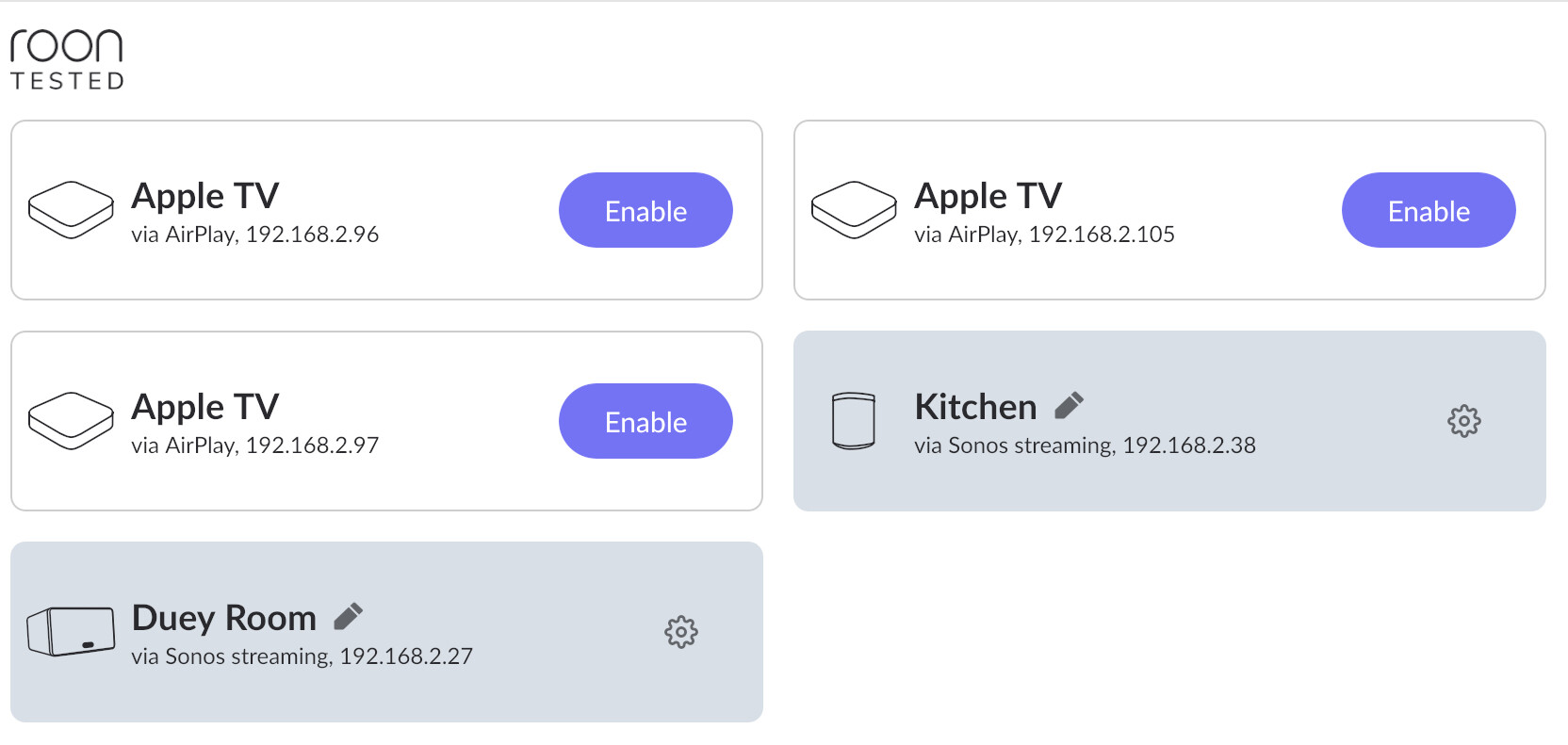

I also find it odd that my old Sonos gear shows up in Roon Tested and my new 5s show up in “Other network devices”. (FYI. The one called living room airplay is the 5s) What’s with that?
In any event, sonos and roon not liking each other unfortunately

Just a heads up that this is still happening. It just did actually. I looked at the playing now screen and it was on the next song - the one that was actually playing through the speakers was the previous song in the queue. If I pause the music, wait a bit and hit play, it will play the song that is actually on the playing now screen from where it shows it is at. So, it’s a communication thing - Roon playing now gets ahead of what is actually playing…
Hope that makes sense…
