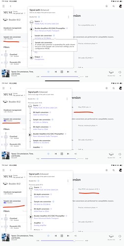

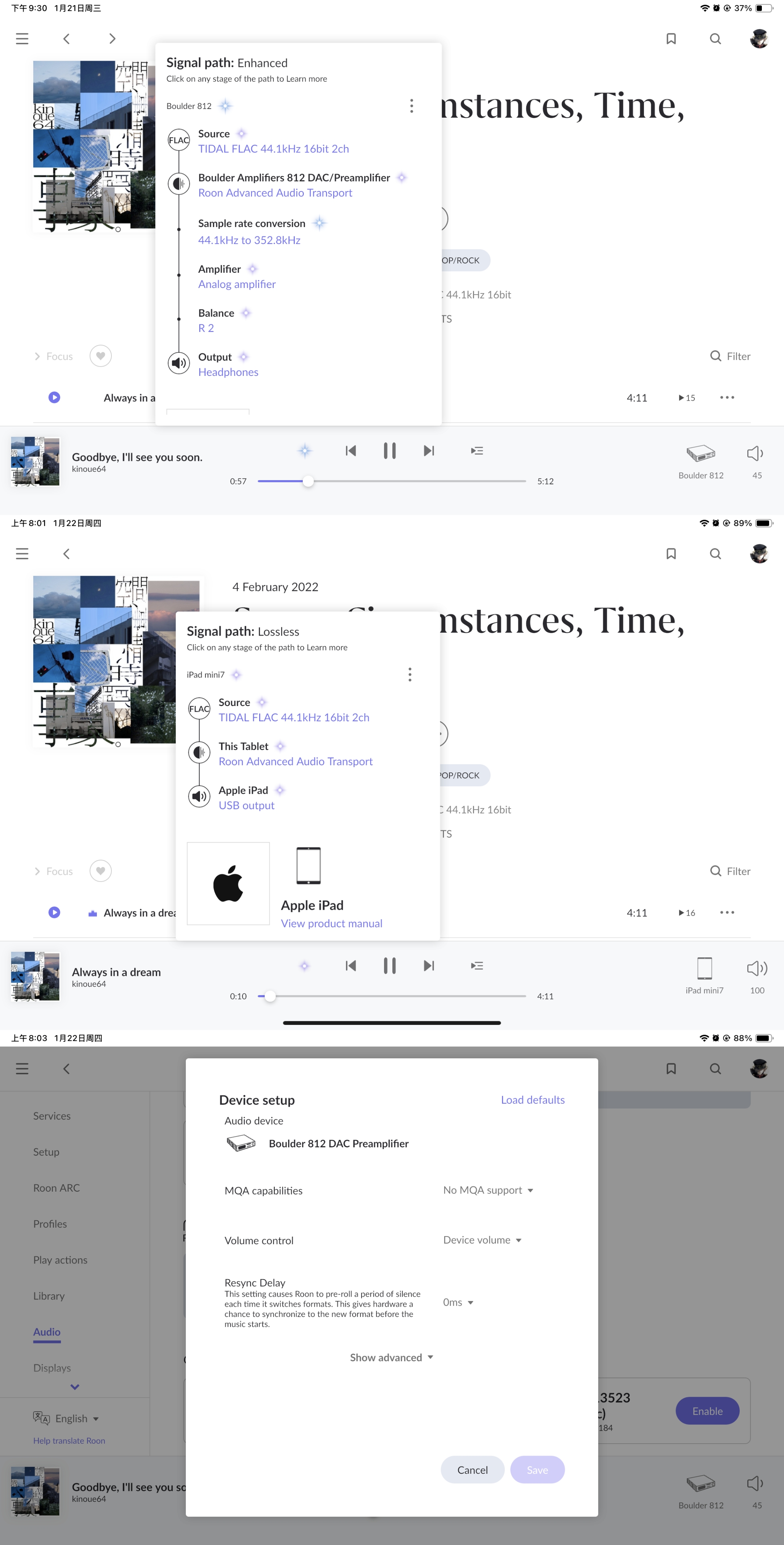

·My device is the Boulder 812, which has a built-in Roon ready function and also supports USB input. During use, I encountered a problem: if I use Roon to push the signal, it displays as "enhanced," but if I use an iPad mini connected via USB output, it displays as "lossless". There are relatively obvious differences in the sound of these two. My question is, I want Roon to push the 812 while maintaining the "lossless" signal without enhancement. Is this possible? If so, how do I adjust the settings? Regards for everyone

If you looked closely, you’d see that the Roon Ready Ethernet signal path tells the truth, in that the Boulder itself “enhances” the data by it’s internal upsampling after receiving an untouched bit perfect stream from Roon.
The USB signal path, on the other hand, just gets no information feedback about the Boulder’s up sampling, but it’s still happening in the background.

Thank you very much for your guidance. I think I understand your point: you mean that Roon simply reveals all of this.

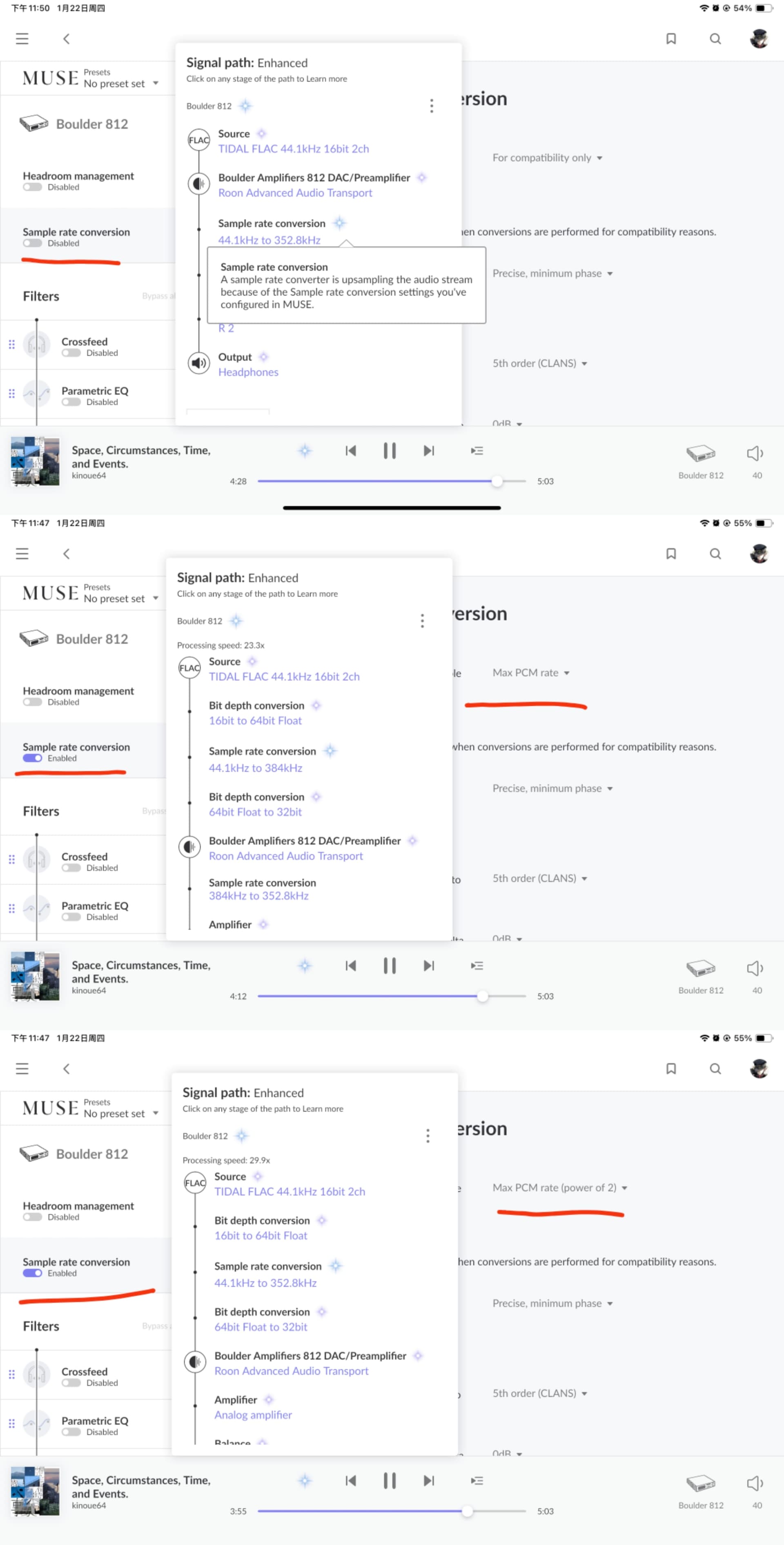

After making some settings on Muse, I found that it seems to be true. Boulder appears to automatically convert the frequency to 352.8 kHz. If it is already at that frequency, there will be no changes— the only difference is “who” does it.

Yes, and that is a big question. Imho, the correct answer is to let Roon upsample everything to 352.8 so that there are NO need to resample in the Boulder. To do that you need to set a custom rate in Muse, and not use “max power of 2” or “max”. Try that and see if there is a SQ difference.

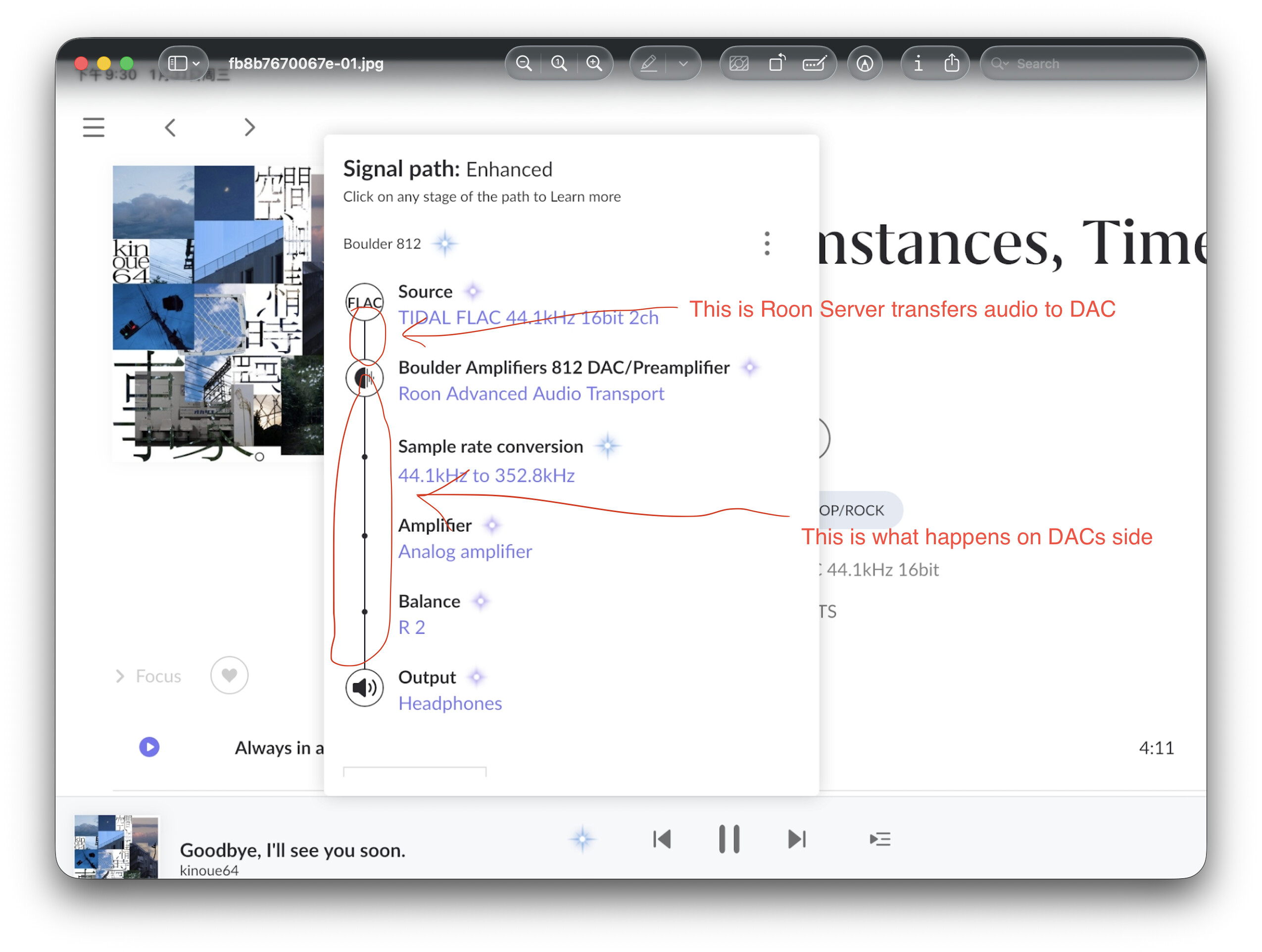

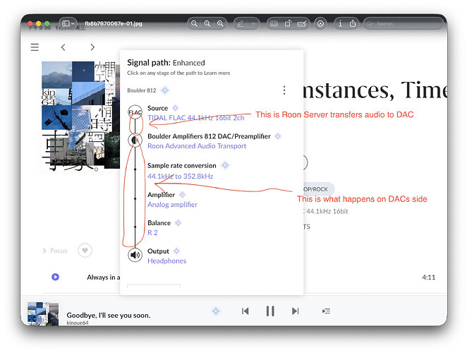

As @Marin_Weigel pointed that Signal processing happens on the side of DAC.
In order to change that you’d need to adjust the settings of your DAC.
Froom Roon’s side the signal goes bit perfect.
