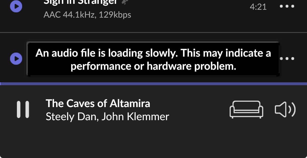

All of my zones are working correctly (bluOS devices) but when streaming to my C658 (NAD) Roon keeps skipping. This problem is on all media type (tidal, Qobuz or local). I run a Roon Core connected via Ether et to the ISP. All my other devices are connected via WiFi.
Roon Rock plugged on ethernet to ISP. Blusound Pulse on WiFi (2 zones) and C658 (WiFi) with BluOS paired with power amplifier.

We were able to review a recent diagnostic report form your Roon Server, and can see playback stopping due to too many repeated dropouts in playback:
Warn: [Worker (1)] [Living Room] [zoneplayer/raat] Too many dropouts (>3s dropped out in the last 30s). Killing stream
Warn: [Broker:Transport] [zone Living Room] Track Stopped Due to Slow Media
Are you able to temporarily setup a hardwire connection to one of your endpoints and test to see if the same issues persist?
