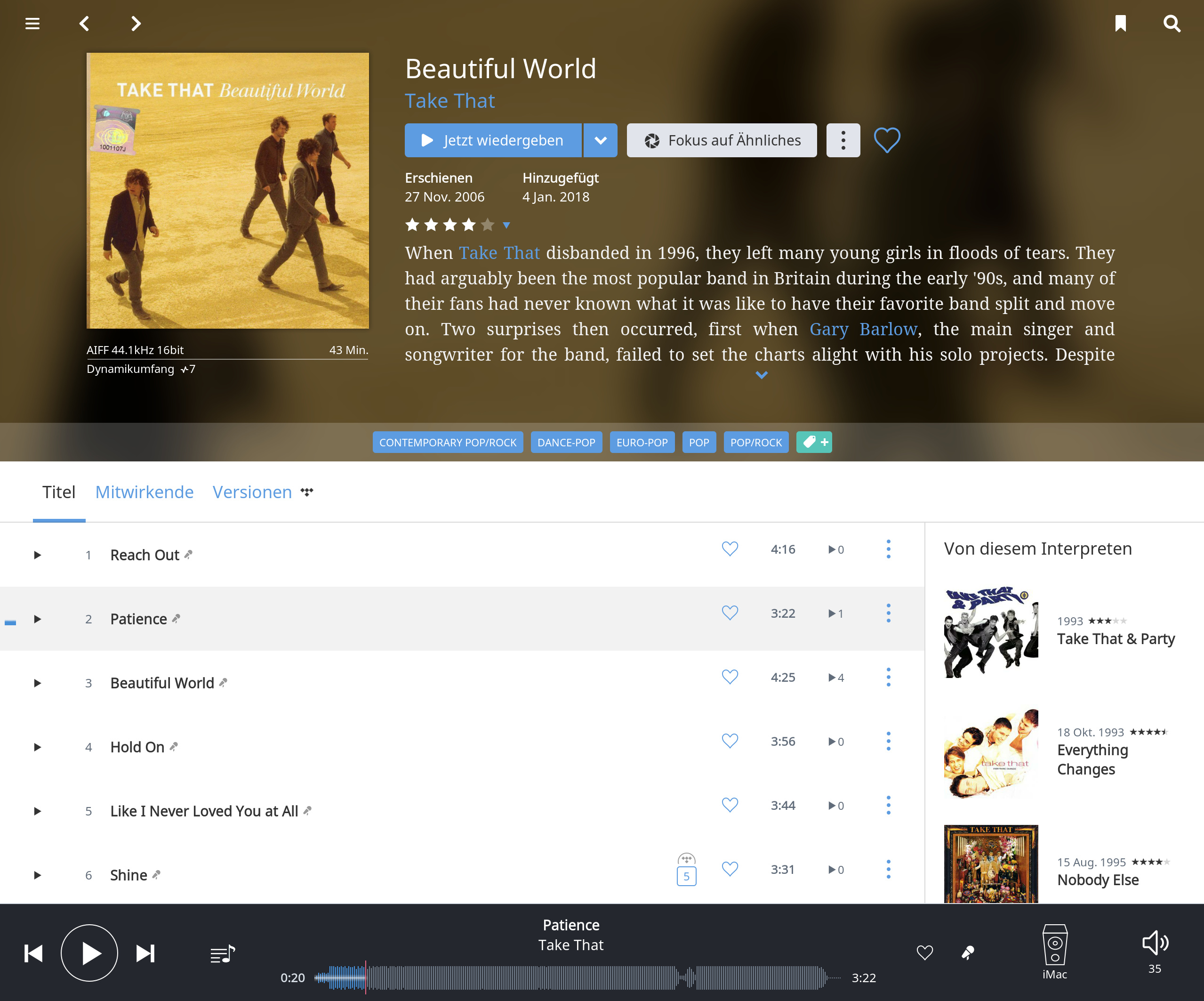

I have some tracks in my Roon library where Roon skips playing at specific positions in the track to the next one. One example is Patience by Take That. Here playing skips reproducible at 3:05.
The screenshot shows that the track was analyzed. I already tried to re-analyze and re-scan the album. That did not help. I have a handful of other tracks in my library which show the same issue.
