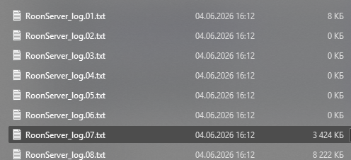

Hello @Matt_Hunt
For some reason, your logs are empty for that specific timeframe.
Please reproduce the issue again and provide us with the timestamp
