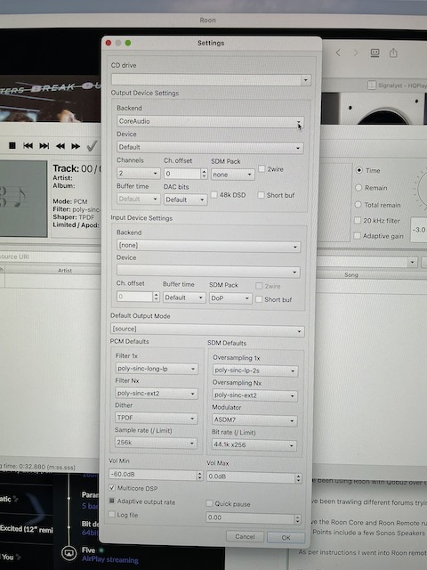

I have opened the Settings in the HQ Player as shown : Photo 4
The only way I can get any sound is with the settings as shown coming out of my iMac.
In the Output backend settings Core Audio, neither of the network settings do anything.
How do I set this up so the HQ Player is there in the audio path just before the end point.

  • Usually the Backend on hqplayer is set to NetworkAudioAdapter (NAA).
  • The device section would list the DAC connected to the NAA.
There is a short list of DAC’s that have NAA built into them or that you can use as an NAA on the signalyst.com webpage. Most use a Raspberry Pi (good luck finding a Pi right now). You can download the NAA software from the signalyst NAA section, put it on an SD card using balenaEtcher, and boot the Pi from it. Then plug your USB dac into the Pi.
  • If your DAC only supports DSD64 over DoP you need to select DoP under SDM Pack. Otherwise leave it to none.
  • The Default Output Mode is set to your desired output stream, usually PCM or SDM(DSD).
  • Filters and dithers in PCM and Oversampling and Modulator in SDM are personal preference. Jussi’s defaults are a good place to start.
  • The SamplingRate and the BitRate should be set to the max your DAC will accept.
I’m sure others will chime in, I may have left something out…
