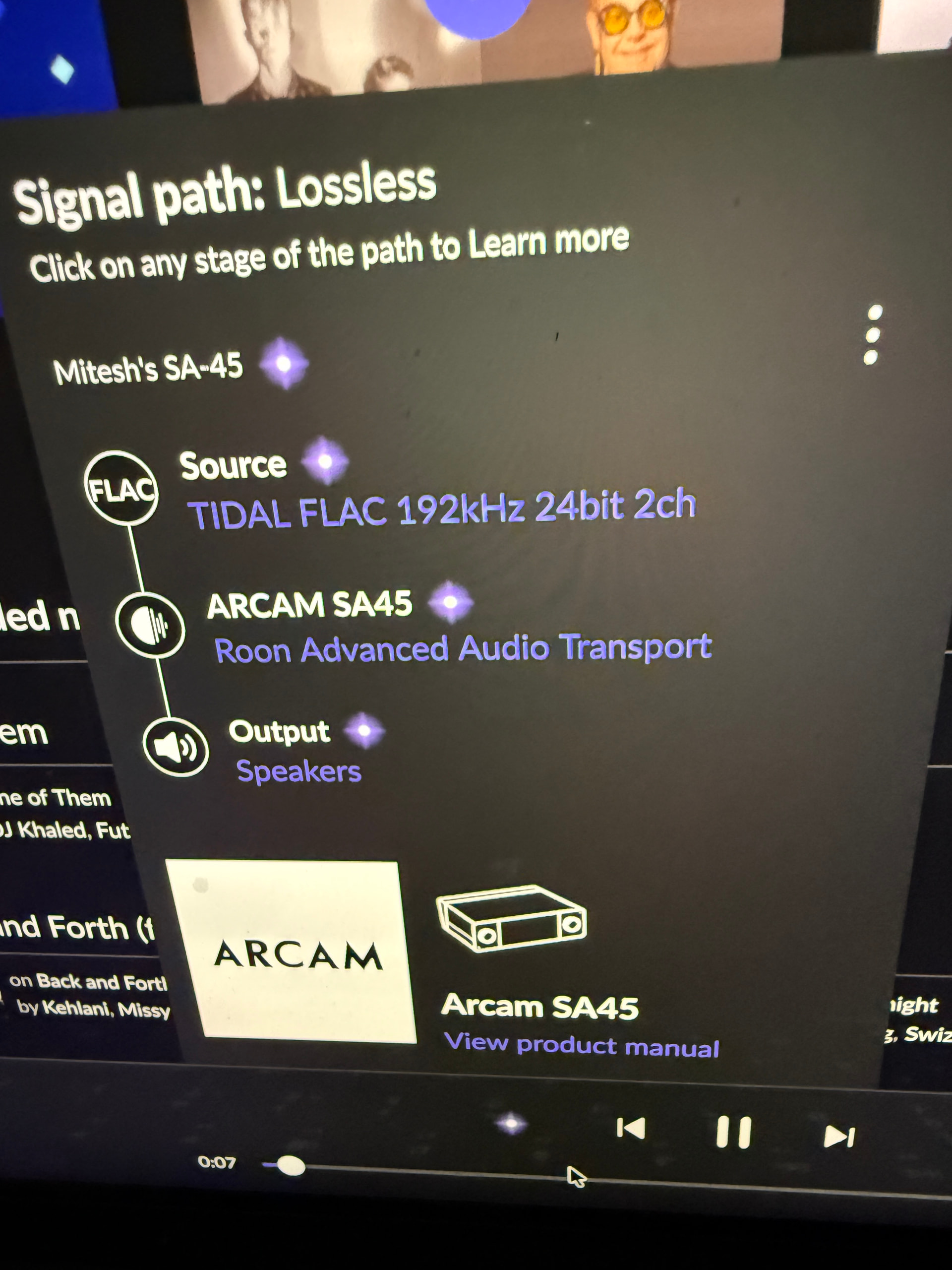

Hi…..Roon server on macOS Tahoe displays 24 bit 192khz audio file whilst on Arcam Radia SA45 metadata shows the file is MP3 @ 128kbps
Somewhere the audio file is downsized to an MP3……. I have the MacBook connected to my router via Ethernet as is my SA45 …..
Can anyone help?
The signal path should show what’s going on. Can you post a screenshot?

Signal path looks fine. I’d suspect the SA45 is confused. Does it show the ‘wrong’ signal data for all tracks?
