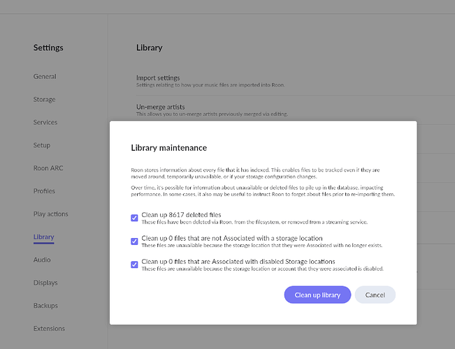

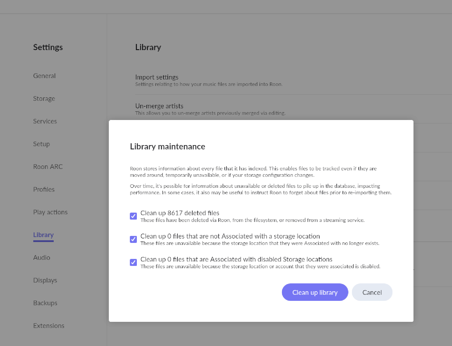

Just for reference, Roon retains database entries even after files are deleted or albums/tracks are removed from streaming services. That can lead to a new import being matched back to an existing entry. To start truly fresh, you have to use Settings > Library > Library maintenance > Clean up library.
AJ
Ok, interesting, thanks. Did that, and there seems to have been 8617 deleted files. Quite a bit, so I did that.

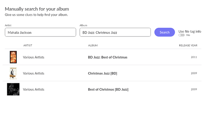

That’s a bit my suspicion too, though I haven’t confirmed it yet. There are some listings for this album, but I haven’t found a tracklist that differs. But indeed, ROON has identified the album… just not that one track, so that could be an explanation.
The rogue tag is probably in Tivo or MuscBrainz not necessarily in your tags
Okay, okay, I got it! The album is now “correct”

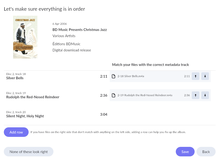

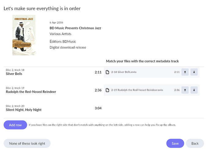

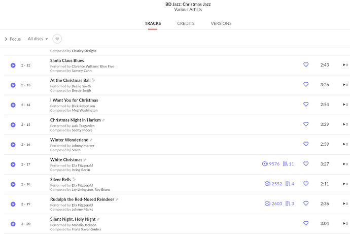

This BD Jazz Christmas album is just fascinating. ROON recognizes ALL the tracks are from the same album:

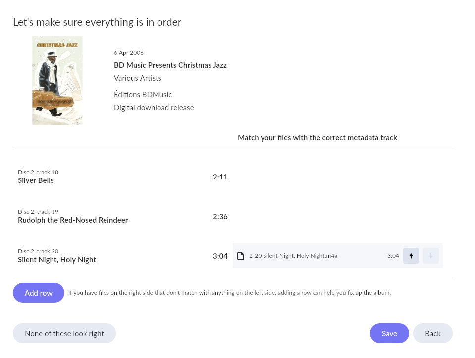

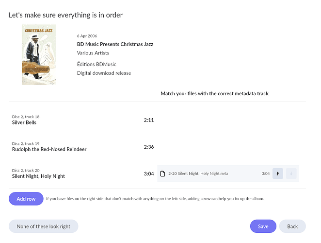

Just all the tracks but one in one album, and that one track and none of the others in another album:
But even now, where all the tracks are clearly identified, and identify the same album,
I still have two albums, one with all tracks and one with just the Mahalia Jackson track.

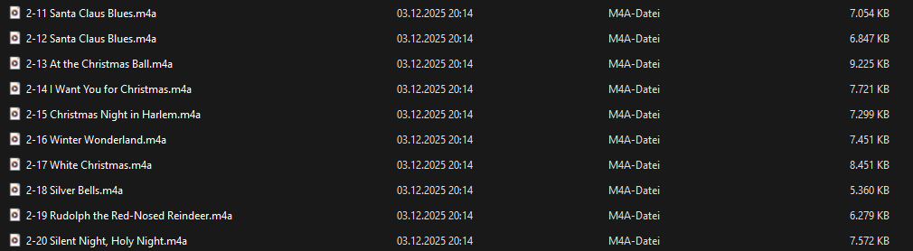

As you can see, that one track is rogue. The albums are correctly identified, the tracks are correctly identified, they come from the same source (Qobuz), are tagged in an identical manner and are all in the same folder:

Now what I did next: I removed the folder with the album from Roon, I deleted the album from Roon, I cleaned up the library in Roon, I double checked this album was really, really gone, then I re-inserted the folder. The exact same files. And voila,
This time everything displays correctly. So AJ’s tip with the “Library Maintenance” really helped. Maybe I did not do it thoroughly enough the first time. There must have been something very deep inside ROON that “remembered” these as two different albums, and continued to present them as such, and only after I completely removed the album and re-inserted (the exact same files), ROON re-read the album and put everything in place.
