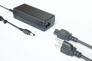

It’s a Nucleus One. The power led does not light.
Power supply is working at 19v.
Hello @boydgold
A reading of 19V tells us the supply produces voltage with nothing drawing from it. It does not tell us whether it holds up under load. A partly failed supply will often measure correctly on the bench and then collapse the moment the unit tries to draw current, and no power LED at all fits that.
So the next step is a different supply. Please try one that matches the rating printed on the label of your existing supply, both voltage and amperage, with the same connector and polarity. If you do not have one on hand, we sell them here:
If a known good supply brings the unit up, that was the fault, and you are done.
If the power LED still does not light with a different supply, the fault is in the unit itself. Please open the form below, choose “Other”, then “This issue is related to a physical component”, and our hardware team will take it from there:
