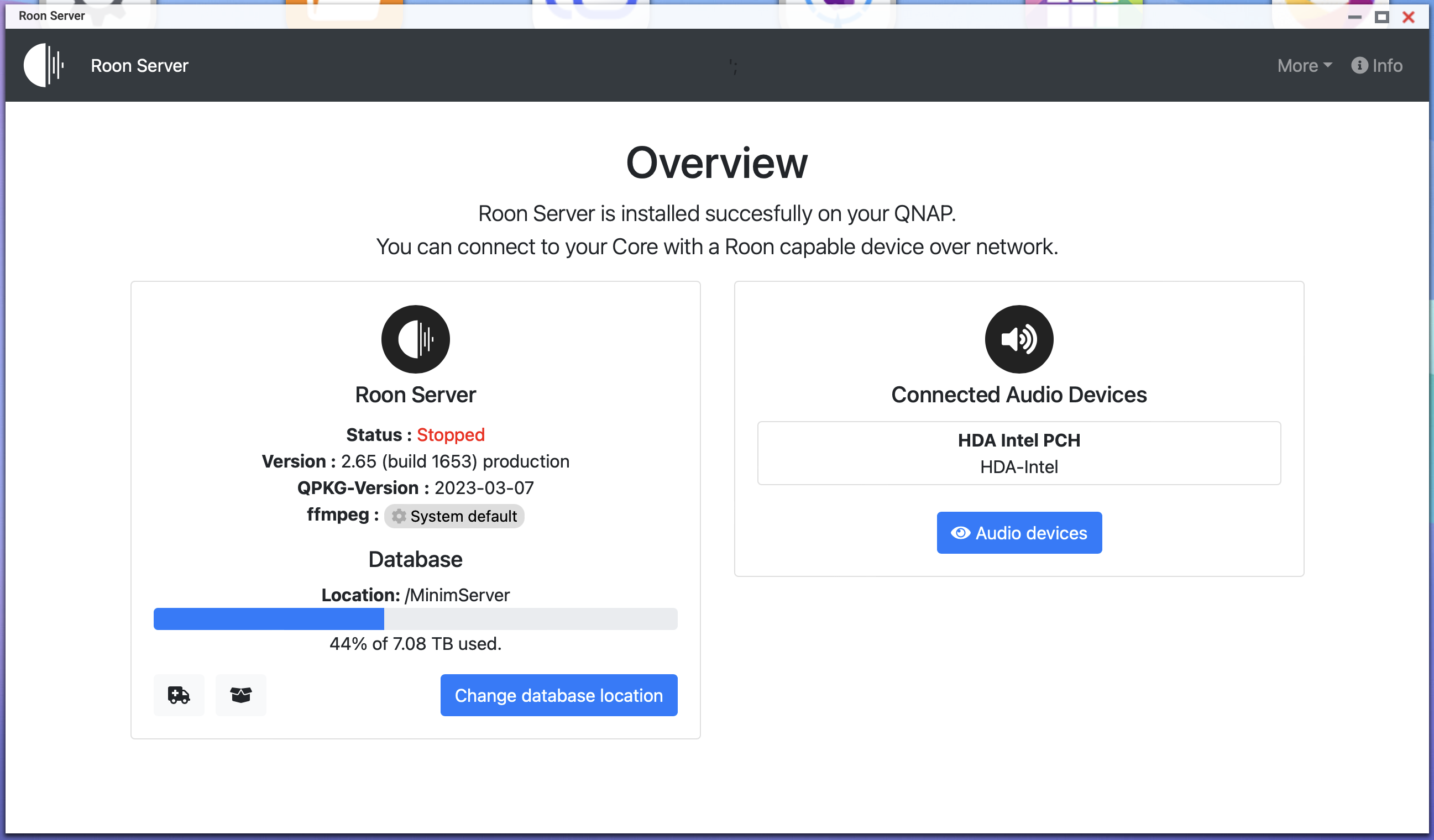

Qnap shows Roon as "stopped". I tried to complete the Docker Container Station fix but still no go. I have all the other threads and performed as much as I could. Now my streamer won't connect either.

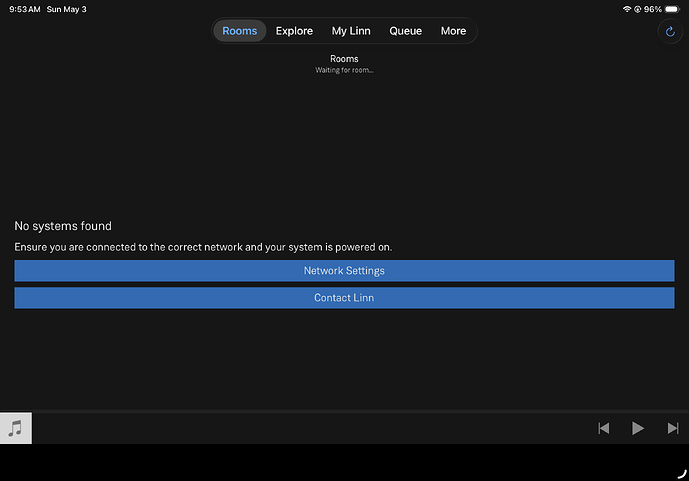

Well, before the “Container Station” fix attempt. I was at least able to connect my streamer to the internet and play music using the Tunein app via Linn server. Now it won’t even connect and find my streamer.
Maybe try and restart all involved components, including your network components and your streamer. Roon does not have anything to do with your Linn software so maybe click on “Contact Linn” there if you still can’t use it afterwards.
I tried that. Turned Off and Unplugged for 5 minutes the restarted. No go.

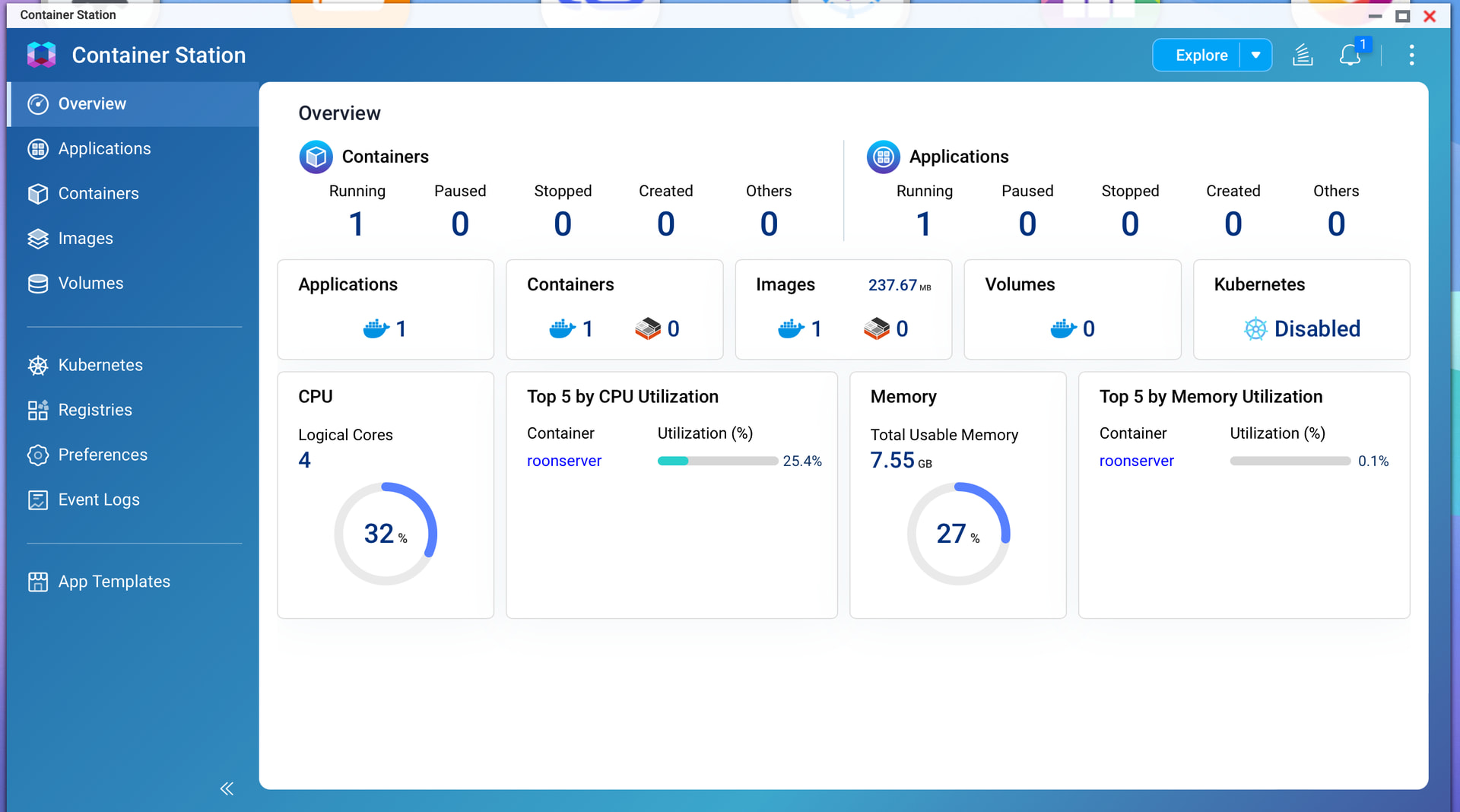

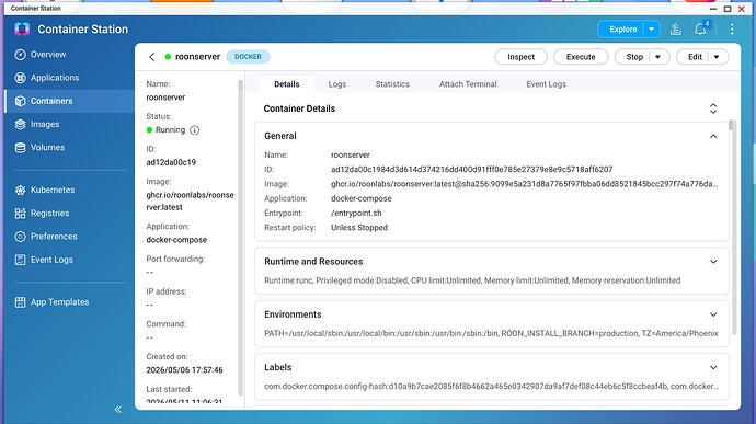

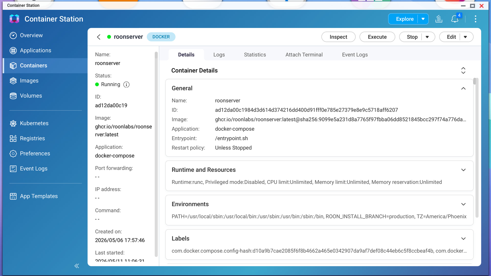

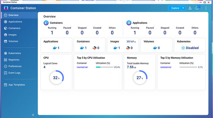

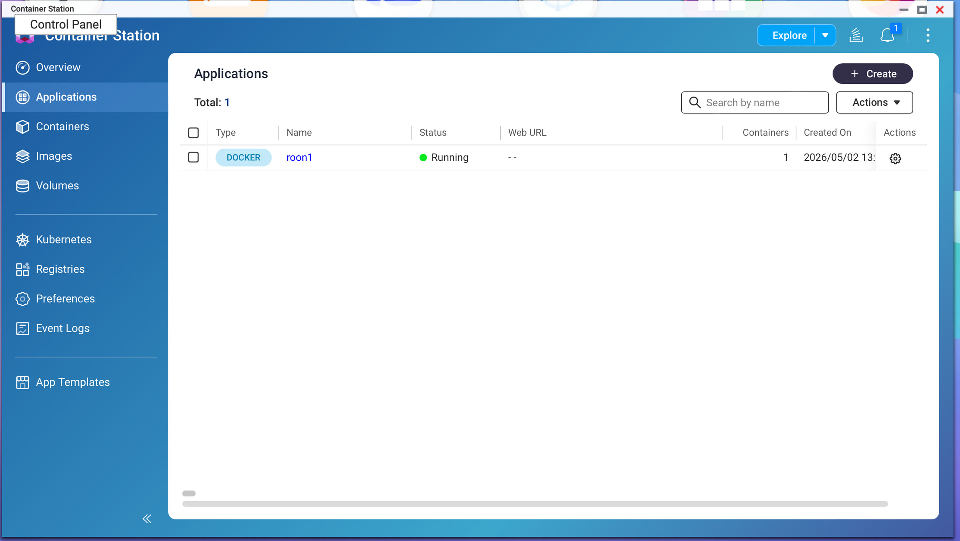

Do my screen shots look like I completed the Container Station fix correctly?
The Docker Application roon1 is status green, running. So we have to assume that a Roon Server instance is running inside. Roon Support may be able to provide further troubleshooting help if needed, their office days are Monday to Friday and there is currently a lot on their plate.

  • Disable the Deprecated App: Go to the QNAP App Center and manually Stop or Disable the old, native Roon Server application. Leaving both running simultaneously can cause network conflicts and prevent your streamer from identifying the correct core.

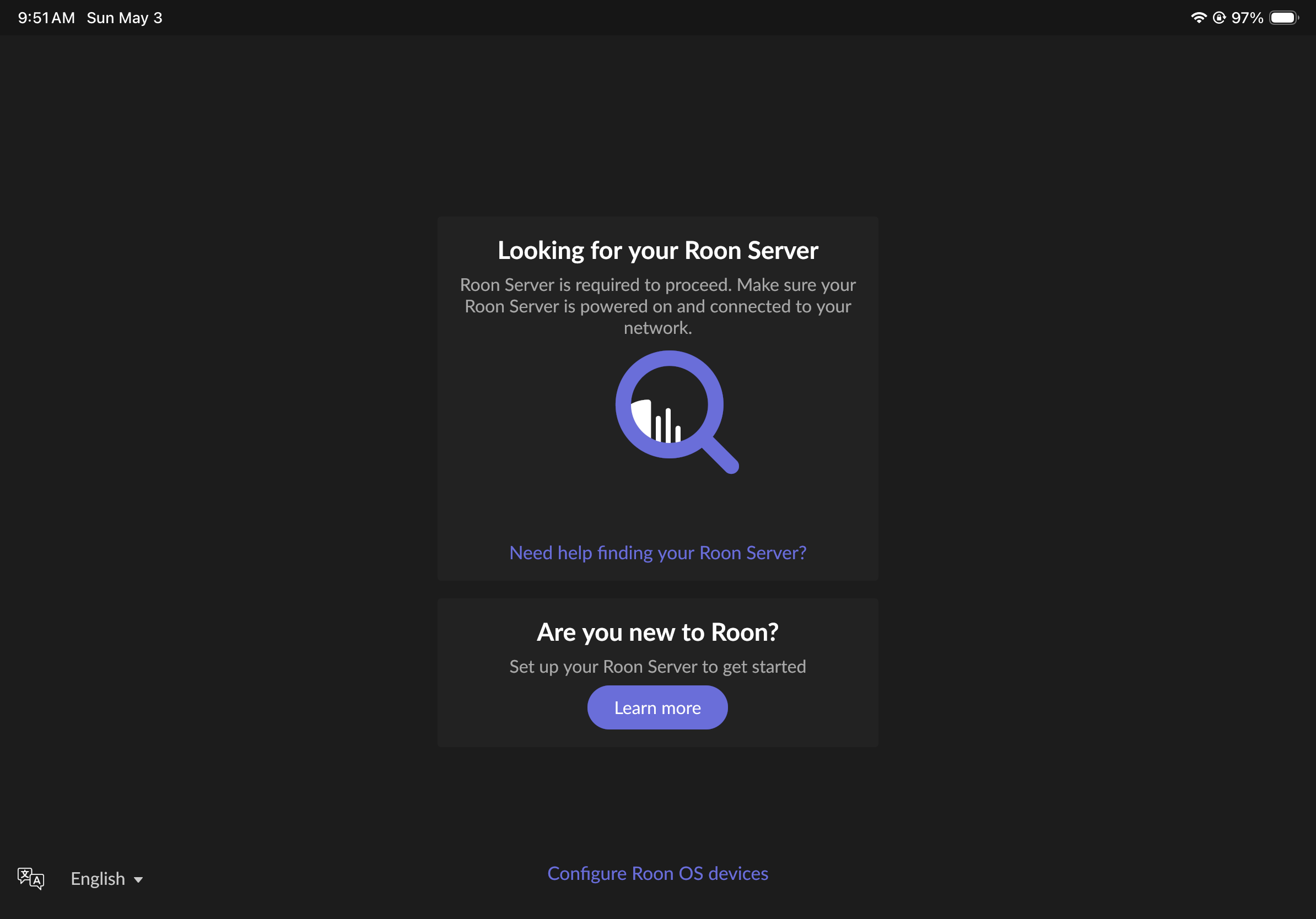

  1. No, I get same screen from iPad and iPhone. “Looking for Rood server” and are you new to Roon.
  2. I deleted the old Roon application on the Qnap in the app section.
  3. I tried the “ned help finding the Roon server” then input the up address for my NAS 192.168.40.110 but then it just goes back to the “ looking for your Roon server and Are you new to Roon?” screen.

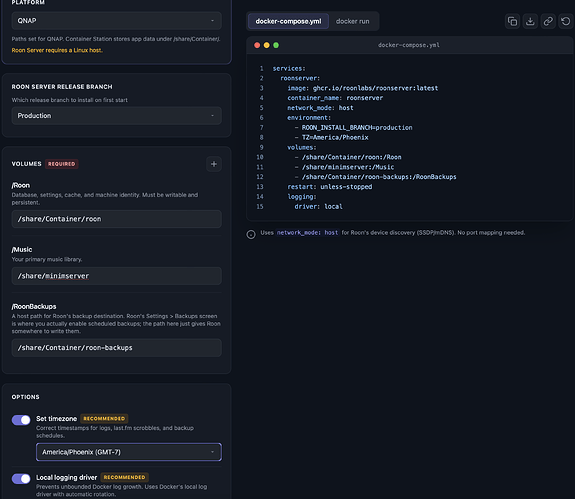

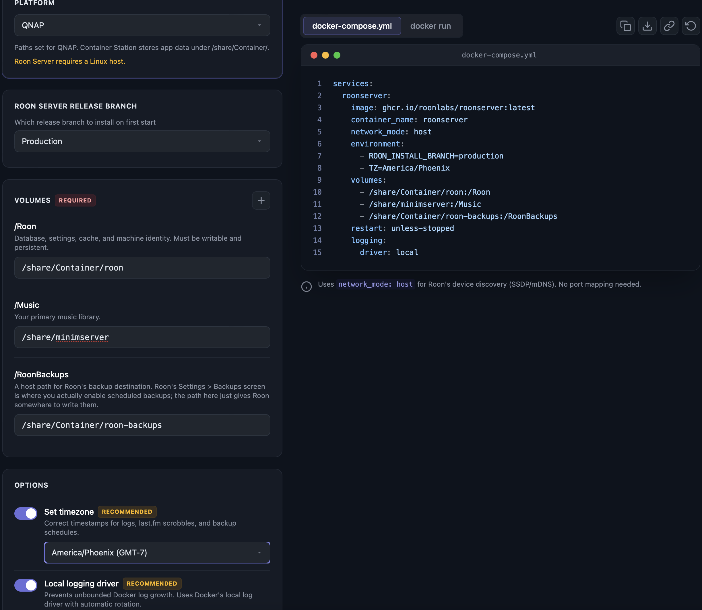

3. Verify your YAML Configuration Network discovery heavily relies on the container being configured correctly. Could you please confirm if the YAML code you used during the setup exactly matches the structure shown in the screenshot above?
It is absolutely critical that the line network_mode: host is included and formatted correctly. Without this specific setting, the Docker container remains isolated, and neither your Linn streamer nor your mobile devices will be able to find Roon.

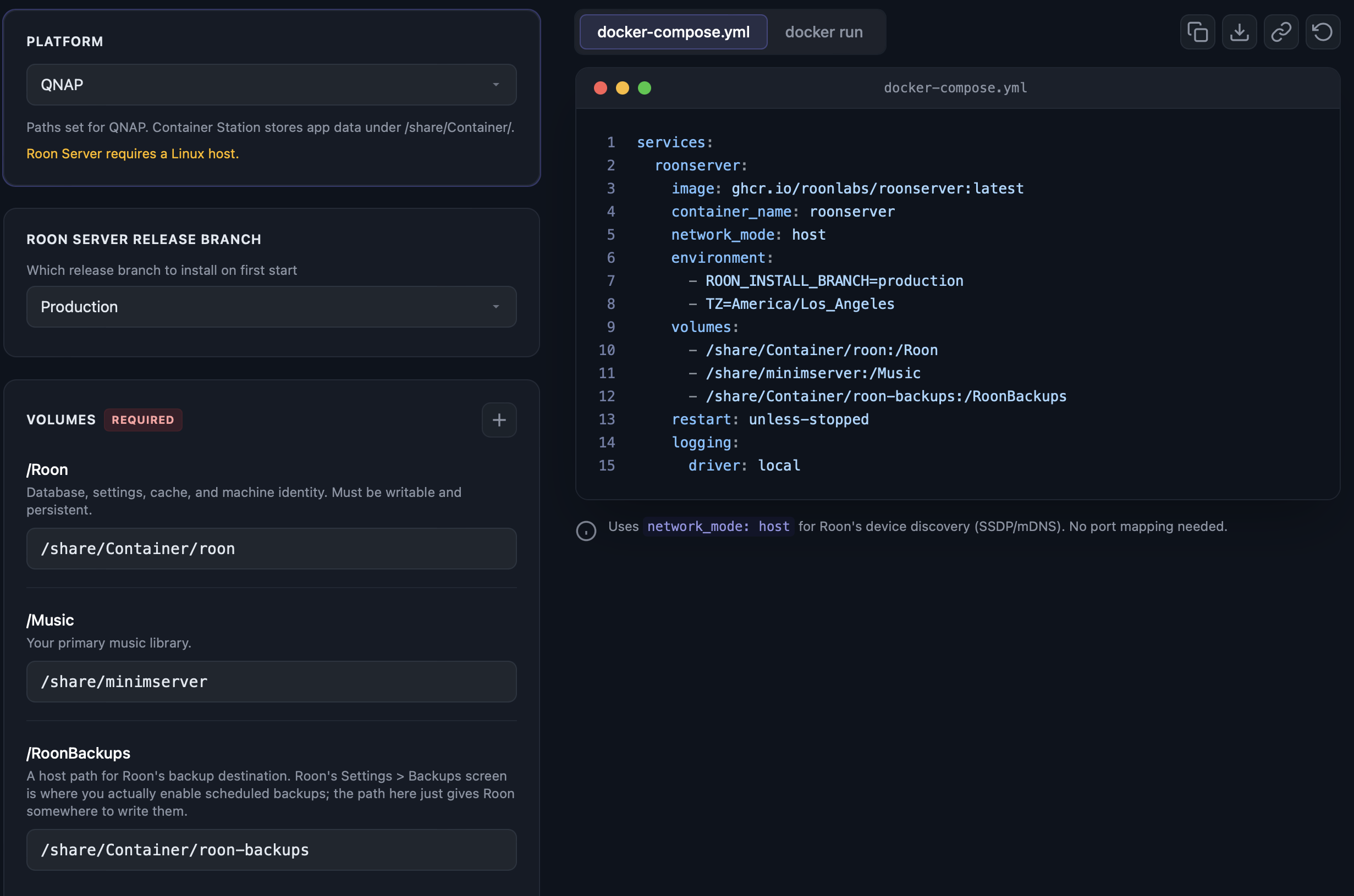

  3. I deleted the original Roon container and made a fresh one. Still not finding server. Below is my new YAML and what I continue to see when trying to connect to the server.
Hey @John_Berry,
Thanks for the update! Looking at your screenshot, the YAML config looks correct — network_mode: host is there, volumes are mapped properly. The container is running but Roon clients still can’t discover it. Here are the next logical troubleshooting steps to try:
