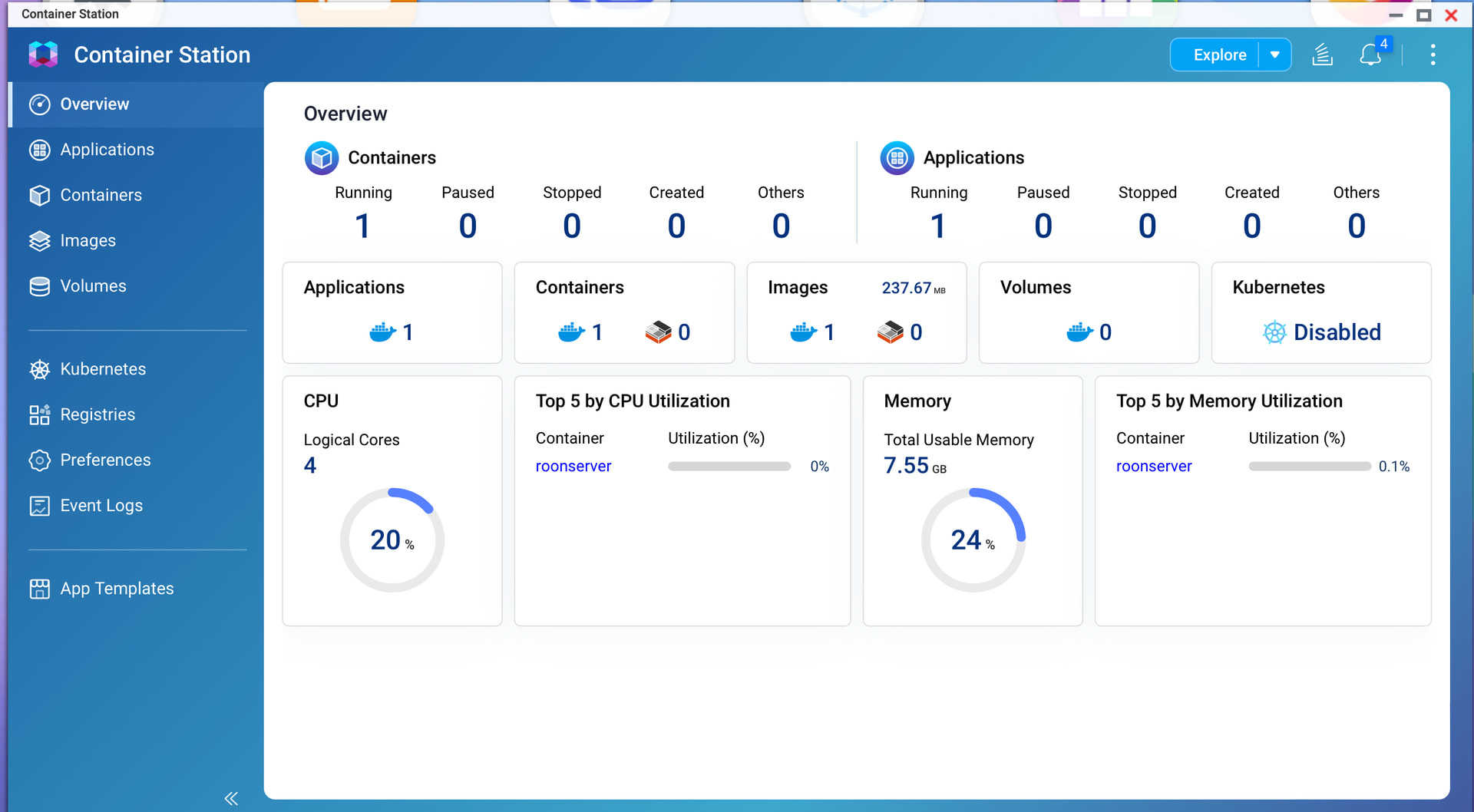

Looking at the screenshot you shared above, the QNAP docker instance doesn’t appear to have an IP address.

What do you see when you open Roon on another remote in this same environment, like a phone?

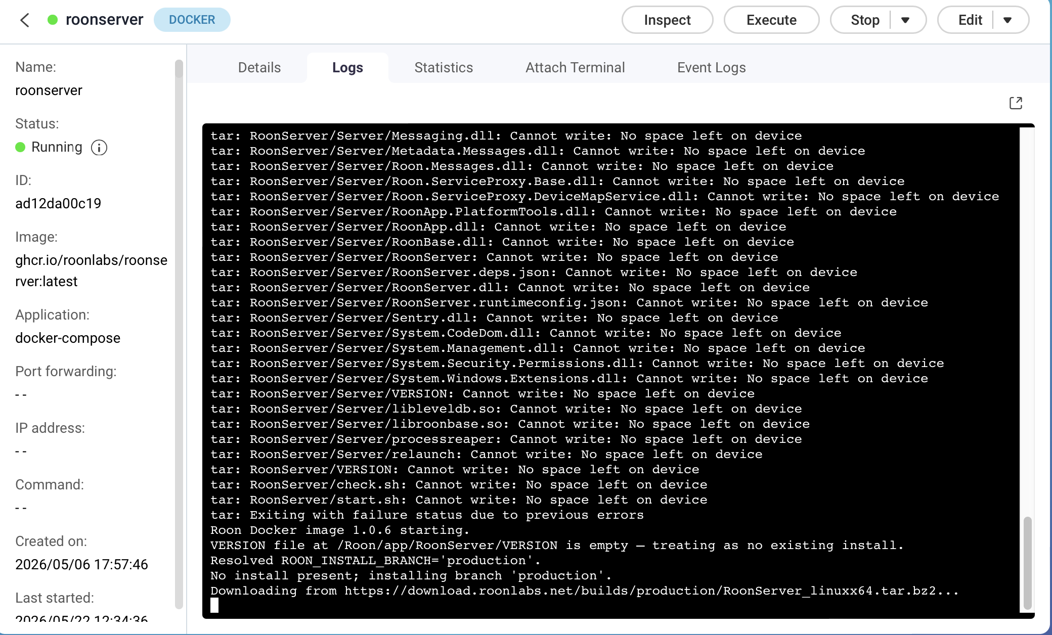

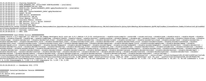

When you open the Container hosting roonserver in the QNAP Container Station interface, what do you see under the “logs” tab?
Please share a screenshot here.

I see this on iPad and iPhone when trying to access Roon.
Logs tab

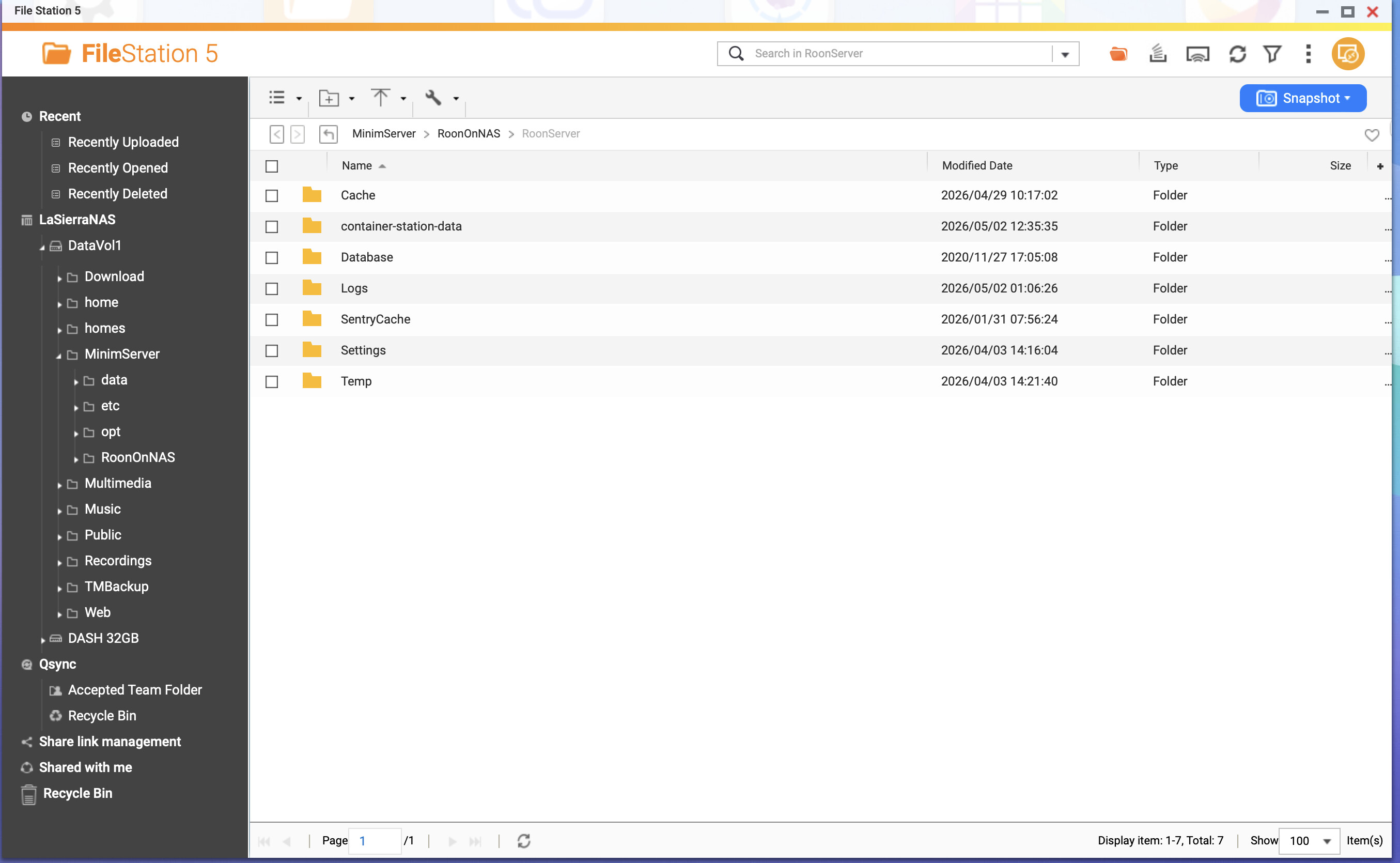

I do not see the /share/container/roon file in file station. See below.

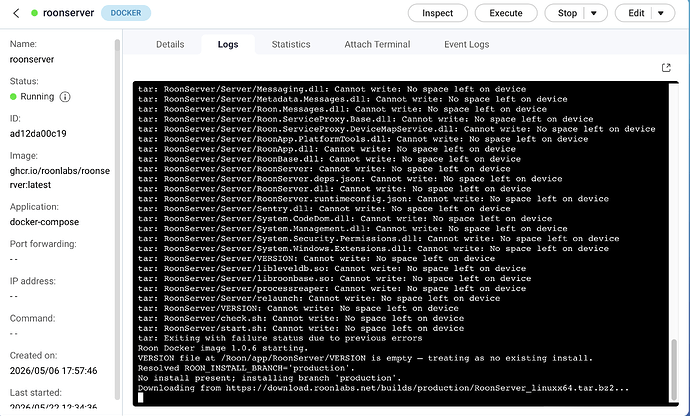

However, when opening Container Station and the docker - RoonServer, I do see the logs flash by fast and do see “Cannot Write No space left on Device”
Hi @John_Berry,
Thanks for taking the time to check. This confirms that the file location hosting the Docker doesn’t actually have sufficient room for Roon Server to install and run. Roon can’t write to its database, which is why it’s not coming up properly.

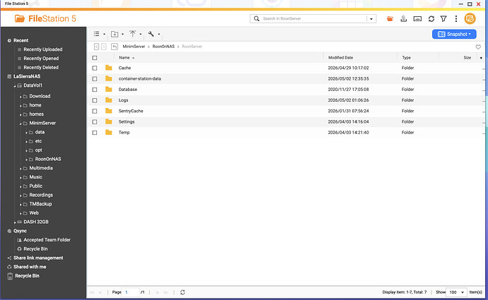

I assume you have used the default share paths in docker generator as seen in your screenshot in post 22days ago? If not, feel free to share screenshot. You might also want to take a look at the volume where /Container folder is mounted. You find this in general preferences > Shared Folders in QNAP QTS desktop, or by opening the volumes in File Stations. Is it the case this lives under DASH 32GB volume?
32GB is insufficient for hosting Container Station data, roon server application, roon database plus all backups. You need a bigger SSD volume for this purpose. Is /DataVol1, where your music is stored, a magnetic, spinning-disc volume? It looks like Container Station has written something in the folder /MinimServer folder which you have pointed at to share your music files.

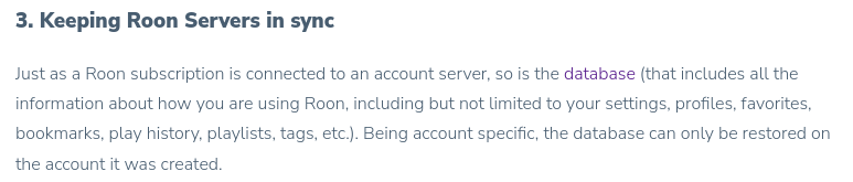

That is useless at best and may cause issues at worst. There is nothing to restore from a backup from another account (the DB is account bound). See also:
