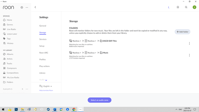

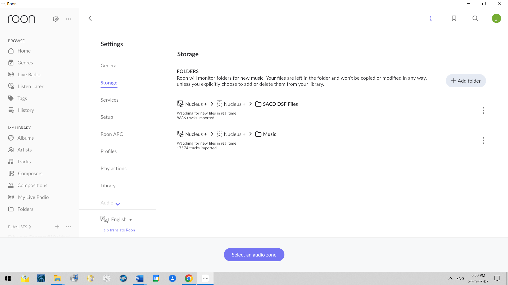

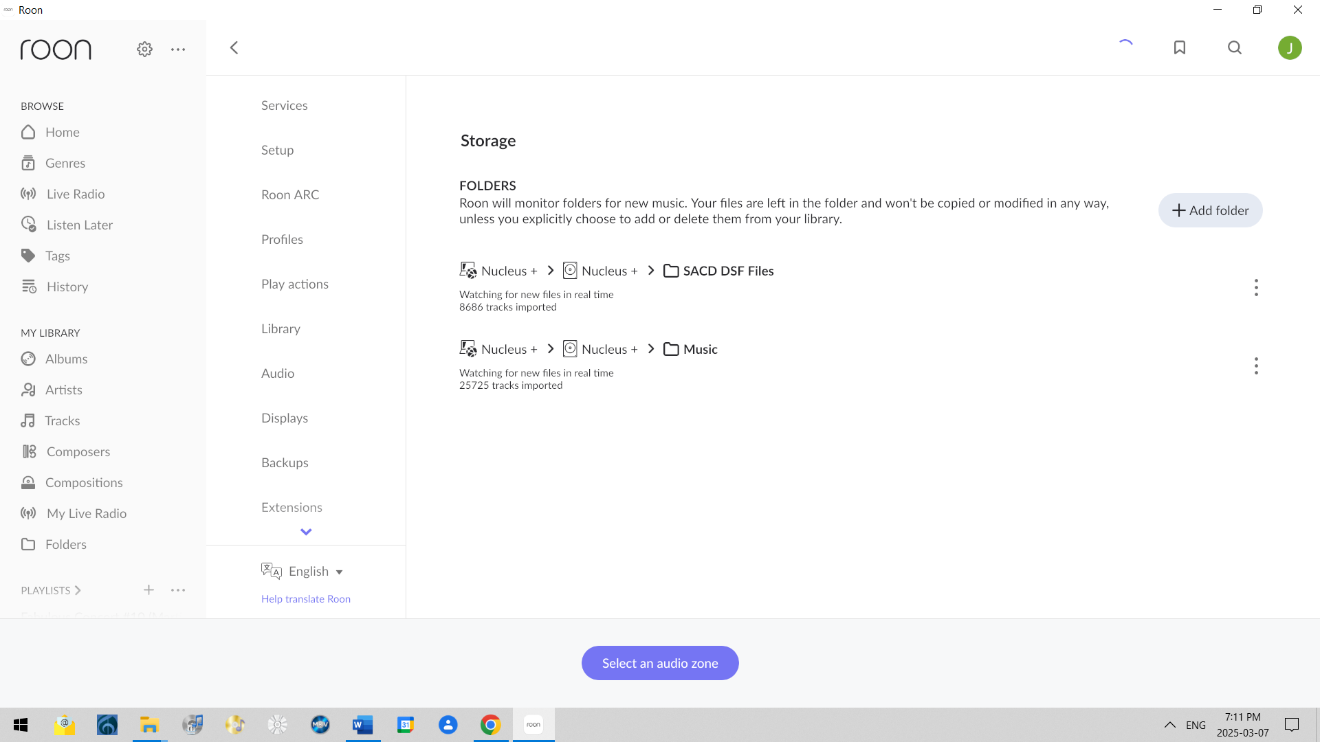

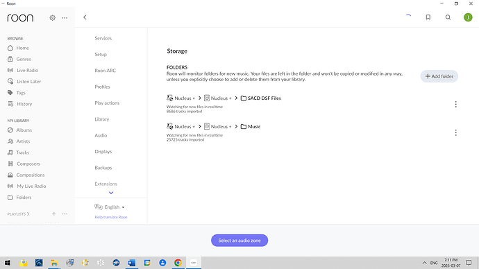

We’ll need just a few more details here to completely diagnose this problem. Can you share a screenshot of your Watched Folders?
An important point: if you’re relying on files hosted on the Windows machine as a network share location for Backups, metadata, or Roon files, you’ll need to ensure that the migration hasn’t changed any of the access permissions:

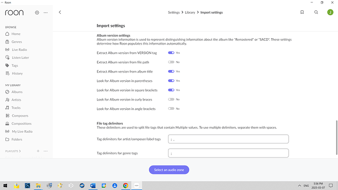

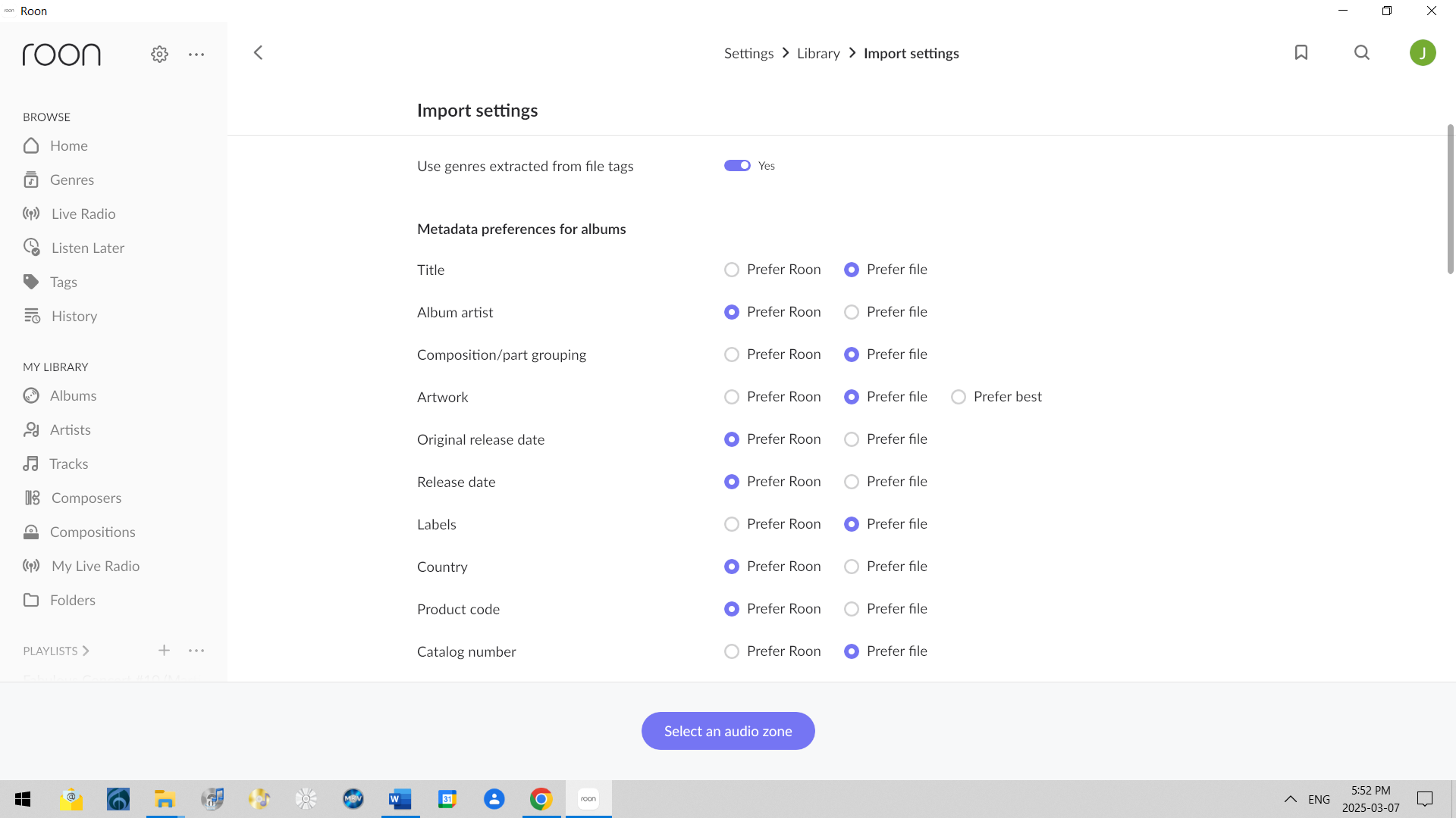

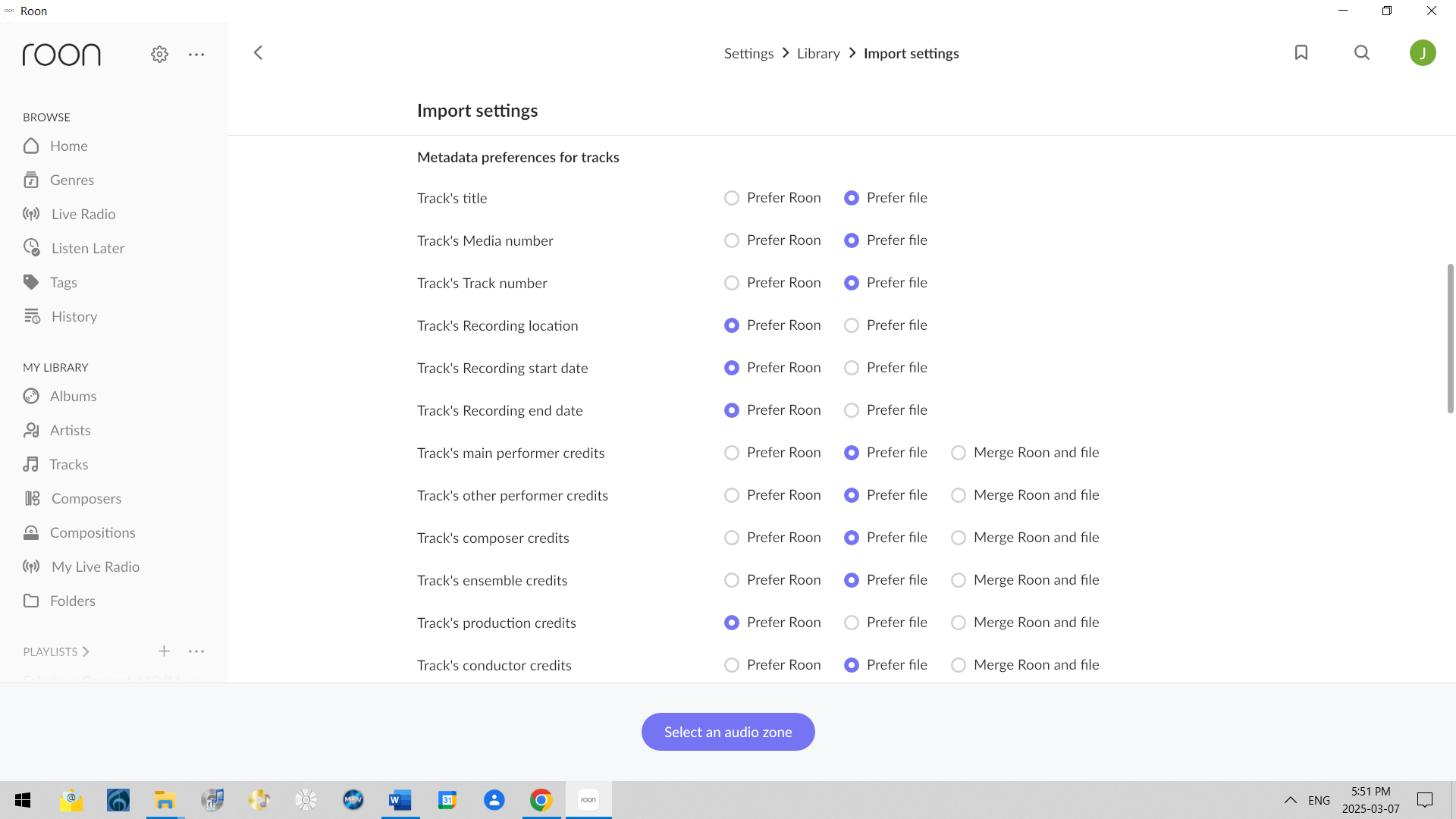

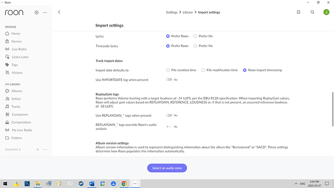

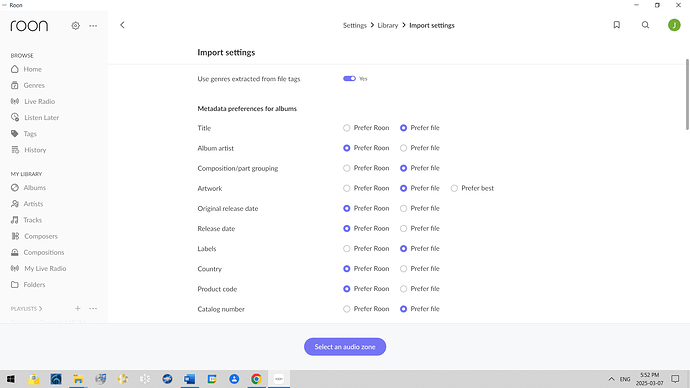

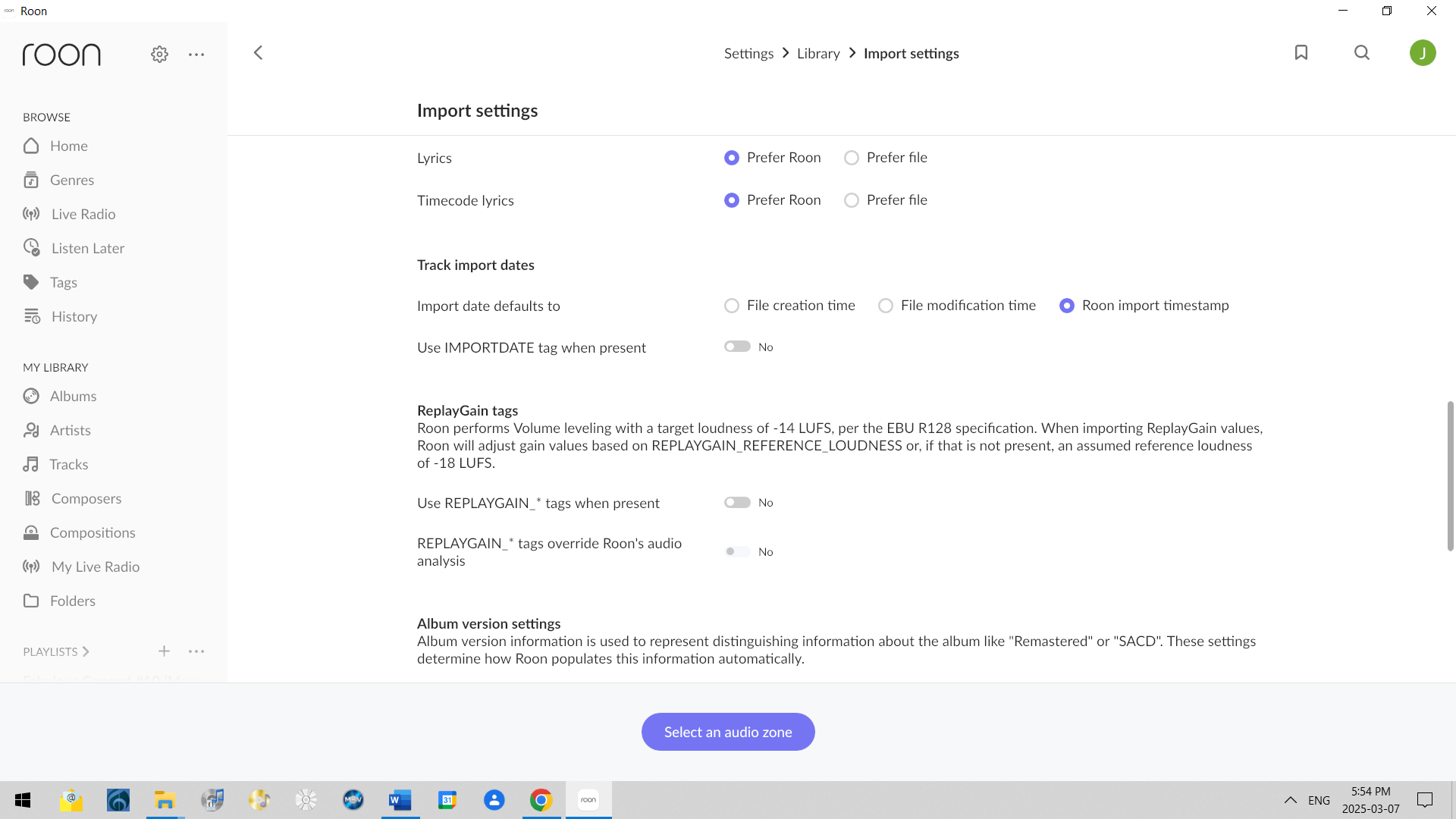

In your Import Settings, have you set your metadata preferences to “Prefer Files” or “Prefer Roon?” Sharing a screenshot of Settings → Library → Import Settings would be ideal.
Hello Connor,
Attached are several screenshots of the import settings and the watched folders.
My media files are attached to port 1 on the Titan so networking shouldn’t be an issue.
I am sure I created network shares for the metadata files when I migrated from the Nucleus +. I did recreate them just now to be sure and the various backups that I had saved were there. Besides, I backup my media files attached to the Titan (Q: drive) to an external drive on my desktop (X: drive) via network sharing so network sharing shouldn’t be a problem.
